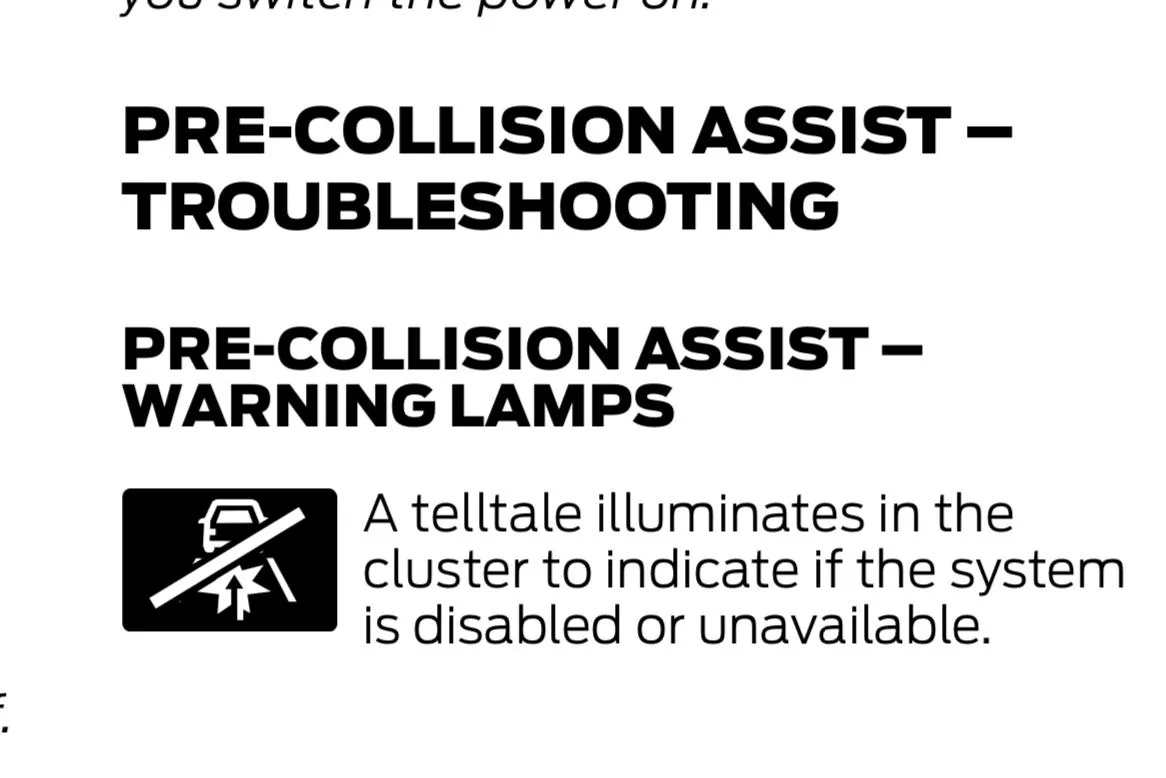

Need help identifying this warning icon that popped up on my dash several times several weeks ago.
Lightning Rod
Nov 27, 2022
822
656
North Coast
2023 Ford Lightning Lariat ER
CNC PROGRAMMER/MACHINIST
I briefly looked through the manual but didn't see this particular icon. This showed up while driving about 43 mph on a street with stop and go traffic every mile or so. It stayed on for 5 minutes then went off. Several minutes later, it popped up again. Weather and road conditions were dry and about 80 degrees F. I didn't see it again until about a week later and I haven't seen it since.
Does anyone know what this is?
Thanks.

only had my Lightning for a few weeks so I've spent a lot of time looking at both the online and printed owners manual (my bathroom reader!) I couldn't find this anywhere. it looks like a warning from teh collision or braking assist telling you not to back up. doesn't make any since as you were driving forward. good luck.

Funny I got this just yesterday morning! I was driving into heavy glare from the sun rise so I figured that was messing with the front sensors. Every time there was a shadow or I turned away from the glare it seemed to go away.

Here it is
You will get it usually driving into the sun in the morning/evening especially with a buggy windshield. Basically, the camera can't see the road. (It's usually about the same time I can barely see the road)

I got it again driving through rain changing over to snow this afternoon. I was unable to use my cruise control also. About 5 minutes later, it was gone and my cruise worked fine again. All of these sensors and cameras are very touchy and easily breached from snow... at least on my truck. :unsure:
