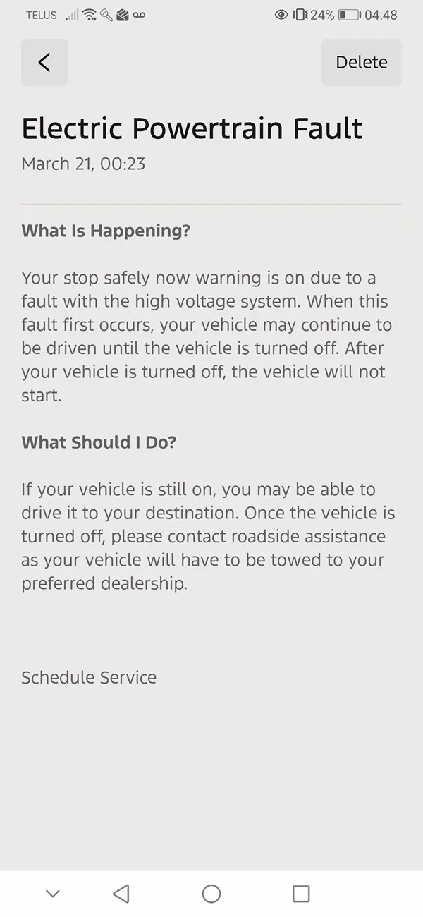

Here's the kicker, don't shut it off until you get the fordpass:
Ford F-150 Lightning Compressor Assembly Failure on '22 Platnium Screenshot_20260330_044832_com.ford.fordpass
