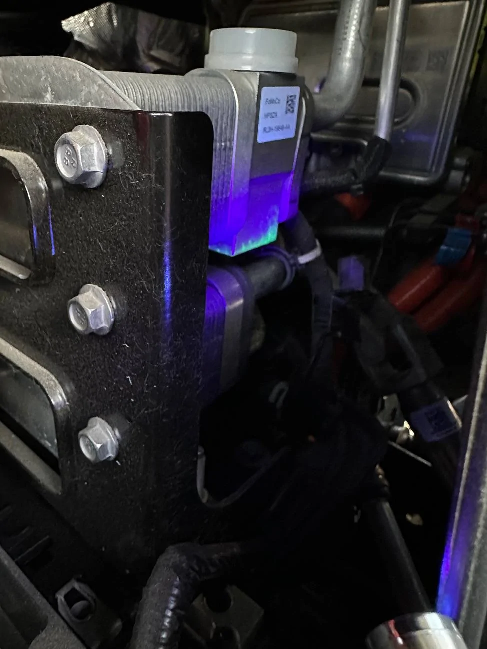

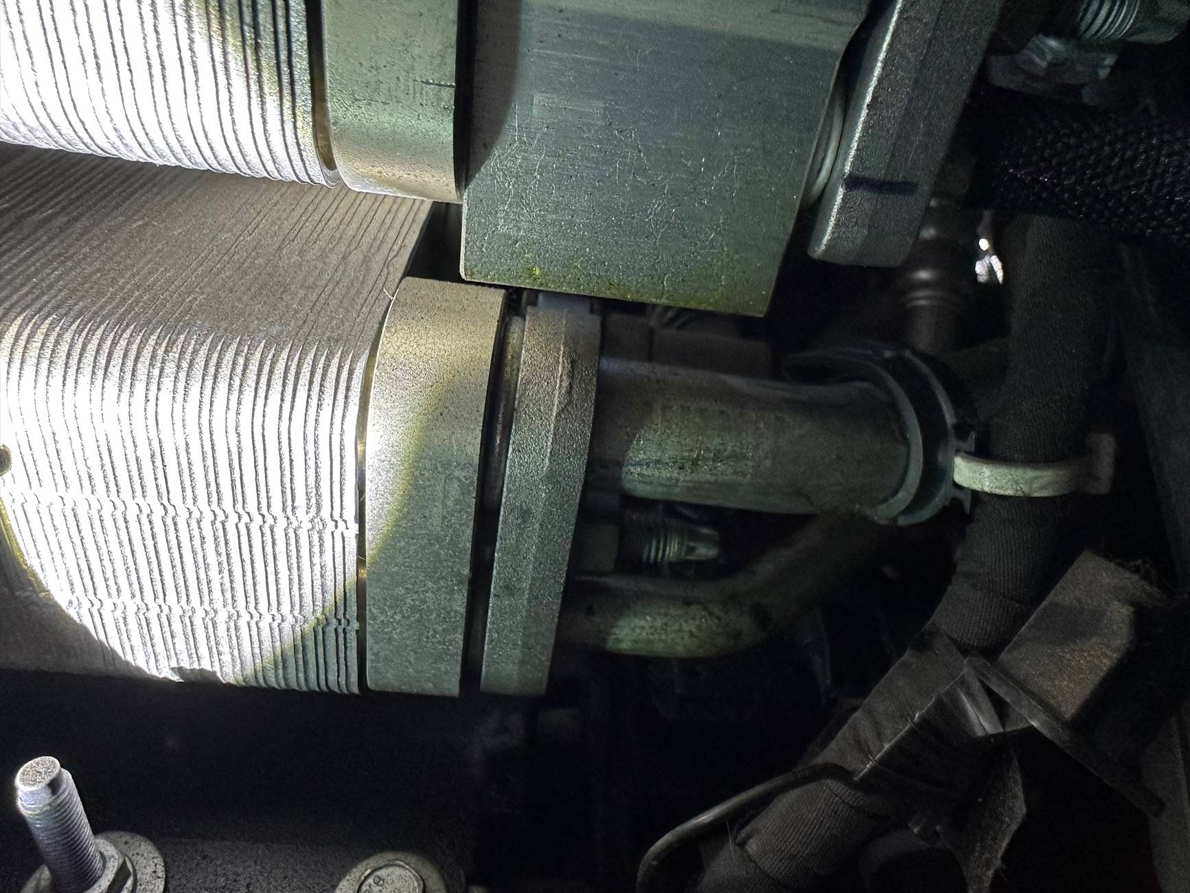

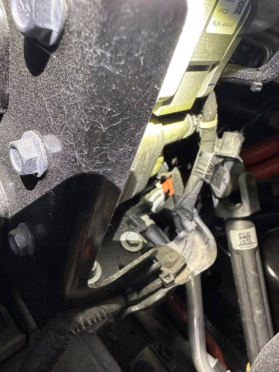

Ok. So my ac is indeed not working. I must have been delusional last night when I thought it was. I have discovered the problem. The system completely leaked out at the heat pump.
I was looking around and the compressor seemed to be very dirty.. but not like dirt dirty or road dirt accumulation.. it was oily.
I started looking more and discovered the heat pump valve is driver side next to the 12v battery .. so I pulled the battery panel and discovered this. The pics are the best I can do. I had the light for the dye but it shows somewhat in the pic it was hard to get a decent angle while in the frunk.
I hope this is a one off and not a sign of things to come..
But here are the pictures .
I’ll drop it off in the morning and hope they can get to it sooner than later.
