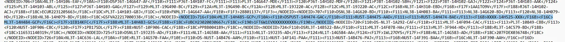

Yeah, the file is formatted XML so can be a pain to read normally. I created a macro in Excel that will decode an ab file and let me see F188 values for all the VINs in my database. If I wasn't lazy I would try to make a program like As Built Explorer that would show that.
I mainly look and compare the F188 parameter as that seems to correspond to the "software version". Do you have a cheat sheet on what the other Fxxx numbers are? Are they just version numbers of other configuration files that get loaded (side-loaded) or does one of them represent the hardware part number?
Tbh, I have never used the ab data to try an obtain a p/n. To me, the info there looks like the file names and not the p/n. If someone really wanted to, I think the easiest way would be to just pony up the $28 to by a 3 day pass for PTS and you can easily obtain the p/n for any vehicle that way.

Great, it worked. Made this table compared to a US 2023 Lariat.
The HW pn for the Sync is unlike anything else, HW Part No: NU5T-14G681-LB
Version SYNC4 v4.0.22326.
Latest Status: No OTA History Available For This VIN. No OTA Currently In Process. There have been no OTA update attempts on the vehicle in the last 180 days.
Both the US Lightning and the Europe uses MU5T-14G681, that is the same for some of the modules under as well, the first letter is different.
Maybe a tech can install a US Sync version? I don't need navigation in the Sync.
