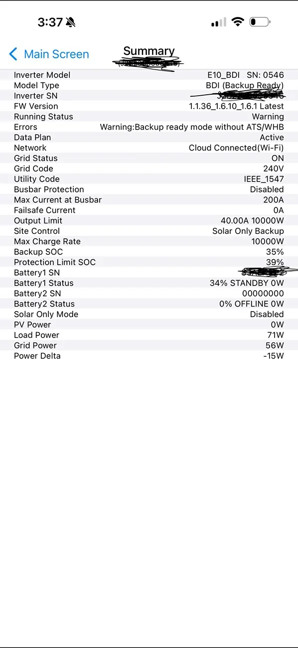

Has anyone else seen this issue listed under errors? I had the system working as a backup only solution (still seen the flakiness of initiating a backup as much as others on this forum). I have since installed solar and a LG battery. Solar and self consumption from the LG battery seems to be working very well. However, backing up from the truck is now FUBAR. If I disable ESS in M professional I will get continuous beep from the MID/WHB. If I enable ESS (with solar and LG battery fully functional) I get go back to that warning and the truck wont attempt to backup. I know my RS-485 connection to MID/WHB is solid because the energy meter is reporting data.
To me it looks like in your testing, you are disconnecting at the wrong place possibly. The error is indicating that your system cannot see the transfer switch box (WHB-200) when in offline mode.
Can you show pictures or a diagram of your system and what breaker you are switching to test? The WHB-200 has a neutral forming transformer in it, and the system will not work off grid if that cannot be seen. Also in off-grid mode, the WHB-200 energy meter should be completely off as it loses power, so the beeping issue should be irrelevant.
If I were to guess, you are turning off the main breaker of your critical loads panel. You should be testing by turning off the breaker in the main panel that feeds the WHB-200 box. You may also need to turn off the breaker feeding the charge station pro if your setup is like mine.
Option 2 would be to turn off the main breaker to the main panel.

I figured out my issue and just wanted to put it here in case it helps anyone else.
it was a “me” issue. I had installed the MID/WHB RS-485 using two wires in a cat 6 (600 volt rated jacket). I didn’t use two wires that were a twisted pair. Although the meter was working it appears the MID/WHB is more sensitive to dropped packets due to EMI. Fixed that and we are working again. Thanks again for others input.
