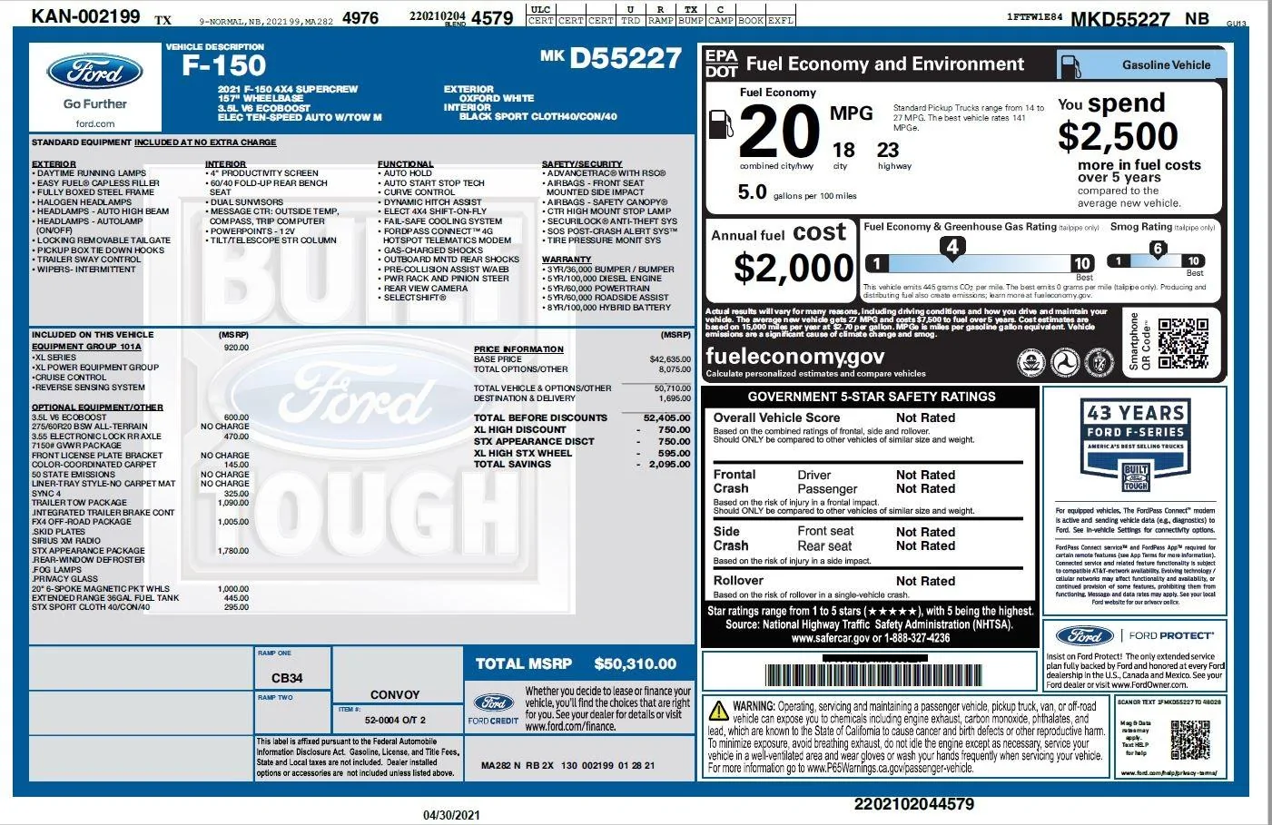

Keep in mind that the higher trims that add heavier options all eat into the baseline payload.
My XL/STX CCLB (sticker below) has 1990lbs of payload. I do have the Trailer Tow package which you will need as a minimum. Without it you are actually limited (on tow guide) to 7,000lbs towing. Obviously the Heavy Duty Payload Package gets you the most payload (500-750 or so lbs. more depending on trim/engine etc.). Getting a Max Tow/HDPP with 3.5 Eco will allow for the highest tow capability (13k+ lbs.)
I would review this link https://www.f150gen14.com/forum/threads/payload-s.3491/ for additional information.

Thanks.. I'll check out the link. And I'll look at the sticker you provided. It could prove very helpful.

Everybody is usually close or over loaded on payload. I don't know how you could estimate the weight of everything the way you are thinking. I would visit dealer lots and check the yellow sticker on trucks that are equipped the way you want one. Have you taken your trailer to a Cat Scale to get real weight, your weight of 7,300# could be a tongue weight of 730-1095# which is the 10-15% rule, all in how you load the trailer. So to figure payload you need tongue weight, add WD hitch is usually around 100#, then add everything that you pack inside the truck and the bed of the truck, people, dogs, coolers, bikes, kayak, etc, etc
