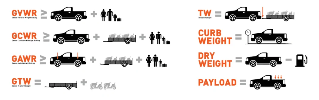

Finally, here is a great little infographic about all the terms.

My understanding is that Payload capacity is reduced by tongue weight, is that not the case? If so, then isn't the image in the lower-right incorrect?
And if so, if I move some payload to the rear of the trailer, or to be sitting directly over the trailer axles, then I would be reducing tongue weight thus allowing for more payload in the truck, correct?

Tongue weight IS payload, yes. But the lower right image shows "just a payload" without using a trailer.
Yes, you can move load around to reduce tongue weight, thereby increasing your available payload. Keep in mind that with not enough tongue weight the trail will start to sway more. It's a balancing act.
