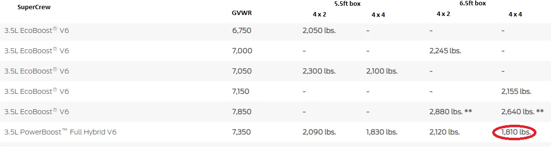

Hi John - here is the payload info Jack was referring to. I snipped your section from the full specs. Judging by your truck photo you have the 6.5 ft box and 4 x 4 so I highlighted your payload. This of course is SuperCrew base and doesn't include options such as box liner, tonneau cover, running boards, moon roof, power XY or Z, power tail gate, etc. I think the tow mirrors, box liner and running boards I see in your photo would chew up ~100 pounds of payload on their own.
Mine is the 4x4 5.5 box so the payload spec was 2,100. With all my added options (moonroof, spray-in liner, FX4 package, power tailgate, running boards, 20" wheels) my payload went down to 1,584 on the door
Total noob move on my part not knowing how much all these options would impact payload capacity. I love the moonroof, but not at the sacrifice of 80lbs of payload. I even searched google to find out if you could remove a spray-in bed liner, and turns out it's not so easy.
So now I'm doing everything I can (cancelled my tri-fold tonneau cover (60lbs), removing skid plates (28lbs), etc. to reduce weight. I even called Ford to find out if I could swap out the tailgate for a non-power one but turns out that's not so easy and very expensive.
