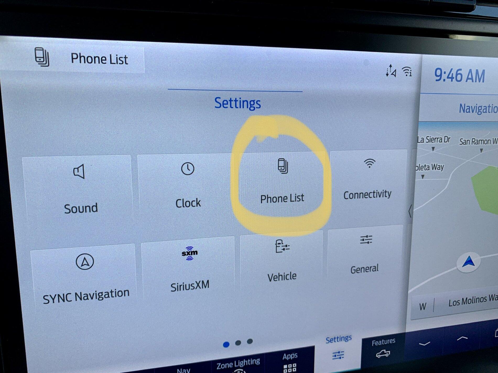

I think I figured it out. Go to settings and select Phone List

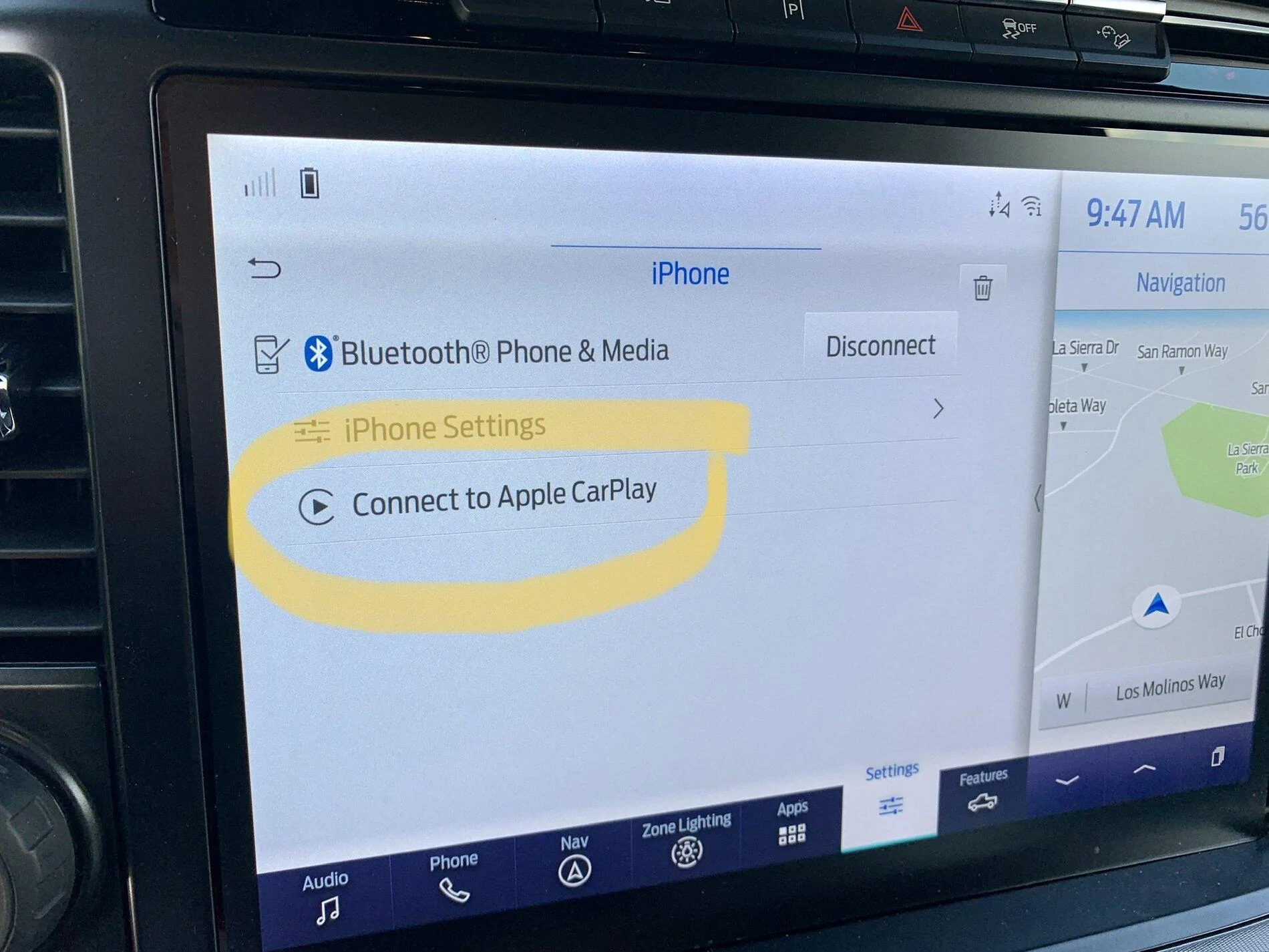

Then select your phone. You can then click on Connect to Car Play. Button will then show up. Still have not figured out how to delete a phone.
Use the trash can ICON at the top right.
