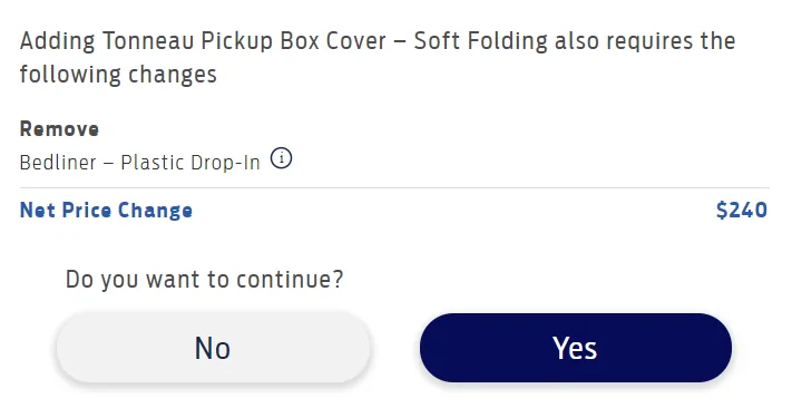

On FORD.com, you can not order them together.
Ford F-150 Lightning Tonneau cover WITH the Factory Installed "Bed in Liner"? Anyone find a solution? No
