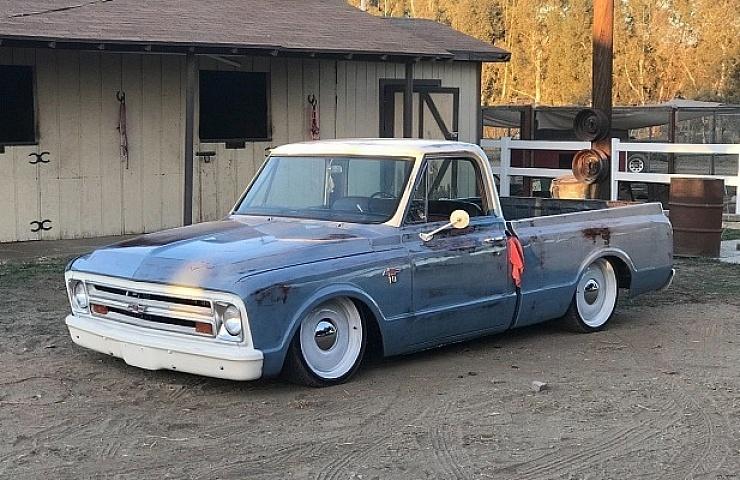

Time for hydraulic suspension mod!
hahaha...I think those low profile tires would do the trick by themselves. Great suggestion!

Oooh, I just measured my barn entrance, it's actually 78-3/4"...so tell me more about this hydraulic suspension! ?

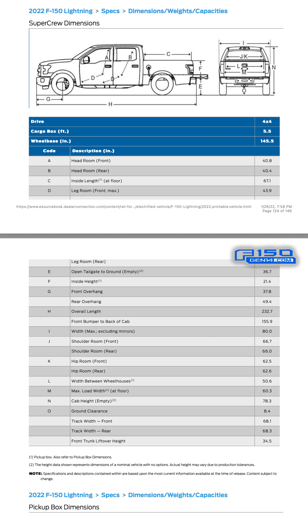

I have a very low garage door opening - 77.5". The prelim specs list the Lightning height at 78.9".....and I can find no production specs anywhere.
The "2022 F-150 Lightning eSourceBook.pdf" (which somebody posted here a few months ago in another thread) shows the height as 78.3" (Code N in the diagram below). The footer for the document lists the date as Jan 26, along with the URL which is for dealers only so won't work for us customers: "https://www.esourcebook.dealerconne...e/F-150-Lightning/2022.printable.vehicle.html
1/26/22, 7:58 PM"
Assuming it's correct, it is still too high for your garage, but it's 0.6" lower than the figure you posted. Not sure which is right, anybody have a source for the 78.9" figure?
Ford F-150 Lightning Exact heights lightning esource

Thanks for the info! It is indeed slightly different (on several dimensions) from what I got from https://fordauthority.com/2021/06/here-are-all-the-2022-ford-f-150-lightning-specs/
Your source sounds quite authoritative (and much more recent), but I figured with the name of my source, they must be an authority! ;)
