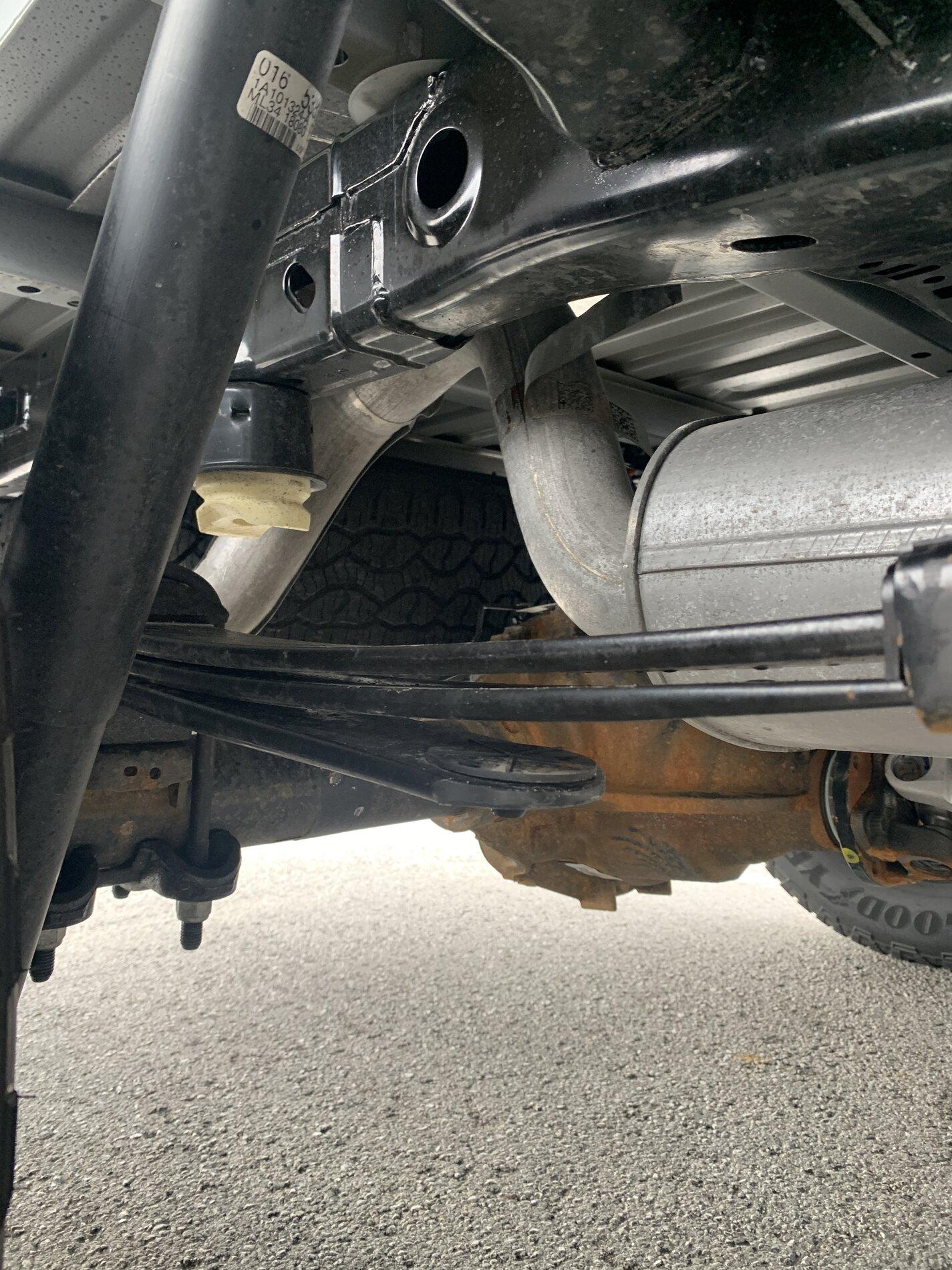

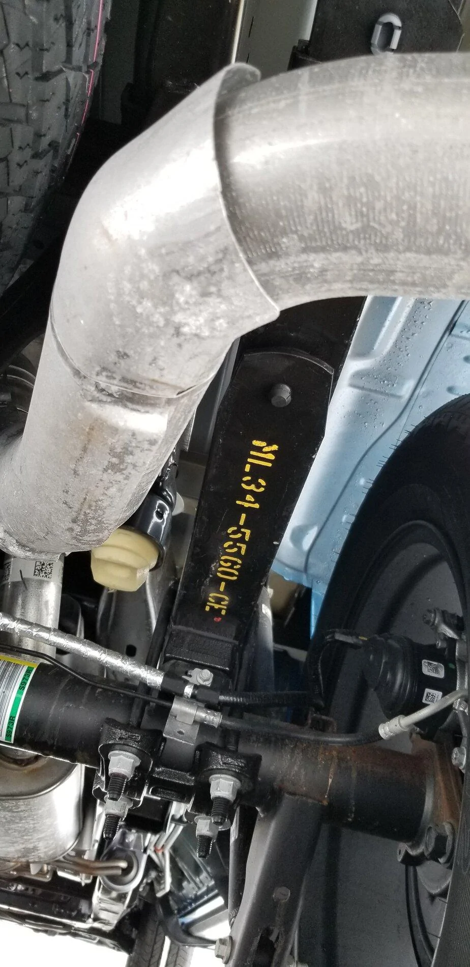

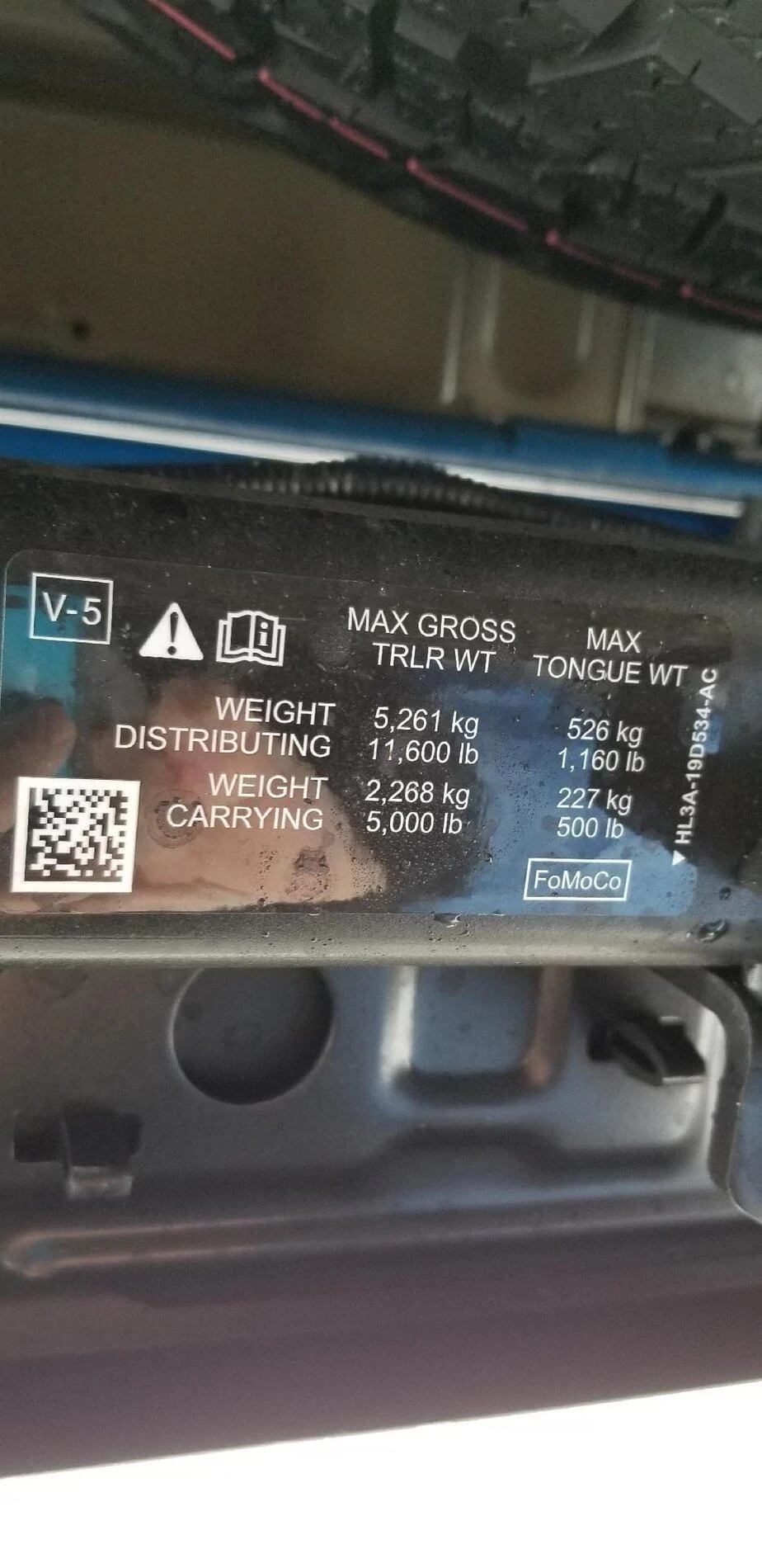

My Powerboost Lariat 4x4 has the regular tow package but with the MaxTow rear leafs....it's confusing to me....either way I tow a 26 Foot XLite Travel Trailer that when loaded averages 6500#......must have been put together with whatever was close at hand. This came off my dealers lot, not special ordered.

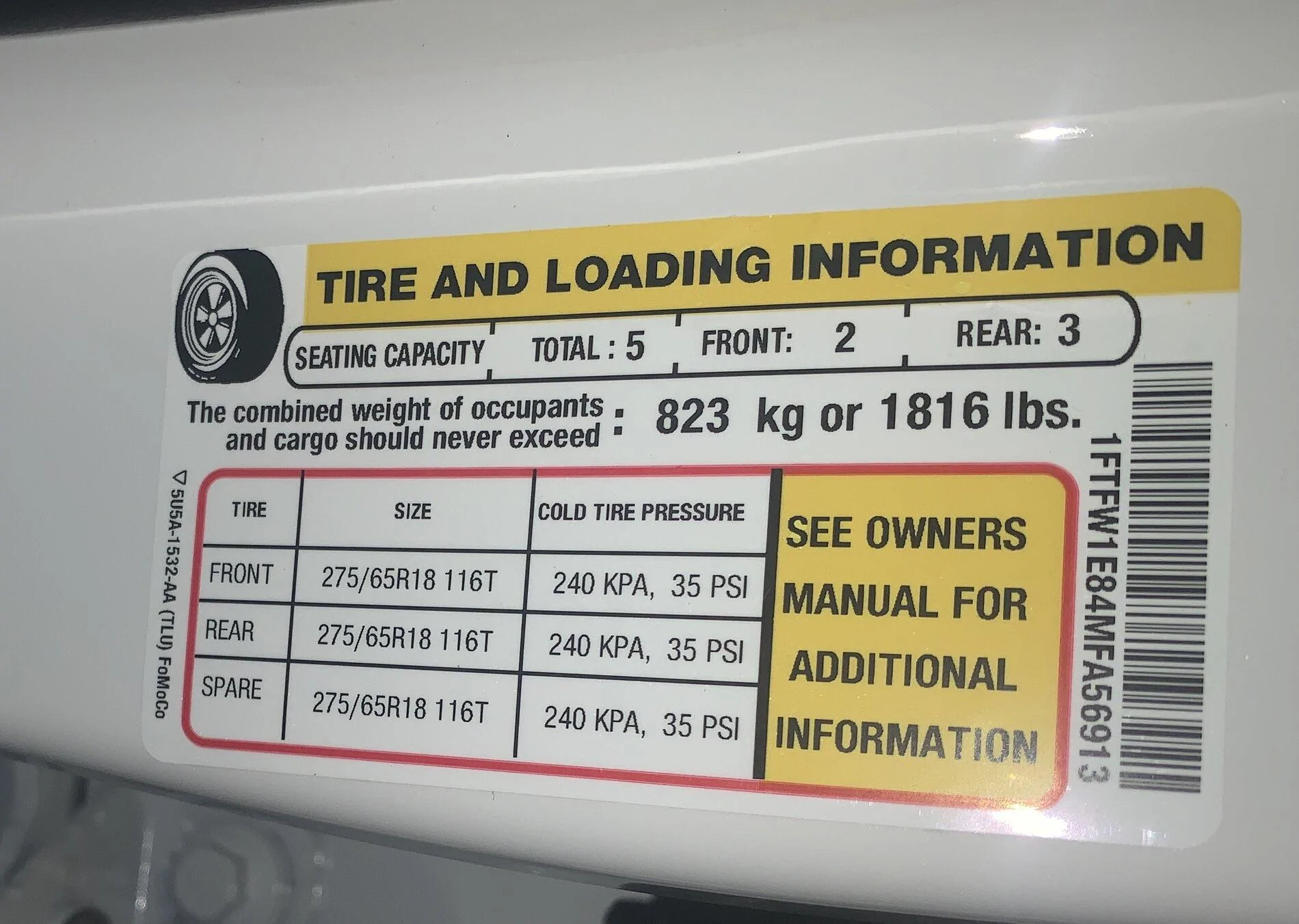

Lariat 500a with Max Tow. The only significant extra weight option that I have is the power tailgate.

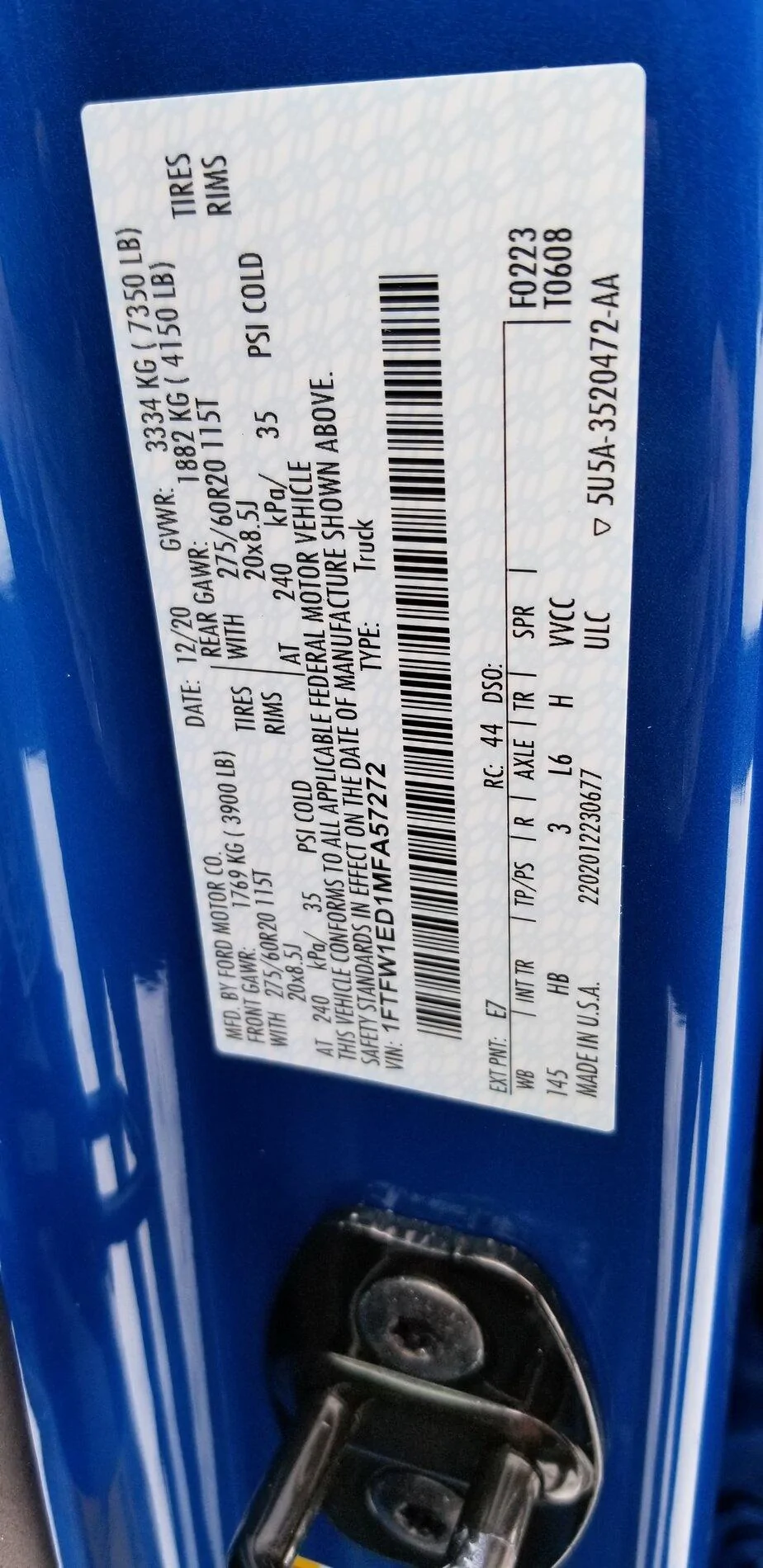

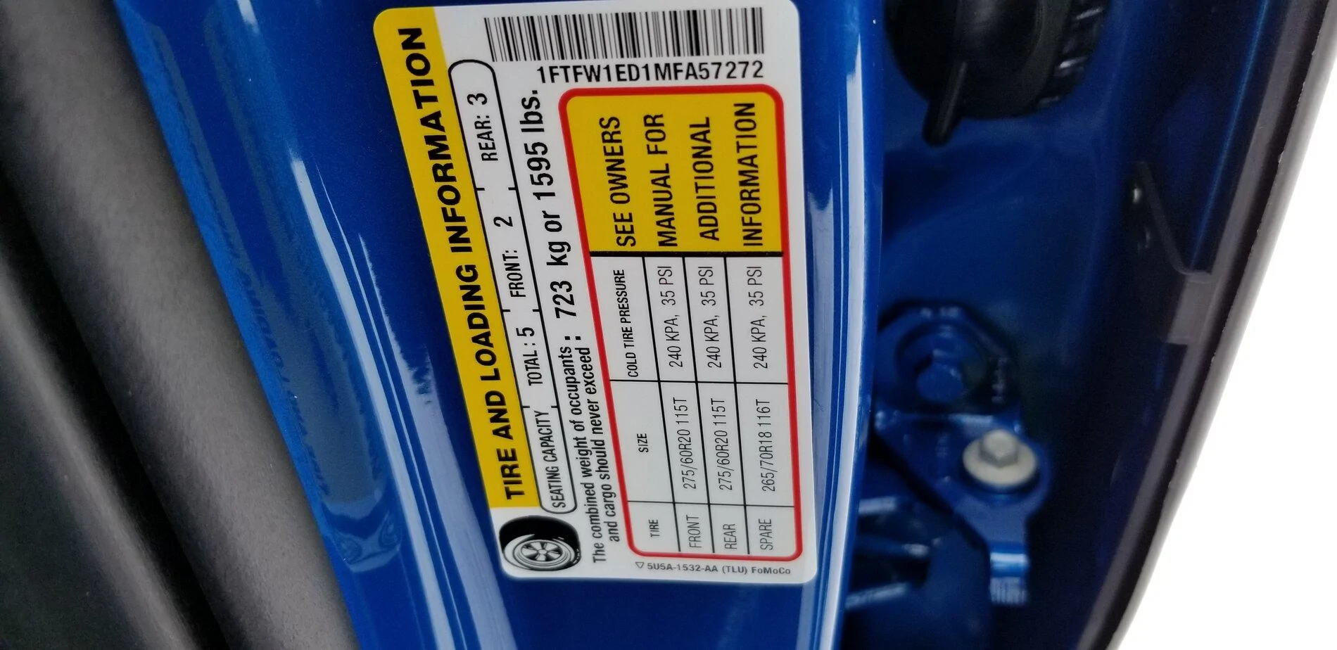

First time posting here, hi everyone. I have 2021 xlt 5.0 ccsb max tow. Oddly I have the same triple leaf springs as Capt Obvious but my rear axle is only rated 3800 lbs. Only difference I see is tire size. I feel like I should have 250 lbs more payload.
Any theories?

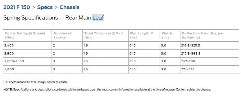

Yes, find the Ford spec pdf for details. You will see though Max Tow (and Hybrid) have 3 leaf, like the HDPP, it is not the same leafs. The Max Tow 3 leaf is listed with spec for Deflection Rate (lbs per in./spring of 247/388. Where the HDPP is 274/431. Also HDPP forces special 18" wheels.

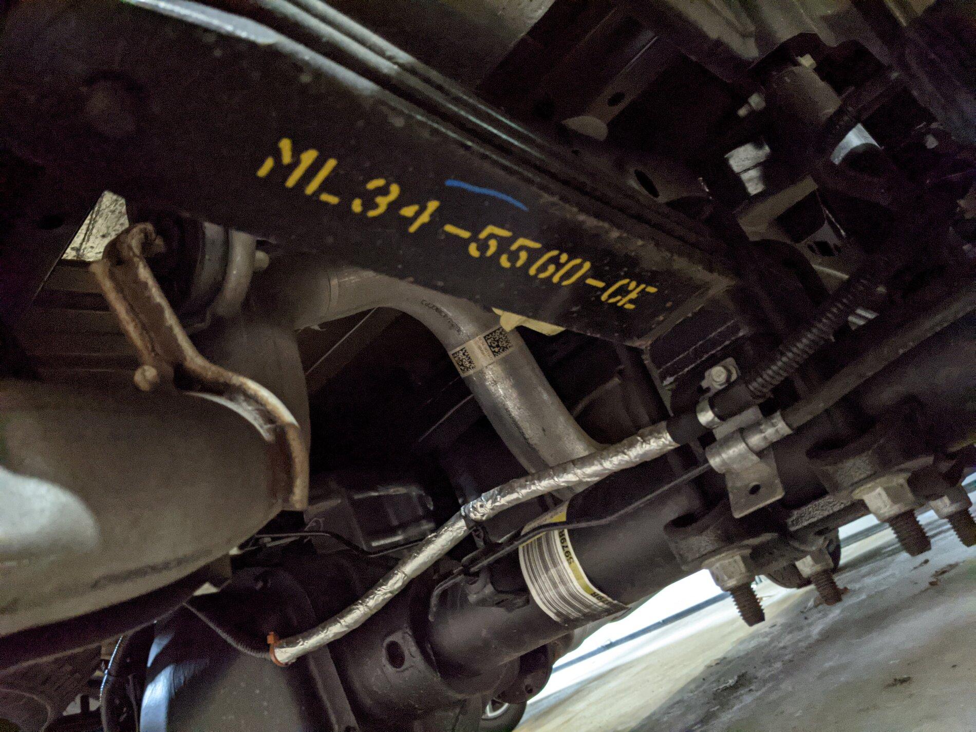

retired technician
........so you are saying the "ML34-5560-CE" we see printed on lowest spring doesn't tell us the whole story on which spring pack we are getting? It doesn't automatically point to the "max tow" springs just because those numbers are there? I am wondering what is difference between a powerboost 4x4 ordered with "trailer tow package" versus "max tow package" for another almost $1,000. Springs, axle assembly, driveshaft, thicker frame and different bumper is supposed to be "max tow package" but seems almost identical on the Powerboost trucks. ???????????

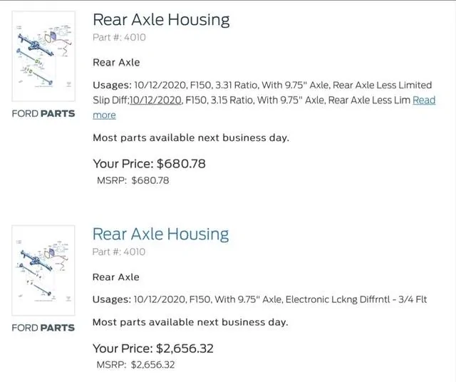

Parts.Ford is really slow right now but there are two different 9.75" rear axles. I don't know if the Powerboost comes with the 3/4 float axle without Max Tow but it is a much more expensive axle compared with the other options.
Some options aren't prorated with others, for example, FX4 for my truck was the same as if I didn't already have the locking rear axle. Which made it a bit of a ripoff considering it was just the skid plates, software and a pair of stickers.
Ford F-150 Lightning Extra leaf spring for max tow? 4A44A65E-00F9-4F39-BC12-1DA992222D0E
The spring packs are different for each GVWR package but they are only one piece of the puzzle. Also, while something may seem right static while the truck is sitting still, dynamic loads are where the engineers earn their money.
Normally, you can look up the equipment on your truck using VIN search on Parts.Ford.Com but sometimes the site won't work and sometimes when it is working, certain VINs won't be recognized. You can always call any dealer's parts counter with a VIN and find out what parts are equipped.
Any theories?
Welcome to the club.
It depends on how optioned out your XLT is. If you have a 302a with extra things like a moonroof and power tailgate you could have eaten that extra 250 up.

Thanks folks. I get the options penalty on payload, I meant gvwr, sorry.
Capt Obvious, yours and mine both have the same gvwr of 7050 but my rear axle rating is lower (I should have mentioned my truck has 4wd and 3.73 locker but not fx4). By the chart posted earlier by daemonic3, 3 leaf springs have a load rating of at least 4050. Yet my gawr is only 3800. (Also the footnote to that chart says "Subject to change" lol). Could it be the cheaper 9.75 axle is the limiting factor? How would I identify which 9.75 axle I have?
