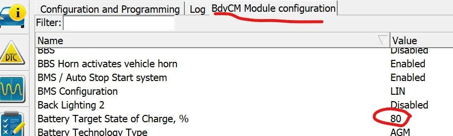

Hokay, since no one on the forum provided an answer to my query
Does any FORScan expert know what the Battery Target State of Charge % does?
I took the low road and asked Microsoft Copilot AI, " What does the parameter TargetSOC_Cfg (TSOCC) • % = Hex2Dec(****) • Range: 0 - 200 in the Ford BCM module control?" This parameter is found in @Livnitup's list of BCM module parameters here: https: // docs.google.com/spreadsheets/d/1-_e09lLPPeSHoO3SsNwyqu5v3dgpbluvJcezUItTSVI/edit?gid=617144335#gid=617144335&range=A106:I106 (take out spaces in https: // docs.google.. and use in browser to find specific spreadsheet location as given in link in Livnitup's OP post here: https://www.f150gen14.com/forum/threads/2021-f-150-forscan-list-database-spreadsheet.1578/)
Here's the answer I got from MS Copilot, which draws its AI answer from other Ford forums.
You
Copilot
The parameter TargetSOC_Cfg (TSOCC) in the Ford Body Control Module (BCM) is related to the Battery Monitoring System (BMS) and controls the Target State of Charge (SOC) configuration for the vehicle's battery [1]. The value is expressed as a percentage and is converted from hexadecimal to decimal format. The range of 0 - 200 indicates the allowable percentage values for the target SOC, where 200% likely represents an overcharge protection limit or a buffer to prevent battery damage due to overcharging [1].
In practical terms, this parameter helps the BCM to determine the desired charge level for the battery to maintain optimal performance and longevity. Adjusting this setting can influence how the vehicle's charging system responds, particularly in terms of when to stop charging the battery to avoid overcharging. It's an important aspect of the vehicle's energy management system, ensuring that the battery is maintained within safe operating parameters.
If you're using a tool like FORScan to adjust this parameter, it's crucial to have a clear understanding of the implications of changing it, as it can affect the vehicle's electrical system performance and the health of the battery [2]. Always refer to official documentation or a professional technician when making such adjustments.
Source: Conversation with Copilot, 7/25/2024
From my understanding of what changing that value does, the answer seems legit. I know many people on the ICE forums that have changed that value and not had any issues. I left mine as it is from Ford. I don't drive much, so I replaced the OEM battery with a more capable H7 battery and have no voltage issues. If I ever suspected low voltage or saw my truck was reporting low voltage codes, I would just throw a charger on it overnight and problem solved.
While I admire your desire to get to the bottom of this and I find that I am the same way when I want an answer to a question, in this case, you may be over-thinking things a bit. Especially for EV's that have a system in place where the HVB is charging the LVB during an update that requires the vehicle to be inhibited, there is not much to be concerned about. IMO, of course.
