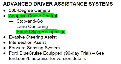

Ok, got to the bottom of this. First off, per the order guide the speed limit sign recognition is a standard feature on the PRO and up (so all levels) in 2024. That said it was not enabled on my truck. If you have a 2024 and it is not working (check the for the setting on Sync first) you can either go to the dealer and fight with them or fix it in ForScan. Here is the info I used on my XLT to fix it in ForScan
