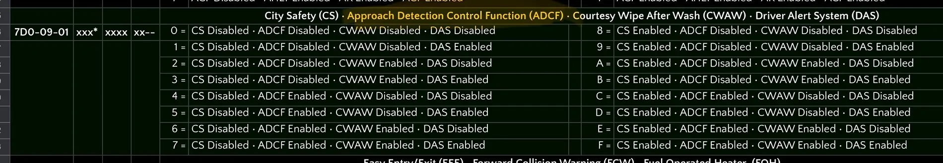

Also, of note, that block for the APIM, the 7 will depend on other settings. I was referencing the table that @carys98 posted. It was a 7 for me because I also had courtesy wipe and driver alert system enabled. It would be different for someone with a different combination of those enabled. I'm not sure what "City Safety" refers to in that block.
All the trucks I looked at were 3 or 7 but your point is very valid. I'll change it to "add 4" with an example, I like that style better but some folks have issues with hex math ;) . I'll make sure the other parameters also don't do double duty.
Ah, I just remembered this is for the APIM so I believe all you are doing here is enabling/disabling the visibility of the toggle switch in Sync. Not actually disabling DAS or Courtesy Wipe. I,e,. we are making the Welcome Light toggle visible along with the already visible Courtesy Wipe and DAS.
For example I have my welcome lighting toggled off but my value here is still a 7 because I still want the toggle to show. Hope that makes sense. I still left it as "add 4" with the "3 to 7" example just in case.
