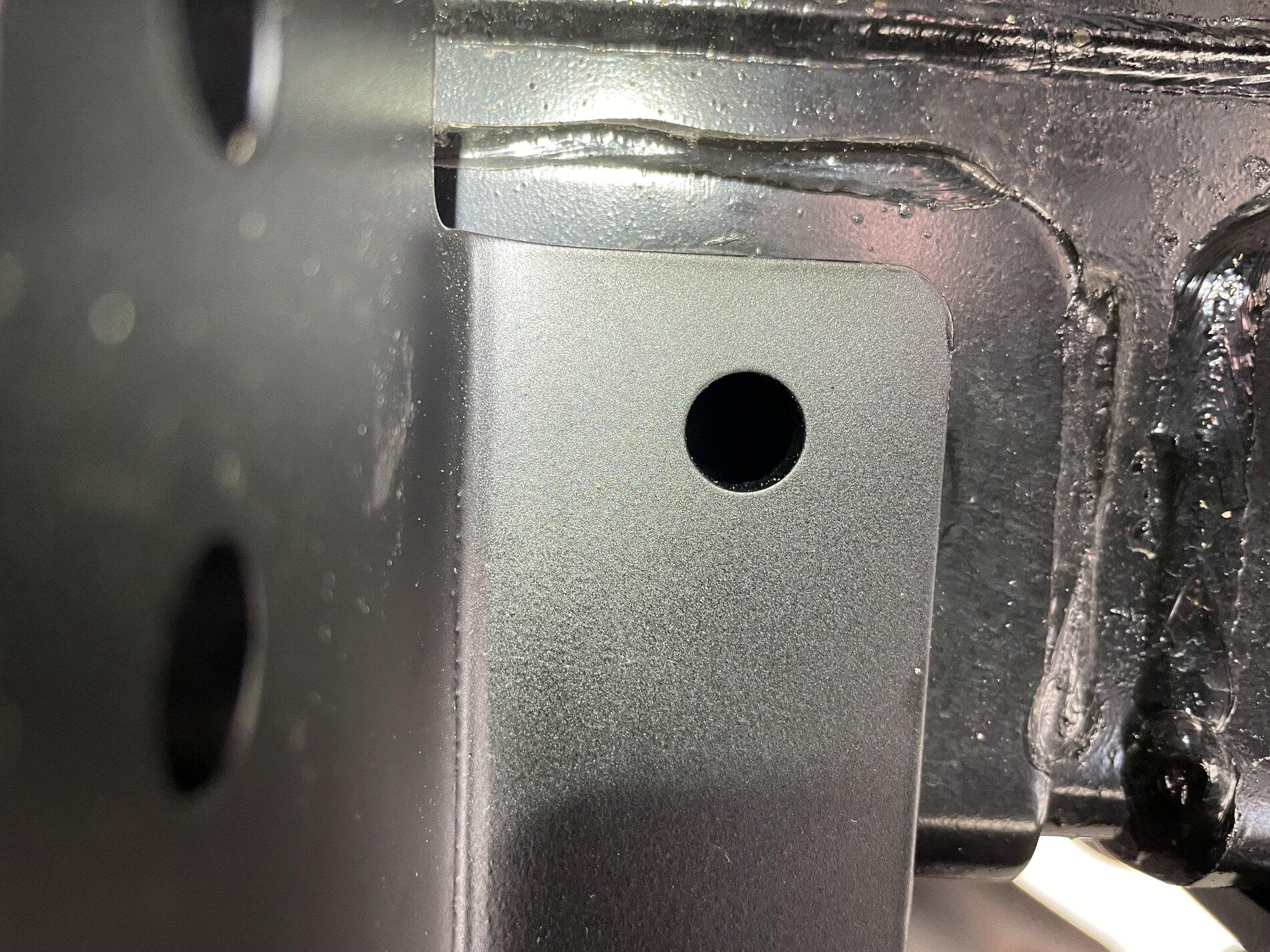

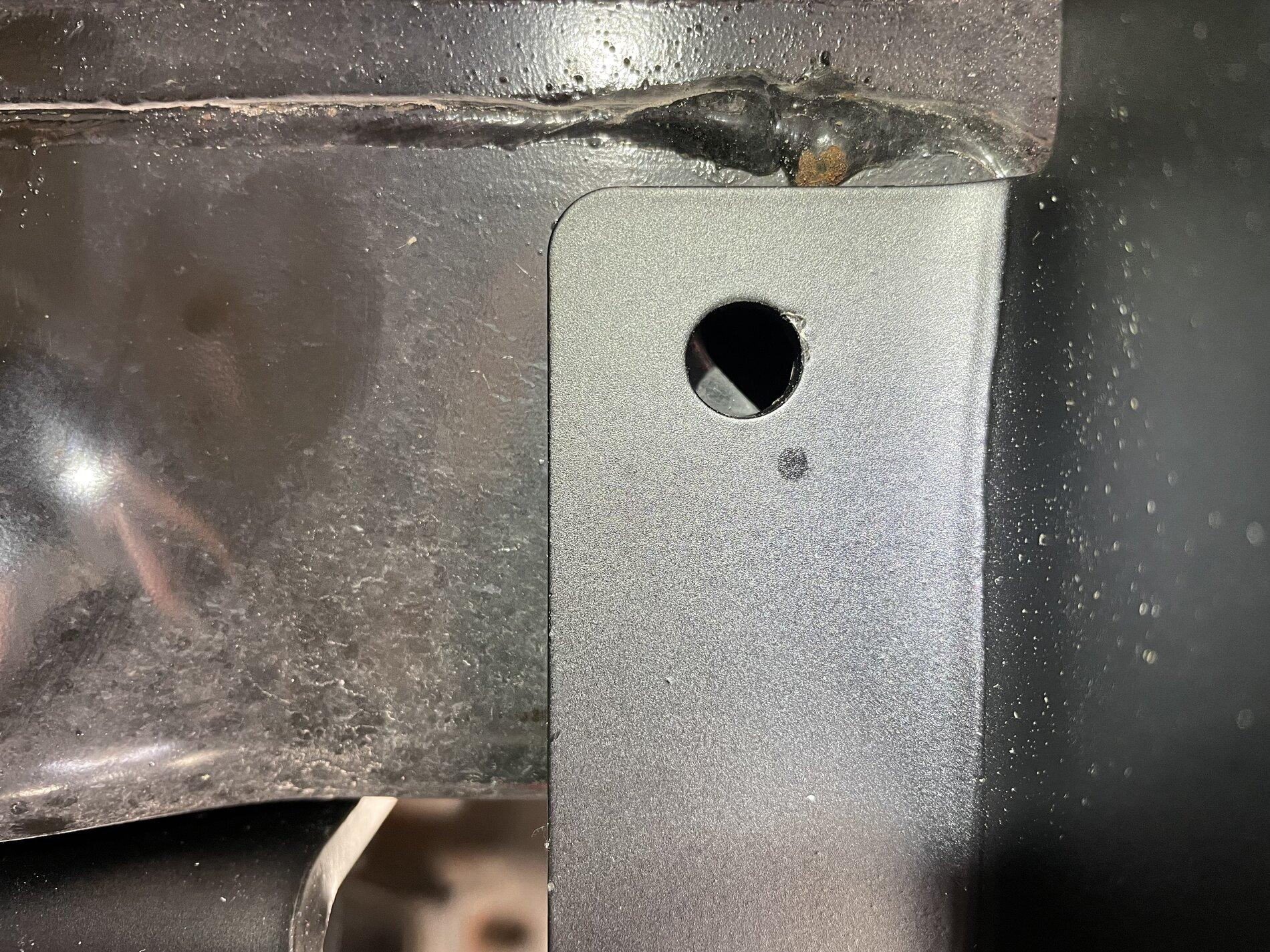

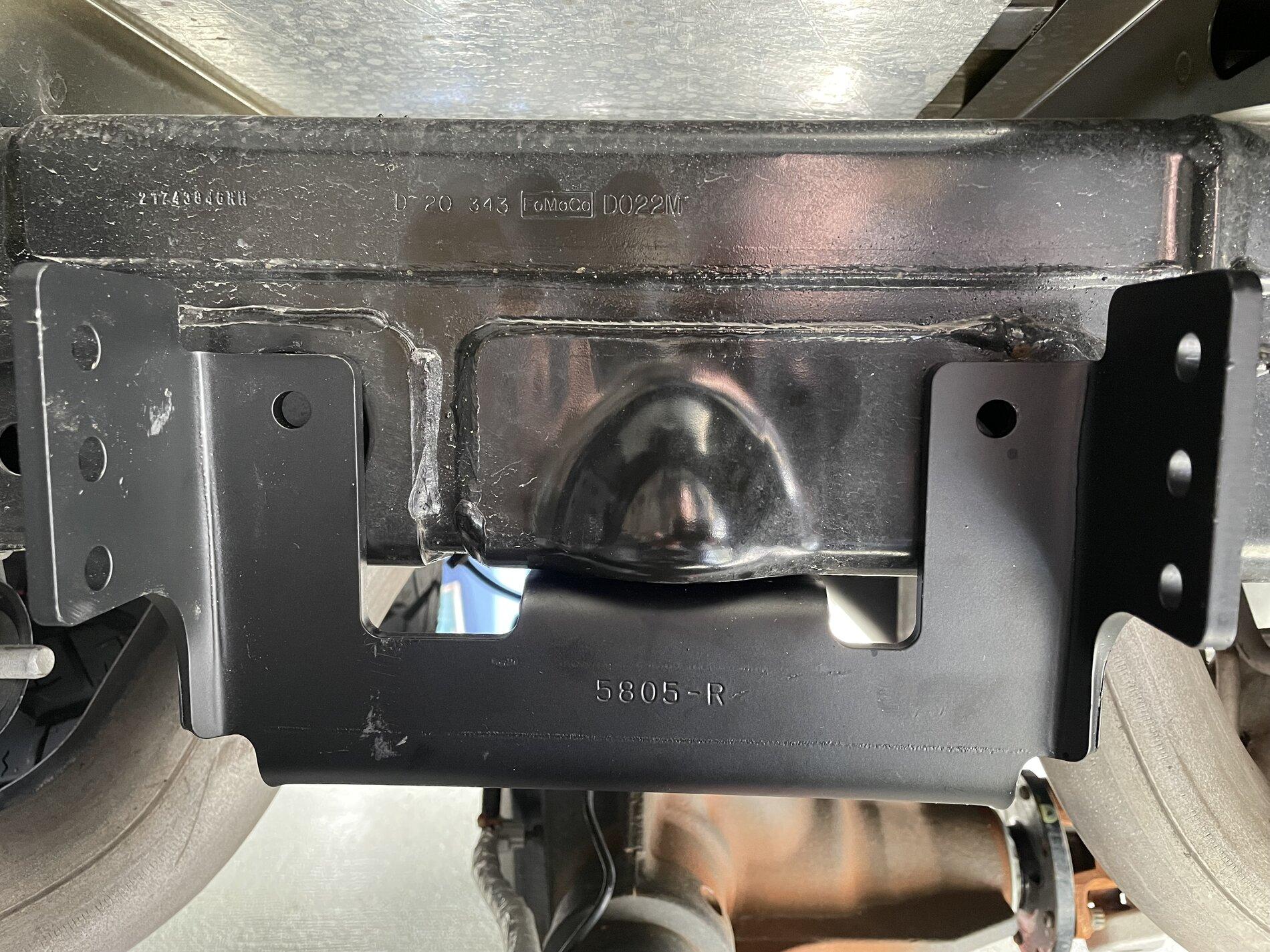

I used Firestone's web tool to find the Ride-Rite kit compatible with my 2021 F-150 (XLT SuperCab) then called Firestone to confirm. They confirmed the 2582 kit is compatible for the 2021 F-150. Guess what? The frame brackets align properly to only one of two frame mounting holes (the rear-side), while the other (front-side) is off-center. See pics. I think have three options: 1) return the kit; 2) make the front-side hole on the frame bracket larger; 3) make the front-side hole on the frame larger. I don't favor modifications to either the frame or frame bracket. What other reputable products are compatible?

Returned the Firestone Ride-Rite, air compressor and air compressor mount. Looking at the Load Lifter 5000 from Air Lift.
