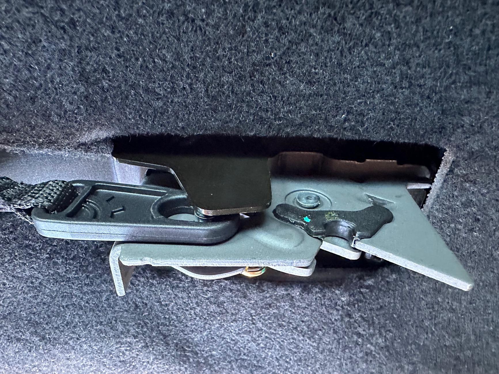

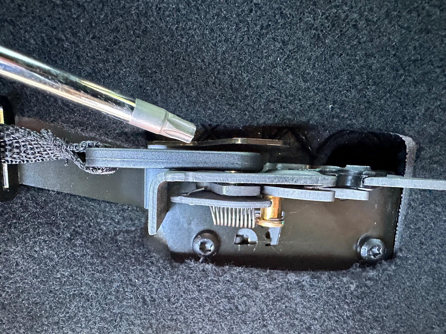

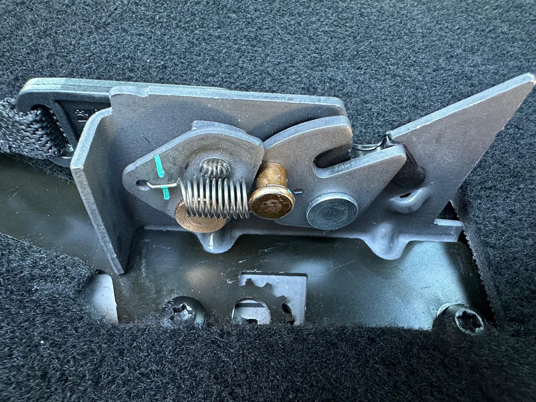

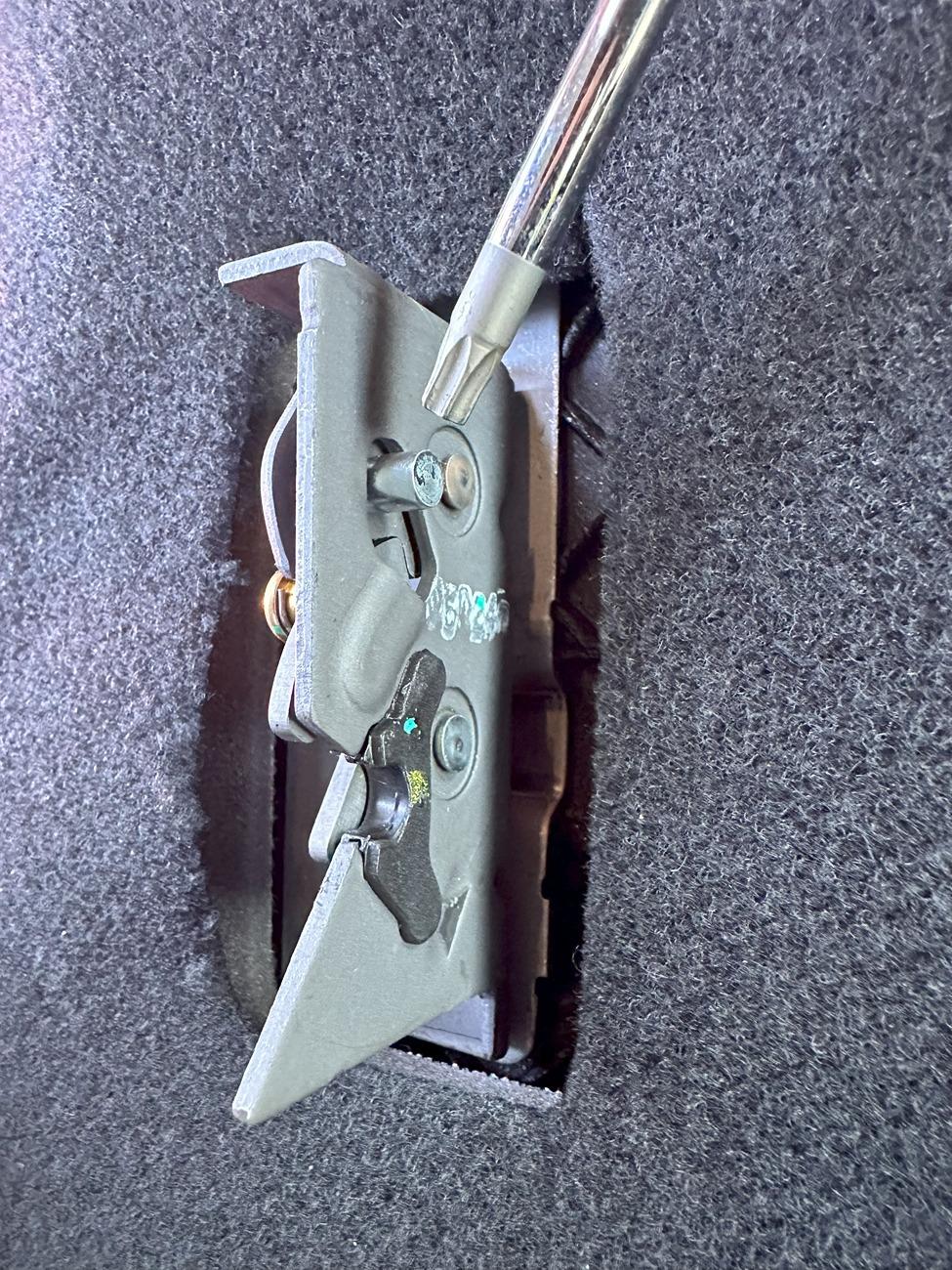

I ordered, received, and installed the driver's side rear seat release from Builtright Industries all in the same day (thanks Amazon!) Just a T30 screwdriver and 5 minutes and it was in.
The pin in the first picture is the initial release pin that releases the seat back and then the strap attaches on. The video link on the instruction card clears everything up and covers possible mistakes people can make. It's very well done. I had to hold the new black bracket toward the passenger side to allow room for the plastic pin clip to move when locked.

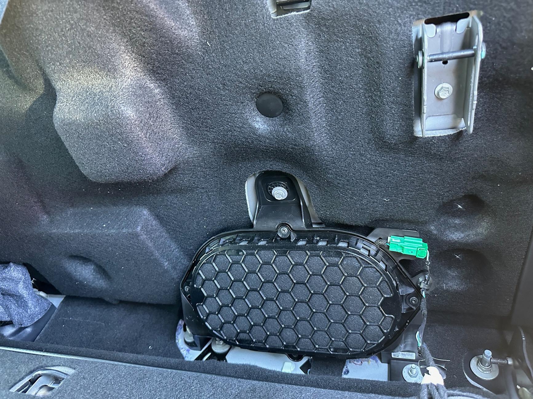

Now it is much easier to access the area behind the seat. There's a subwoofer back there on mine so it's not as spacious as it could be, but any room is better than no room.
