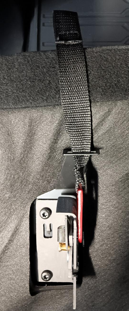

Check how it latches with the seatback down. Mine wouldn't latch either and I noticed the plastic tab would get stuck between the bump by the pin (see first pic) and the black bracket (fourth pic). It prevented it from latching completely. I had to bend the bracket a bit.

So, I purchased the mod and installed, seemed to go together easily. But w/the lower seat up, when I release the latch, the upper seat will not release, it feels like it wants to, or is released, but will not come down until I undo the lower seat and begin to lower it, then the upper will drop. Not a big issue, as long as I remember that procedure...A longer "Factory" pull strap would have been helpful.

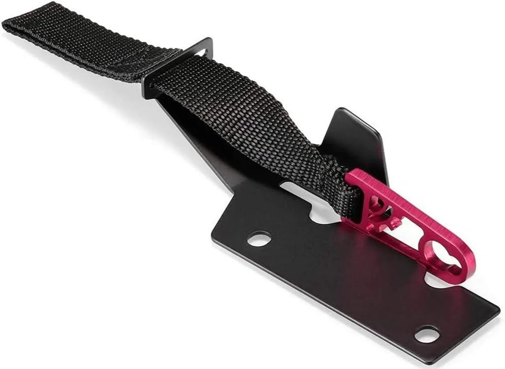

$10.42 Amazon - can't go wrong - 2 minute install ~ w/alloy tab ~ works perfect!
$50 Builtright w/plastic tab ~ f'n joke.

$10.42 Amazon - can't go wrong - 2 minute install, alloy tab, works perfect!
$50 Builtright plastic tab :poop:'s a f'n joke.
