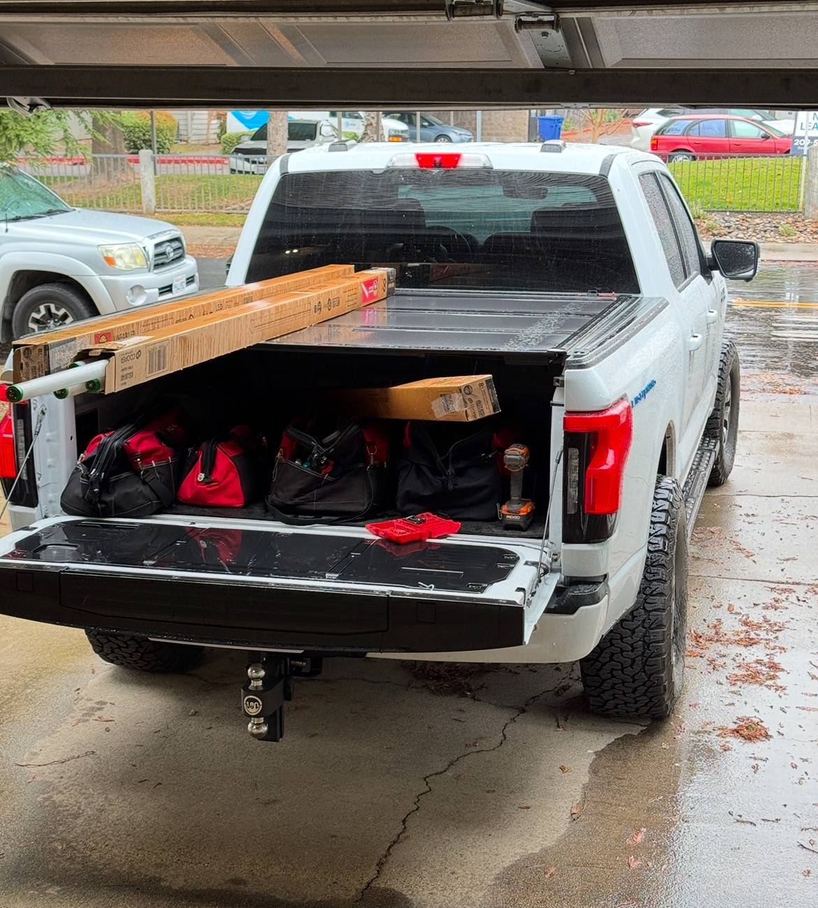

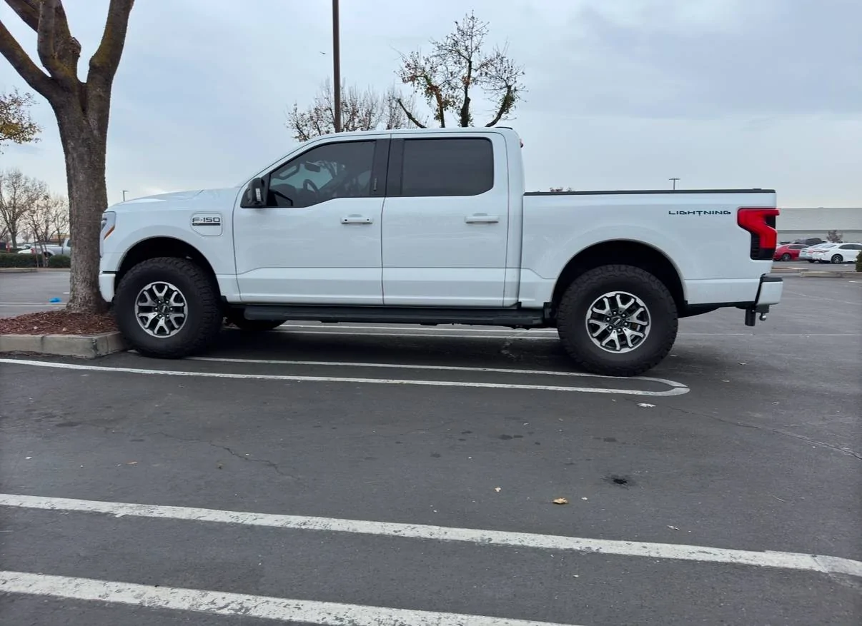

I have a 23 XLT with the 2022 Raptor 17”wheels 315/70/17. You will have to run 2.5” or 3” lift is my recommendation and you will need to run spacers on your front bumper like a 1/4 inch to a 1/2 inch and you will also need to trim out 6” of the Liner That’s towards the front door. I also had to cut out my front support bars. (I don’t remember the exact name) but if you’re willing to install these wheels you have to commit 100% also add on you will need 1 1/2 spacers. I have 10mm spacers in my garage I need to try out need.
Ford F-150 Lightning Fitting larger tires on a MY22 Lightning Lariat? IMG_0038
Ford F-150 Lightning Fitting larger tires on a MY22 Lightning Lariat? IMG_0039
Very nice looking! How have they affected your range?
