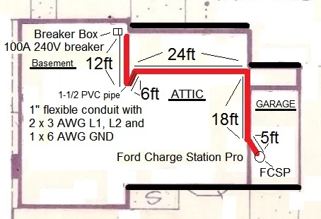

Then I had to figure out how I was going to run the wire and how much I needed going through the attic, the crawl space, or outside the perimeter of my house.
Assuming the worst case, I ordered 100ft of the wires and conduit - of course I was able to find a shorter path and had a lot of left over wire - such is a DIY project.
Ford F-150 Lightning Ford EVSE delivery timeframe 00-wire path measurements
I ordered wire from Nassau Electric Supply, flexible conduit from Amazon, and misc. stuff picked up at Home Depot and/or Lowes (100A breaker, conduit straps, etc.).
To get the wires through the conduit, I laid the wire and conduit (1" non-metallic liquid tight flexible conduit) out across my back yard, used a vacuum cleaner to pull a wad of paper towel with wire pulling rope tied to it through the flex conduit - easy peasy. Then tied the pulling rope (Southwire QWIKline POLY LINE) to the wires (2x#3AWG and 1x#6AWG THHN THWN-2) , and as I tugged at one end, my wife slathered on wire pulling lube (Ideal Clear Glide) on to the wire - much easier than I thought it would be.
Getting it up into the attic was a chore - pulled it up foot by foot through a ceiling access panel in my garage to the attic. Then I fed the 6 or so feet needed down to reach the FCSP on the garage wall, and routed the rest over to a location above the basement room that had the Eaton 200A service panel with the brand new 240V 100A breaker for the FCSP, then down to the room and over to the panel. My house is a split-level so the vertical distances are 5 to 6 feet.
