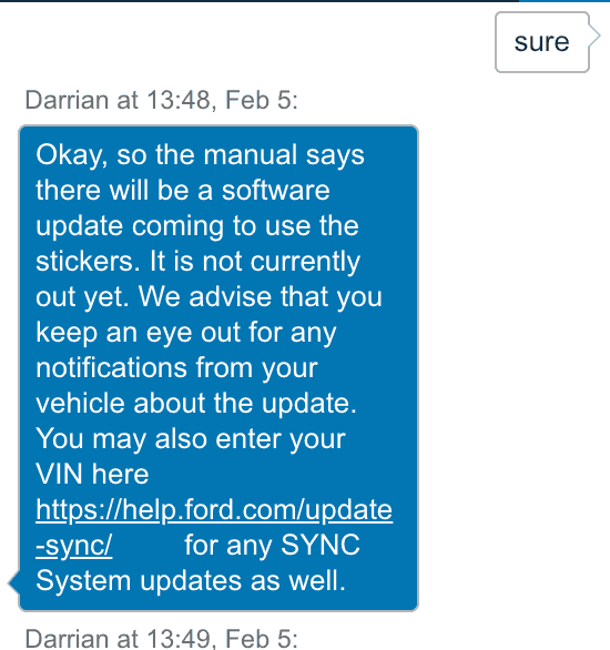

See the screenshot from my chat with Ford Support. "There will be an update coming..." It's odd they released this truck and removed the sticker option that worked so well with my 2016 XLT.
Re " There will be an update coming..." It's odd they released this truck and removed the sticker option that worked so well with my 2016 XLT. "
If they built SYNC4 from the scratch, rather tan starting with SYNC3, it would be a matter of not having added it to SYNC4 yet. With over the air updates it gives Ford the option of developing the minimum needed to release the truck & add less important features later.

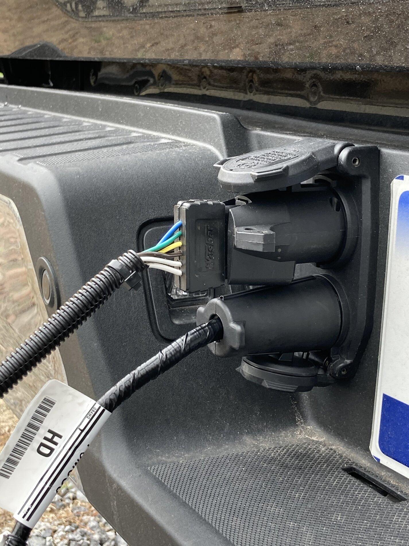

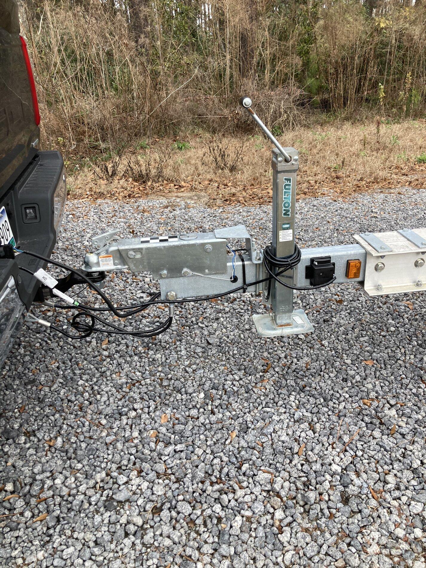

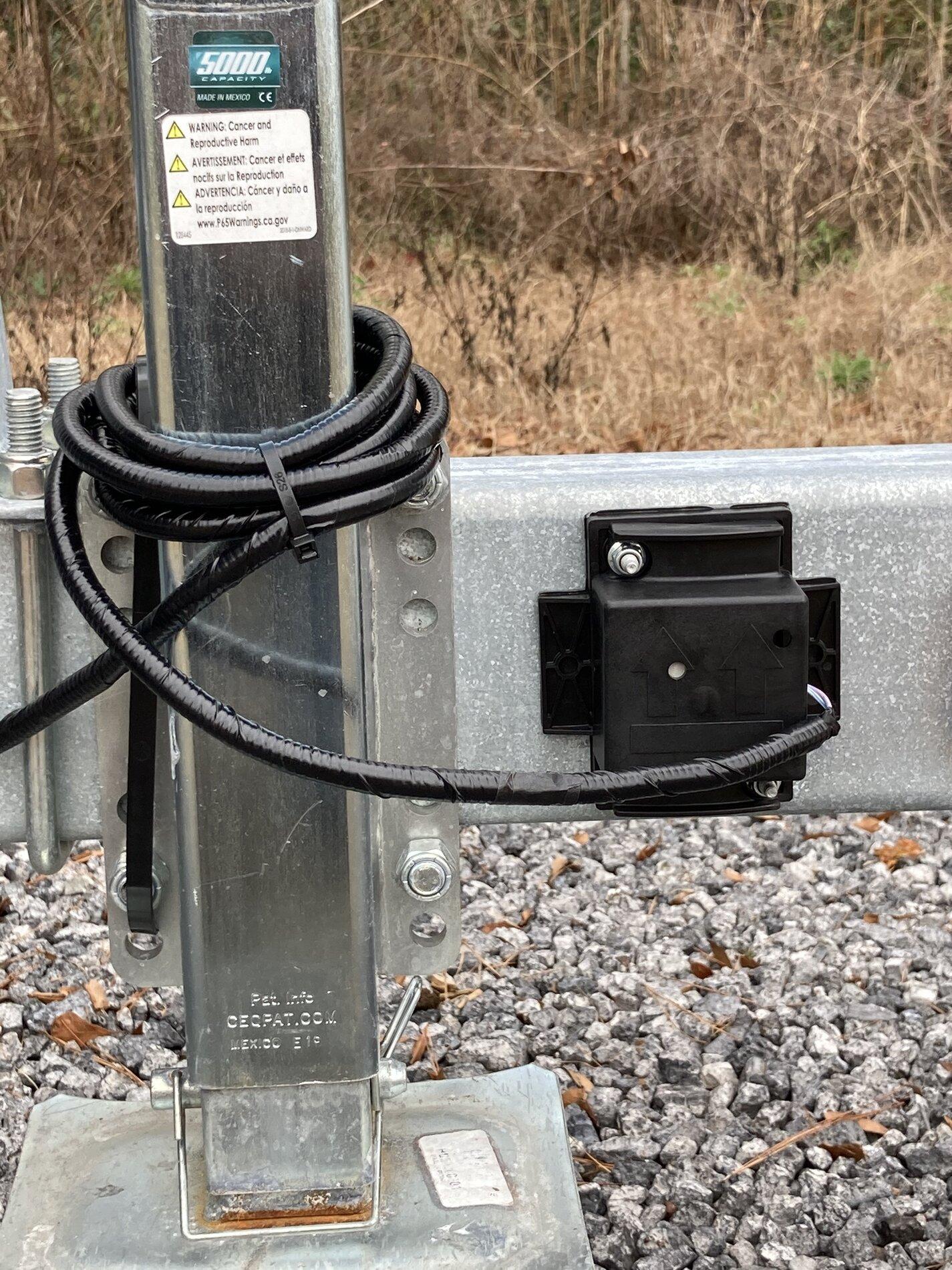

Good news on the Sensor front. After watching the video I went out and connected the sensor to my 27' EZ Loader boat trailer. Confirmed that the sensor with wire harness does in fact work with a conventional trailer. Once I connected everything up I went through the calibration process. You do need room to make some sharp turns. It had me do several turns then let me know the calibration was good. I backed into some very tight spots with ease. Great feature but I will be glad once the sticker config update is ready. See pics of my set up. Only thing I need to confirm now is whether the spot I put the sensor will be submerged at the boat ramp. Will verify and adjust as necessary.

In theory it has to be water proof, right?

It looks like it will be protected from rain and splashes. But if you look at the right side of the sensor it’s pretty wide open and the connector doesn’t appear to be IP67. I’m not confident submerging it.

I'm confident that it works great. I just don't like having to secure extra wires like that, and look at that length! It definitely is primarily designed for 5er/gooseneck trailer, where it will be somewhere near the kingpin inside the bed, and have more length to go out, over the tailgate, and to the connector. A conventional trailer does not need that much length for sure.
Also look at how on the conventional trailer the wiring has to do that initial sharp 180 degree turn, as the natural side you want to put it on is the SAME side as the truck's plugs. If it is attached inside the bed, the cable has no initial 180 degree switchback.
Regarding multiple trailers, imagine having to remove and secure it every time with zip ties. That is incredibly annoying. I'll probably use velcro straps that are re-usable instead.

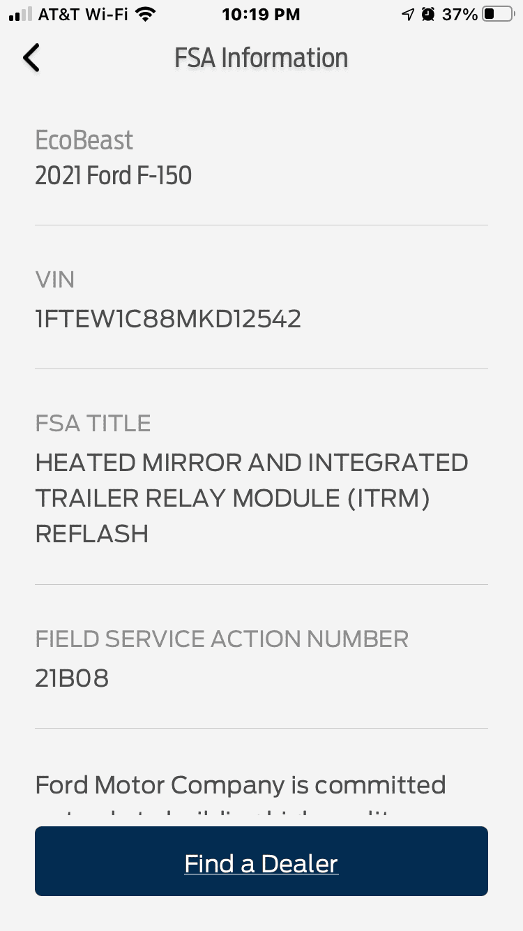

Just got this recall notice. I wonder if this is linked to the Backup assist decal targeting?
