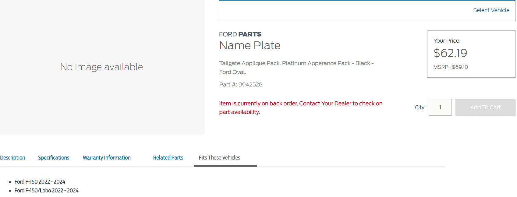

I think I found it. You had one too many 4's.
NU5Z-9942528-B
It seems it's not an Explorer part, but the badge on the gas platinum truck with the Black Pack.

For anybody that is looking at picking up the name plate, part number NU5Z-9942528-B, it is currently on national backorder with no estimated delivery date.
Also, according to parts counter person at my dealer, it's not an Explorer part. It is the name plate on the Platinum tailgate for an ICE truck with the Black Pack.

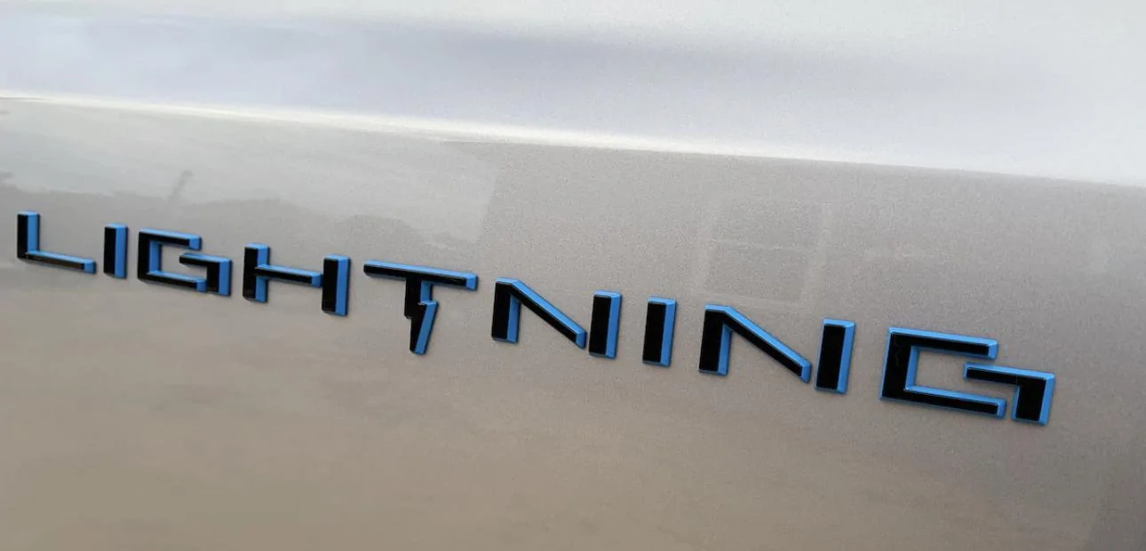

What about the side of the bed LIGHTNING letterings. Do you have a part number for that
Someone here with an OW has been successful using Plastidip for blacking out this one.
