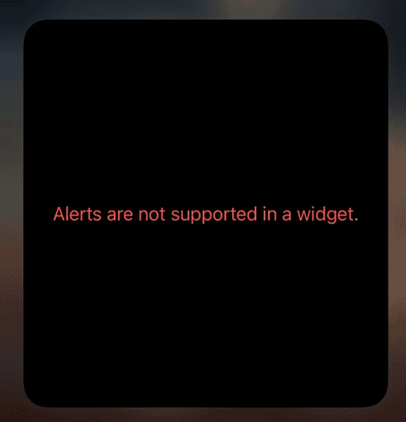

I'm on the new script version and the home screen widget no longer works. Error says "Alerts are not supported in a widget" Also notice that my session is not staying logged in, keeps prompting to login with un/pw and VIN every time I open. Seems like the new code is clearing cached credentials or something.
Maybe this part of the change is causing this >>>
  • Added the ability to hardcode an id into the script to allow for multiple instances for multiple vehicles. See the SCRIPT_ID in the script header (Not fully tested).
Tap on the widget to run it manually and it should work.
It works when I run it manually but for some reason the IOS home screen widget no longer works. It may be related to the always prompting for creds now when I run it manually. When I remove the widget from home screen and readd it briefly display data then errors to the error.
Screenshot of error.

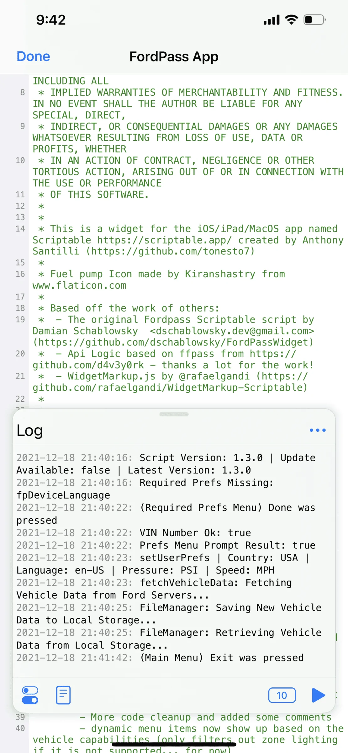

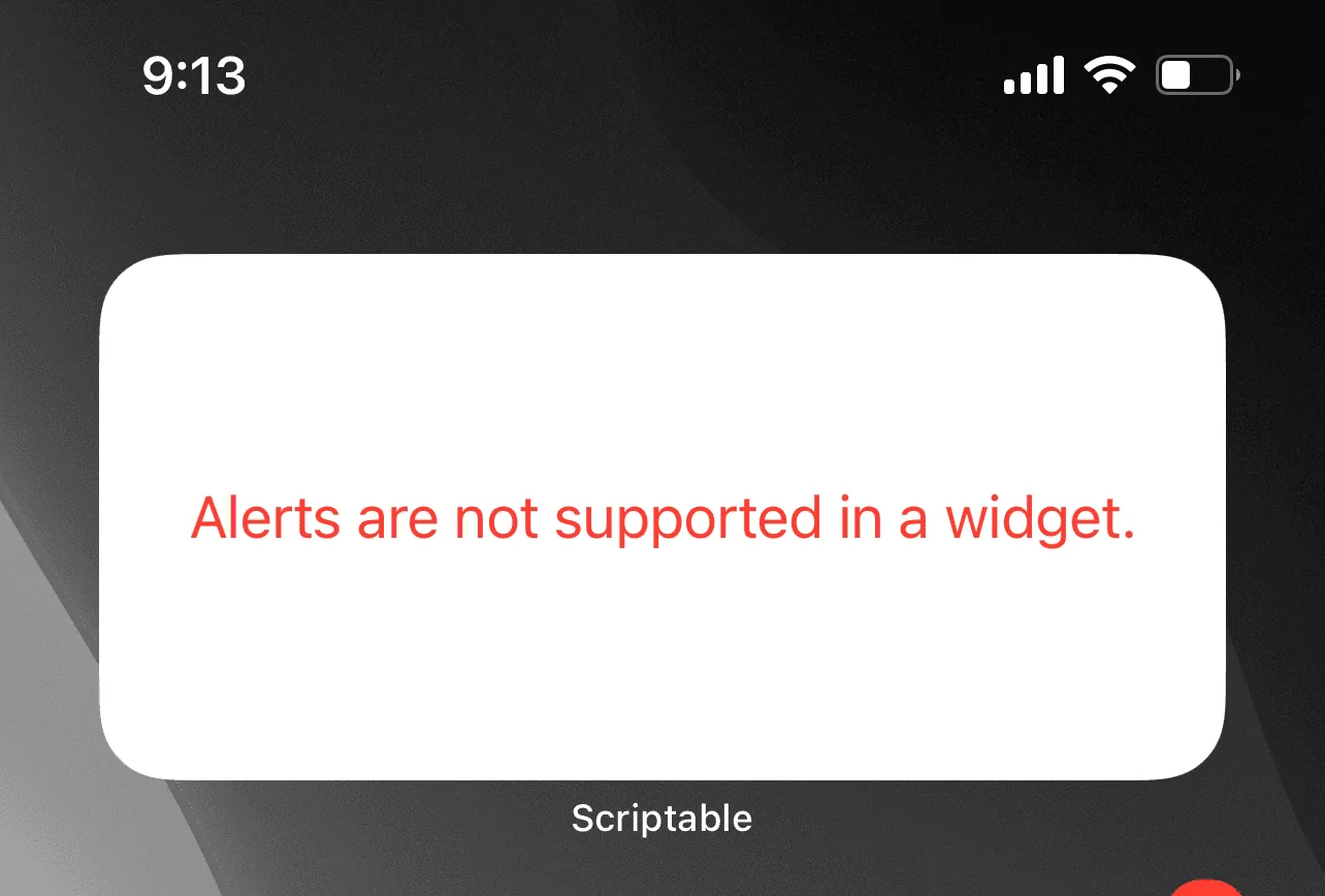

I am getting this error. Any thoughts
Open the scriptable app and tap on the ... on the ford pass widget.
Slide up the log view and press play bottom right.
Try logging in again. If it fails review the logs.
Ford F-150 Lightning FordPass - Scriptable Widget (iOS, iPad, MacOS) 1639881654144
It runs but still the same error
There is only one location in the code that the widget itself uses the Alert functionality and that's in the new vinCheck() function.
It checks to make sure your VIN is correctly formatted and doesn't contain any special characters.
I just added a check to prevent the alert function from being used.
Bottom line it doesn't like the format of your VIN

@tcp You need to remove that token info ASAP... It's not going to allow someone access because it expires after a few minutes, but shouldn't share it none the less.
I don't see any reason why yours isn't working... I did see someone report that the deviceLanguage variable was causing a constant login prompt. I will remove that variable requirement.
