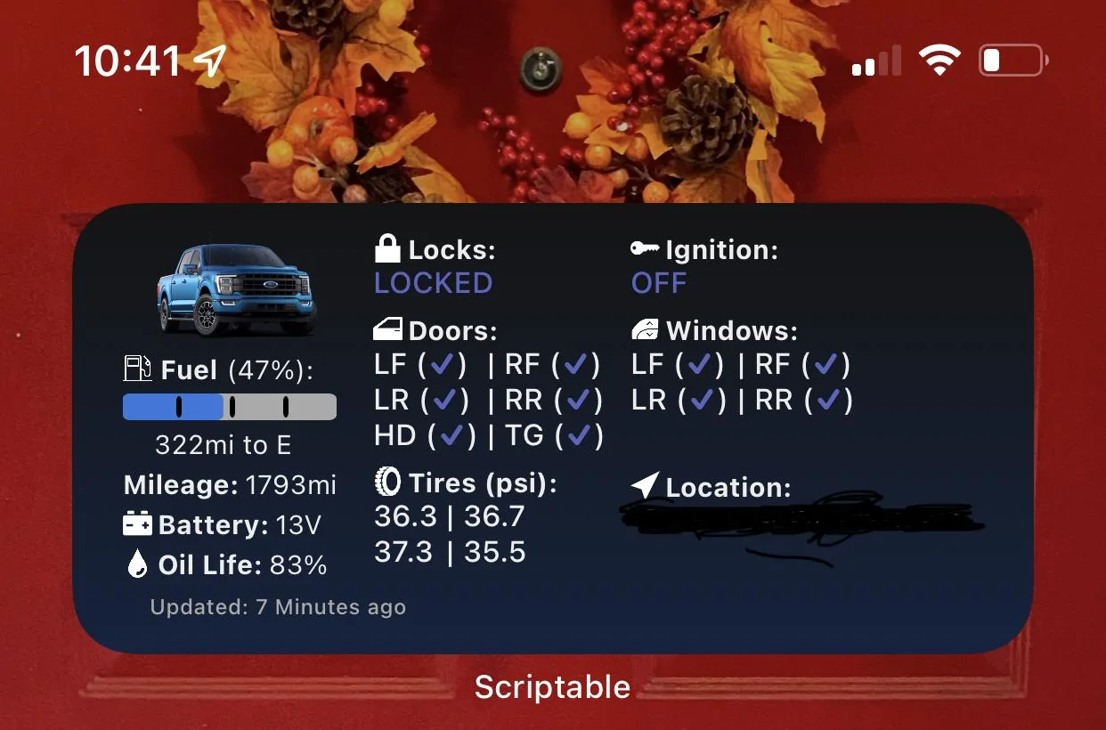

If we are working with you though to help find bugs, I did notice that once the vehicle has been shut off for awhile, the new low oil level warning comes on when the oil life data also disappears.
When the truck is turned back on, these go away.
Ford F-150 Lightning FordPass - Scriptable Widget (iOS, iPad, MacOS) 1639940151624
Merccat
Ryan
Apr 4, 2021
570
104
2021 Space White Lariat SCAB 5.0 4x2
Interesting thing on the low oil level warning. I saw it in the widget, nothing in the ford pass app and figured I would check the truck itself. Starting the truck there were no alerts and as the last post noted the low oil alert went away. However physically checking the oil it is in fact low (down to the bottom hole on the dipstick).
