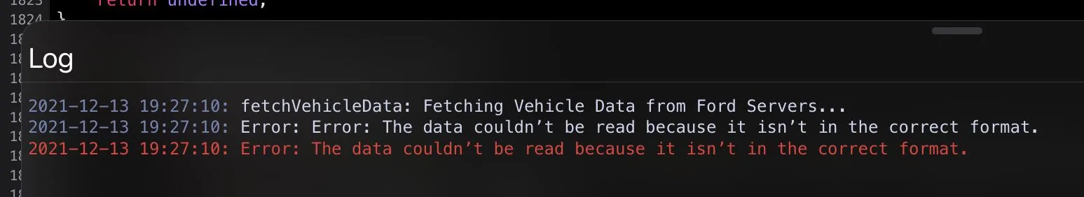

This is badass looking! However, I cannot get past the login. I put in my credentials (even confirmed them several times through my attempts) and still get an error that says "The data couldn't be read because it isn't in the correct format" Any tips on what I'm doing wrong? I'm very tech savvy so I'm scratching my head at what's going on...attached is my log

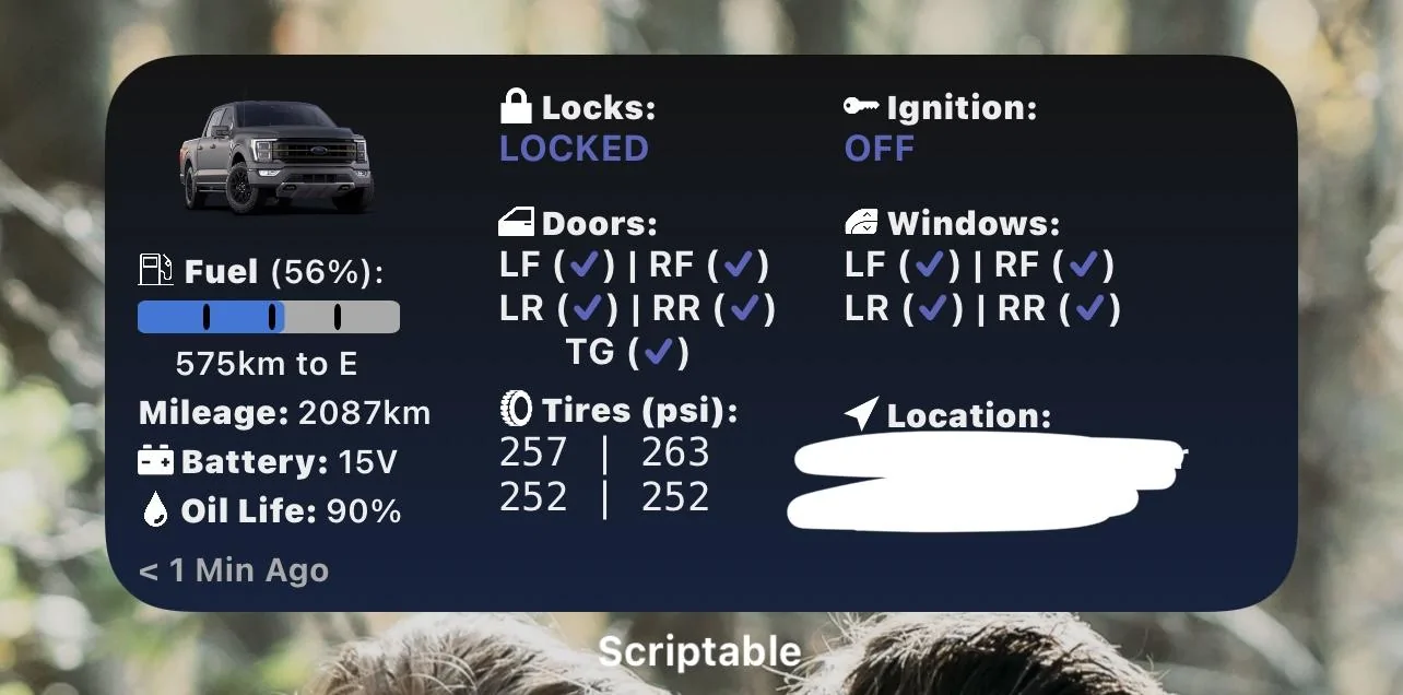

Is there a way to have the mileage in metric (I’m Canadian so need the kms) but still have the tire pressures in PSI?
when I change to metric it forces the tire
Pressures into kpa even though the settings say psi
Yes, tap on the widget, and when it opens the scriptable app and shows the menu. Tap on widget settings you will see the setting there
yes I have the settings as metric and psi. But it still shows as kpa on the widget

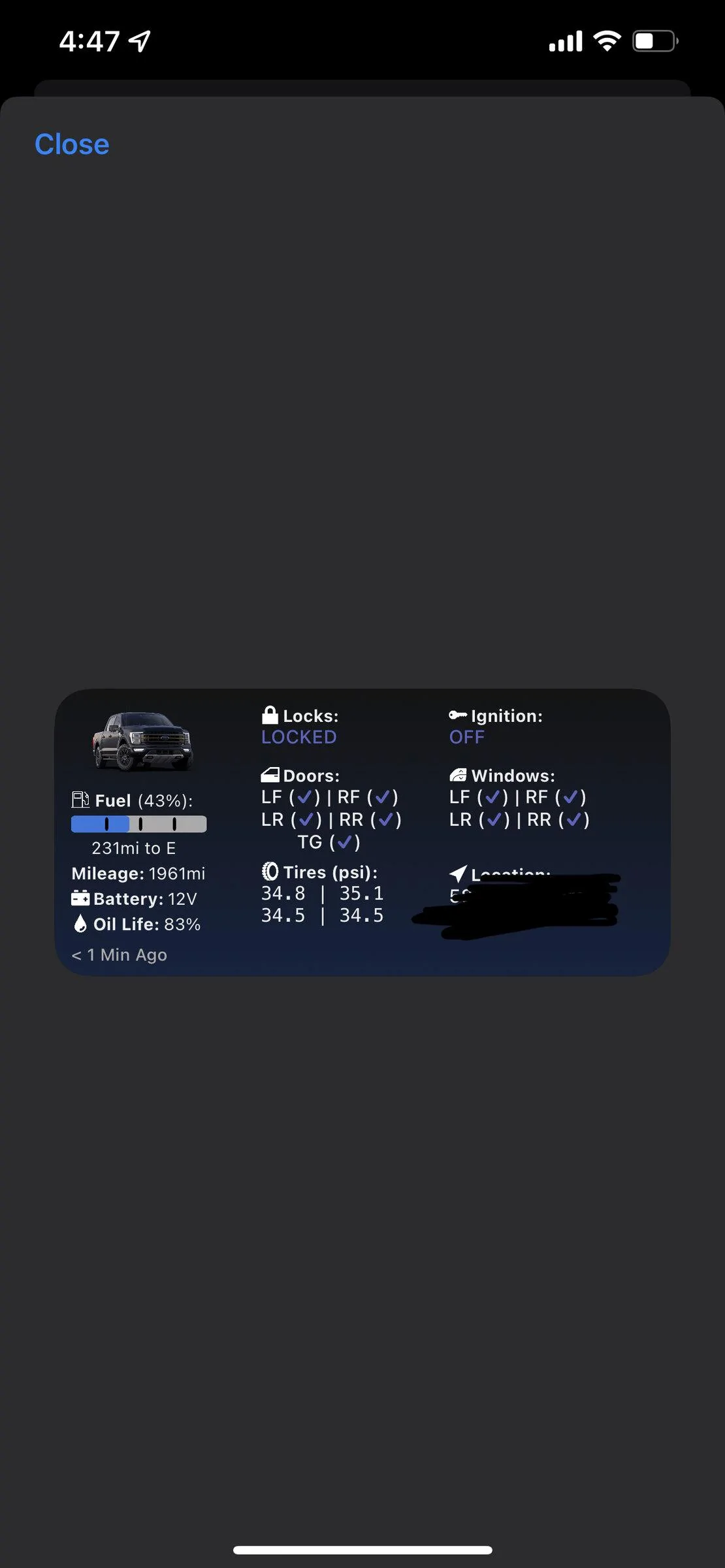

I have copied it and put it in scriptable, when I try to add the widget to my home screen it says alerts are not supported in a widget? in scriptable when i view it it looks right but wont run correctly on my home screen
edit: IDK what I did but now its working on the home screen no clue what changed. So now the only thing I got is it doesnt show all 4 tires in the tire pressure. also my truck is showing unlocked even though i know its locked.
