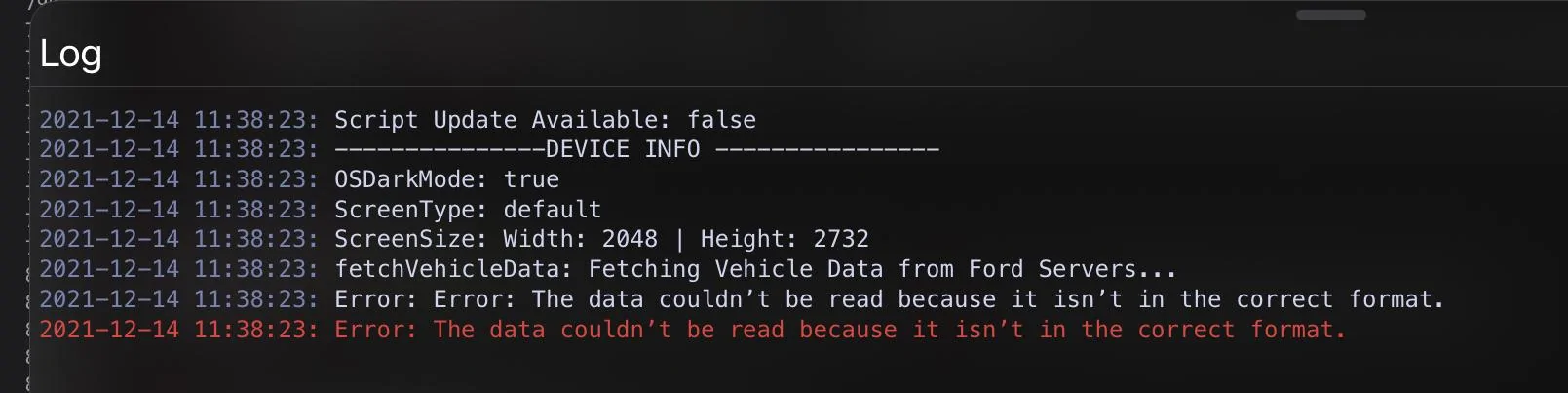

This is badass looking! However, I cannot get past the login. I put in my credentials (even confirmed them several times through my attempts) and still get an error that says "The data couldn't be read because it isn't in the correct format" Any tips on what I'm doing wrong? I'm very tech savvy so I'm scratching my head at what's going on...attached is my log
Am I the only one having this issue? Getting the same results on both iPad and iPhone. Would love some insight.
That’s a new one. These are the issues that are hard to debug with out seeing it first hand.
Let me know how I can help. I can always take a screen recording and send it your way. Also I see you’re in Michigan also. It seems that when the script gets my data from the ford servers it’s not able to interpret it, at least that’s what I’m getting from the logs. And I noticed it didn’t matter if my password was correct either, or if my vin was even valid.
At the top of the script code, what does it show for WIDGET_VERSION?

Sadly still getting the same error :( Ugh. Was hoping I would get lucky with the latest patch
I'm getting the same error. I'm not as tech savvy as either of you but I'm not a tech idiot either.
