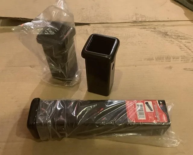

I just bought some receiver hitch stock off ebay, since I plan on welding something up.
The power airdam will indeed interfere with any underslung front hitch. Even if the frame is compatible with prior gen hitches.
I plan to mount mine right where the intercooler goes on the turbo trucks, since I have a V8, I looked underneath and there is plenty of room as well as several mounting possibilities.
My main reason will be for hauling 20’ sticks of steel tubing with a roofrack but it will also be a good option for a receiver mounted winch, bike rack, etc...

Good luck; I want a front hitch for maneuvering a travel trailer in my yard, will wait until the truck arrives, crawl under and see what I can weld up....

I ordered these off eBay, the 12” length was $20 and the pair of 6” ones were $25:
Ford F-150 Lightning Front Hitch for 2021 F150 BF6A9D49-7A7D-492B-B840-E780E085D274
The local steel supplier has blanks but they’re overpriced. I looked for unpainted but painted is fine. I will put up some pictures of underneath the truck next chance I get. I will probably make some measurements too.
