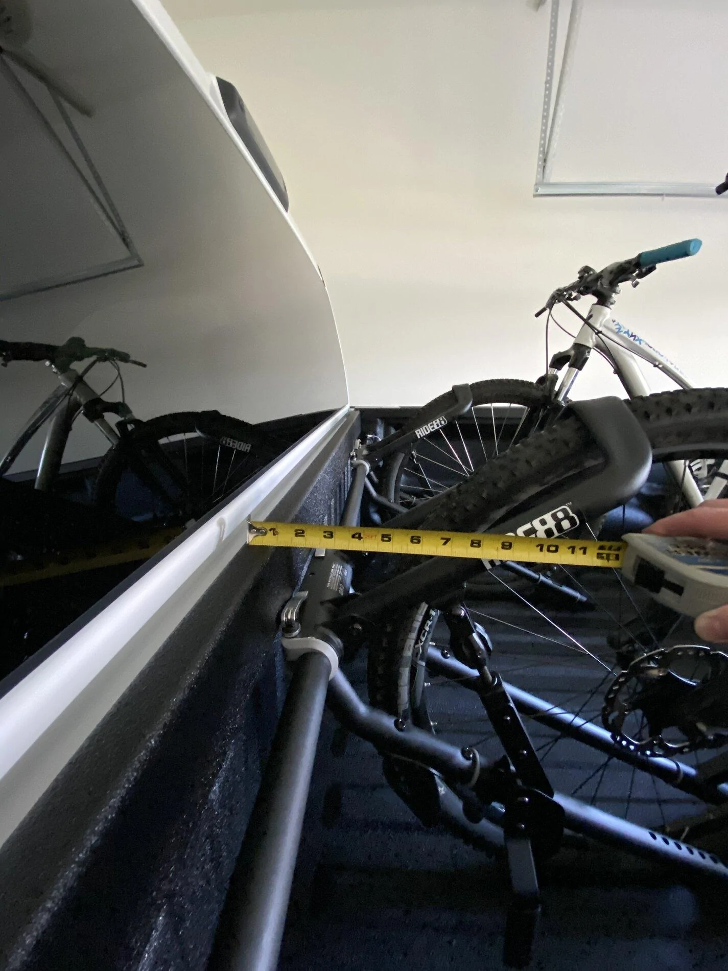

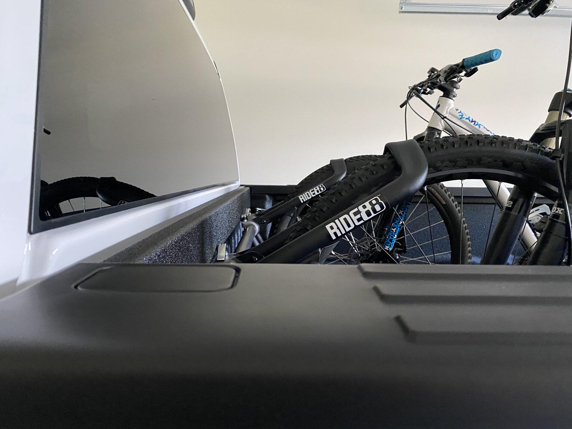

I have more info thanks to @syne7 :cool: ?

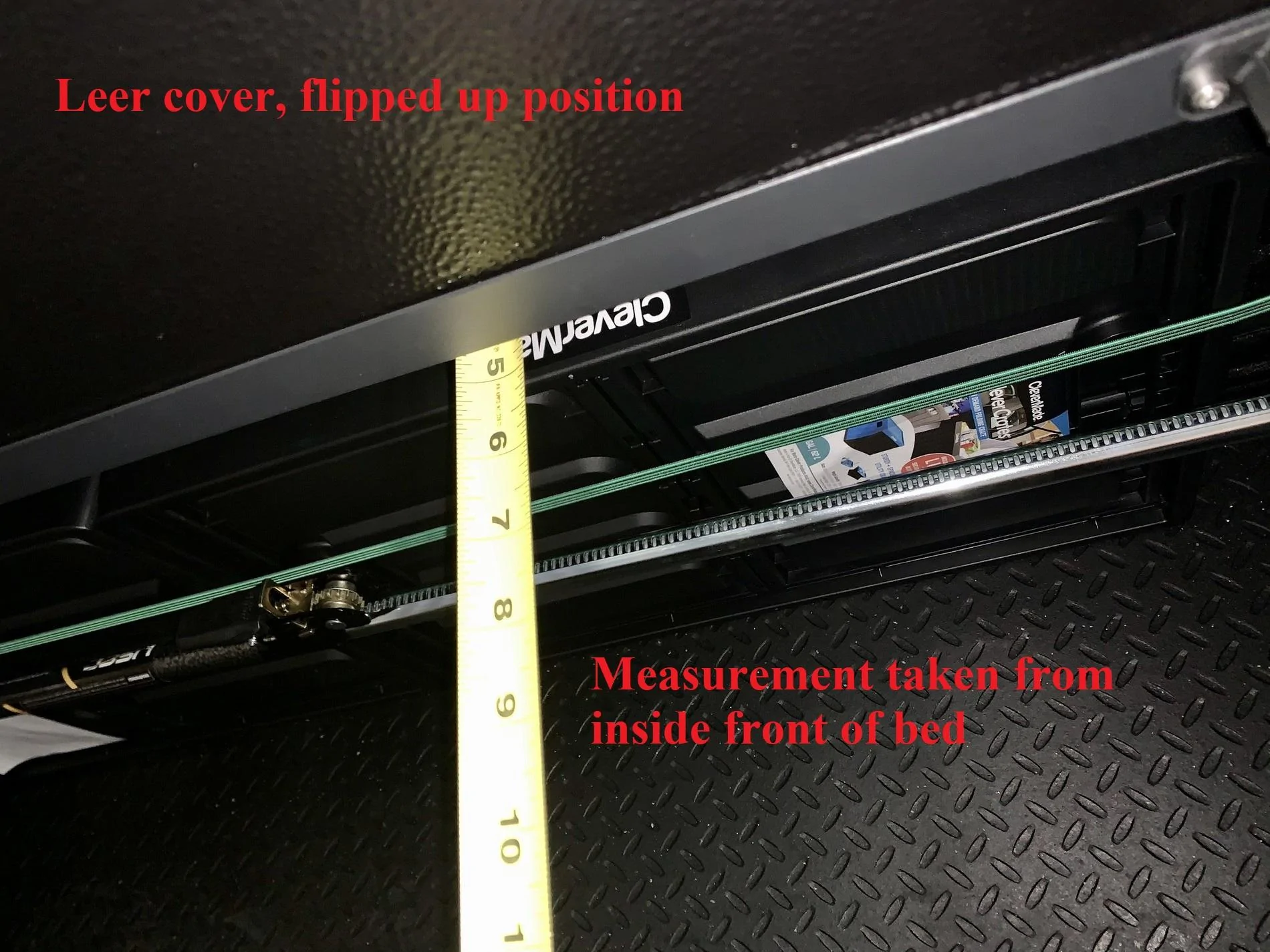

It appears that the Leer HF650M cover in its flipped up and locked position requires approximately 5" of clearance, measured from the front inside of the bed to where the cover ends. Clearance directly below the flipped up cover is not an issue, but anything above the top rail of the bed would need to be at least 5" away from the front of the bed to clear the cover.

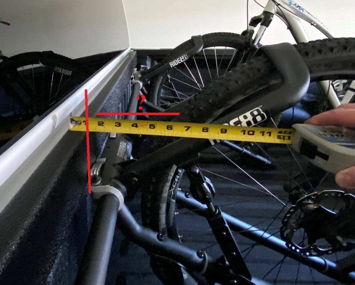

I also realized that in the first picture below, the measurement to determine required clearance of the Ride 88 rack should be taken from the inside of the front bed to either the shorter of 1) Where the front tire extends above the plane of the bed rails, or 2) Where the top tire clamp extends above the plane of the bed rails in it's fully opened position in order to place the tire in the rack.
The first image shows the top tire clamp in its closed position, however the clamp needs to be raised up and towards the front of the bed in order to get the bike out of the rack.
Tire size also comes into play; a 29'r would I think require more clearance due to its larger wheel diameter. I'm also not sure how far up the clamp needs to be raised in order to get the tire out.
The second image shows the required clearance of the Leer cover in its up position, measurement taken from the inside of the bed wall.
Not sure if I'm asking too much, but it'd be great to know if the Ride 88 would work with the Leer cover, and with 29'r bikes, before ordering the rack and finding out it doesn't work.
FWIW, I also have a similar question into Ride 88. Will post if I get any insights from them.
