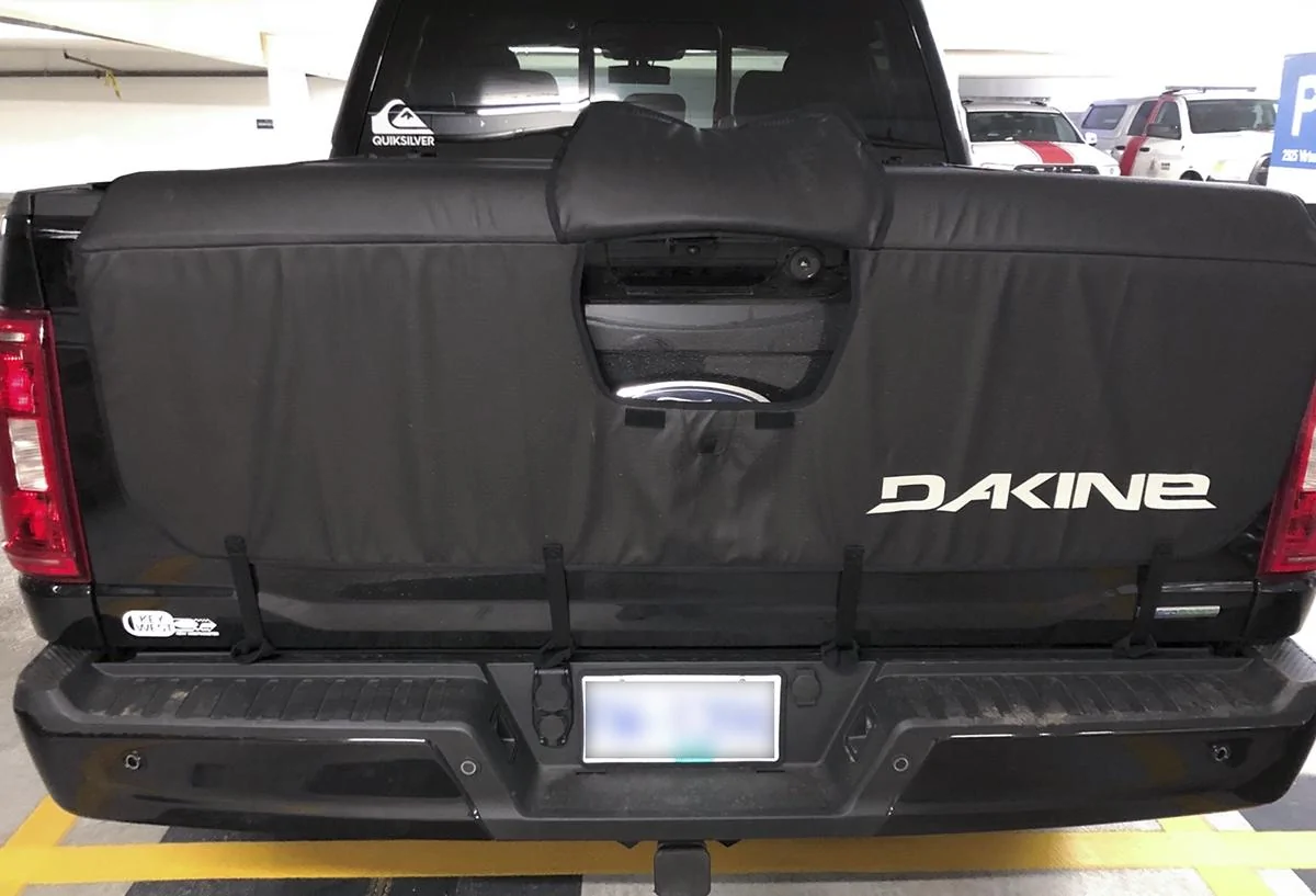

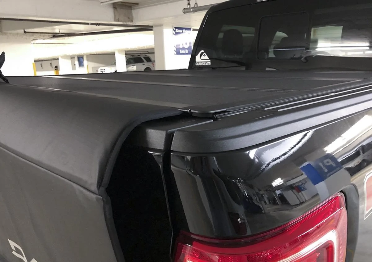

+1 for tailgate pads. This is the primary method of transporting bikes oin trucks up here in Vancouver. I got the Dakine DLX Curve pad (size large) and it's perfect for the new f150s and Rams with the thicker and curved tailgates. Also compatible with backup cameras.
I do a lot of riding with my family and dont really want to take the pad on and off all the time, so thankfully this pad allows my Bakflip MX4 to close while the pad is still on. The rear lip isnt completely flush, but it does close and that's all I care about.
