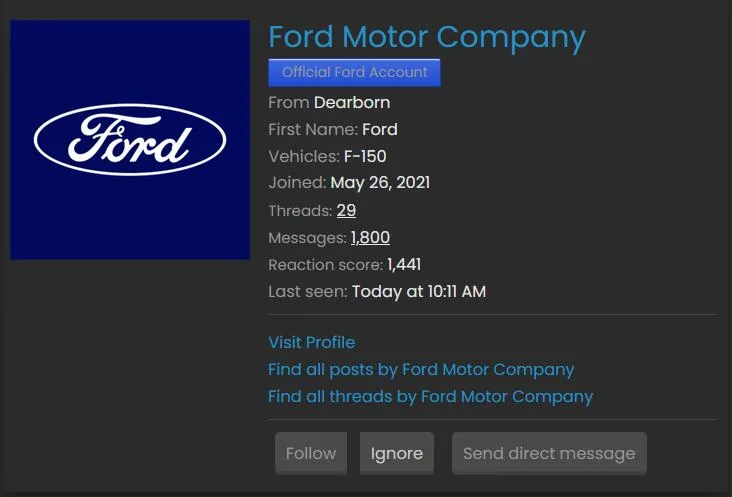

Ford has a presence on this forum. If you perform a search (top right of the page) and enter Ford Motor Company in the "Posted by" field and search, you should get a bunch of threads in which they've posted. If you click on their icon to the left of a message they've posted, you'll get this pop out:
Ford F-150 Lightning Front Parking Sensors CSP Failure 1739486513652-t0
Then click "Send direct message" to um... send them a direct message. They have been pretty good about responding to people who have posted serious issues, but their activity seems sporadic so don't count on an immediate response.
