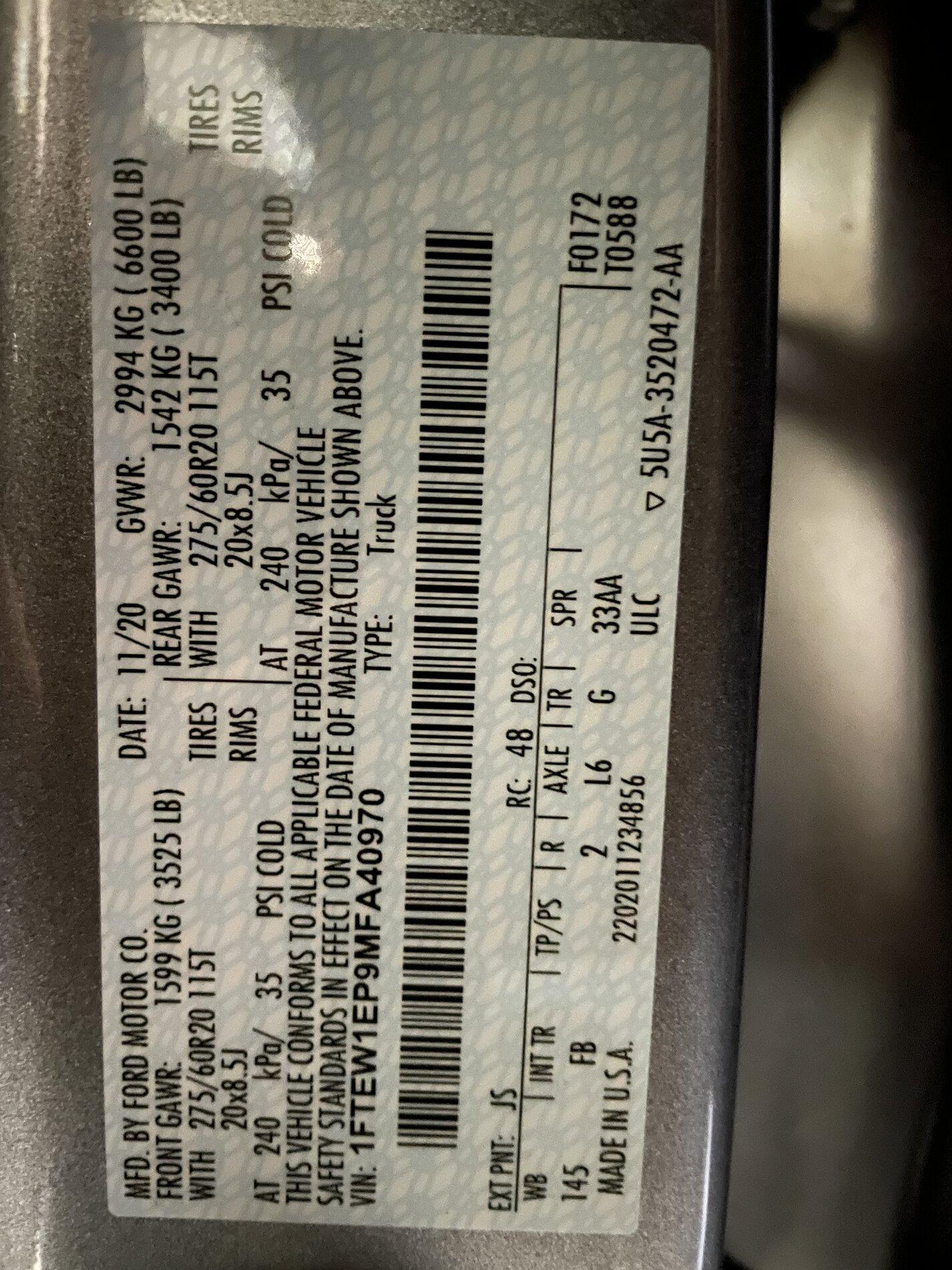

Nice! Can you share the GAWR's on your sticker when you get a chance? That would be super helpful... Maybe we can track the axle ratings vs frames, tow package, and EB/PB/HDPP.

No problemo:
Ford F-150 Lightning GAWR (axle) stickers for regular/max tow and EB/PB 35E1B4D2-B9DA-467E-A053-32429A32BF64
Ford F-150 Lightning GAWR (axle) stickers for regular/max tow and EB/PB 1385782E-04B6-48BD-AED9-BA583D9E48AC

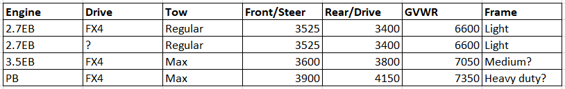

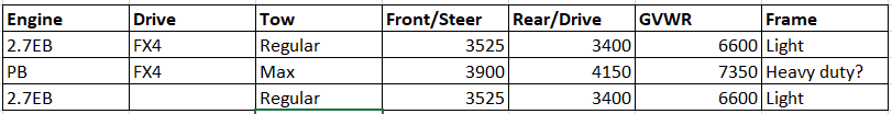

Here is what I have so far, I couldn't find white stickers in scanning a few of the color threads for pics. Need a regular tow PB, and both flavors (regular/max) of 3.5EB to get the full variables. I was tracking FX4 in case the different suspension changes the axle rating (which I doubt but just checking). Also curious if 4x2 changes things but I don't think it will either.
Ford F-150 Lightning GAWR (axle) stickers for regular/max tow and EB/PB 1608700923810

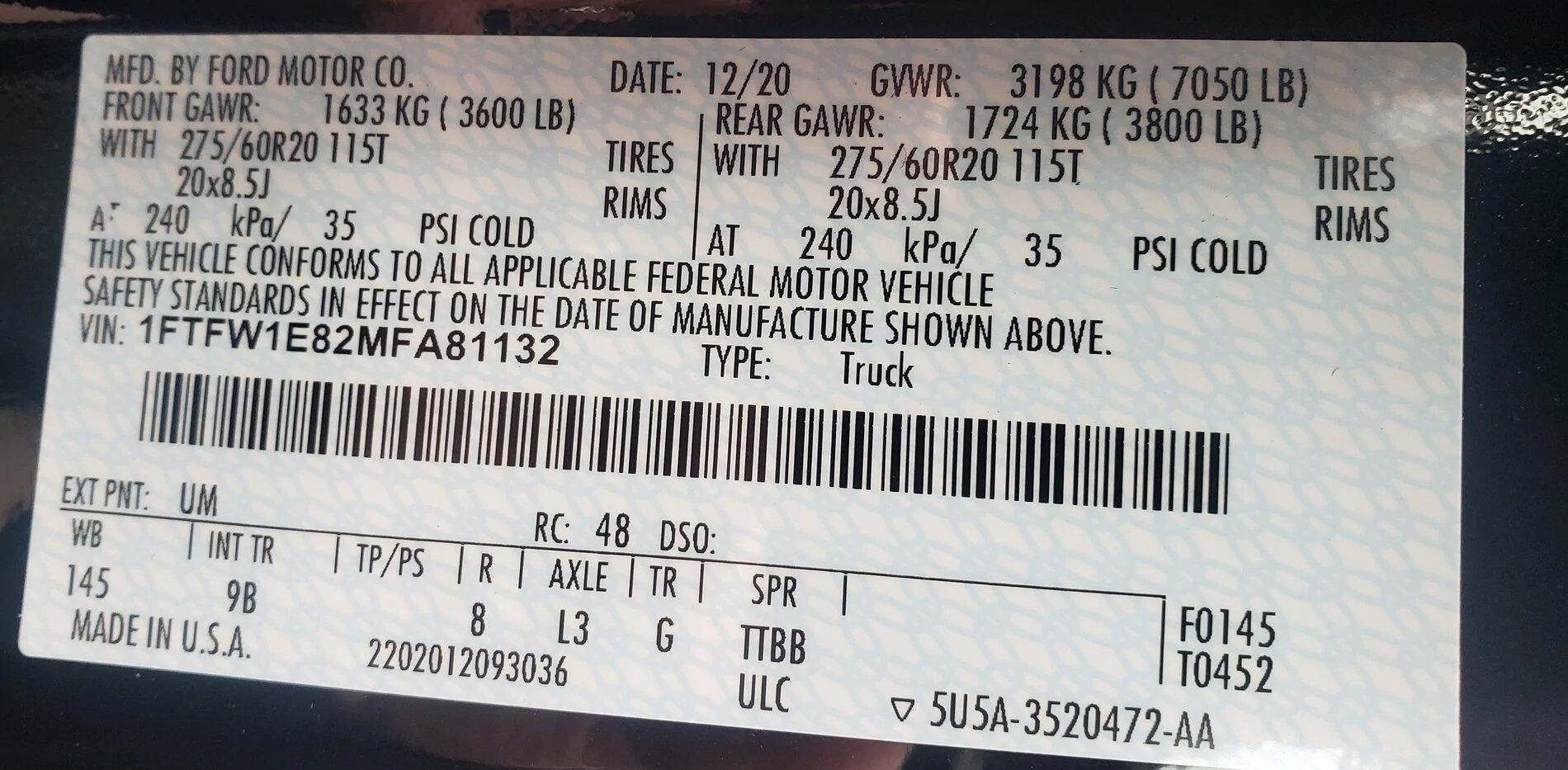

You can add this combo to your list...
Ford F-150 Lightning GAWR (axle) stickers for regular/max tow and EB/PB 2020-12-21 11.44.32
Ford F-150 Lightning GAWR (axle) stickers for regular/max tow and EB/PB 2020-12-21 11.44.23
Ford F-150 Lightning GAWR (axle) stickers for regular/max tow and EB/PB 2020-12-21 11.43.37

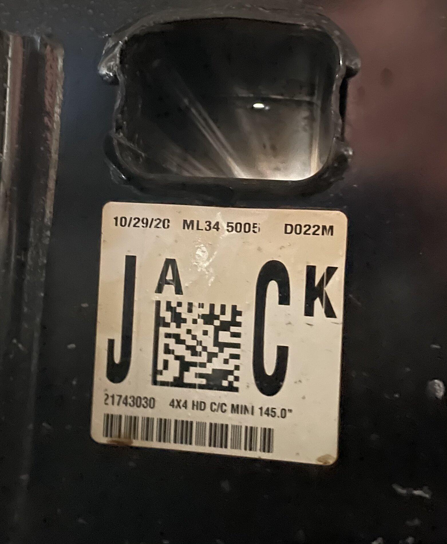

Curious - where is the frame sticker located?
If you look at the area of the frame right underneath of the driver’s door you’ll see the sticker. Kinda tricky to get a picture of it.

Thanks for the new data point! Now we can see the difference between PB and 3.5EB, both with max tow. And the stark contrast to the lighter 2.7EB.
Now if we can just get a "regular" tow for PB and 3.5EB we can check the effect of max tow directly (if any) on axle rating.
What's interesting is that for the PB to get 300# more GVWR rating, they added 300# and 350# to the axles. I'm wondering now if between regular and max tow, it only increases the rear axle and therefore won't bump the GVWR spec, even though the truck is technically a little more robust. I would absolutely feel more safe when porpoising over dips on highways knowing that rear axle has more beef, even if it "hurt" my payload spec on paper.
Ford F-150 Lightning GAWR (axle) stickers for regular/max tow and EB/PB 1608784319045
If someone knows more about which frame these get I can fill that in more confidently.

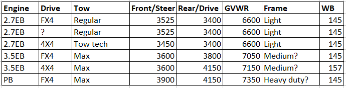

Is the 7300# rating a HDPP and/or a 5.5’ bed? If you can clarify these are 4x4 5.5’ that would be great.
Yes, I got 2 more data points last night after I posted, and one was a 6.5' bed. You can see it has the same rear axle rating as the powerboost 5.5' bed, but not the upgraded front. So far they have all been 4x4 and I'm tracking FX4 as well in case that matters.
Ford F-150 Lightning GAWR (axle) stickers for regular/max tow and EB/PB 1608869515961
