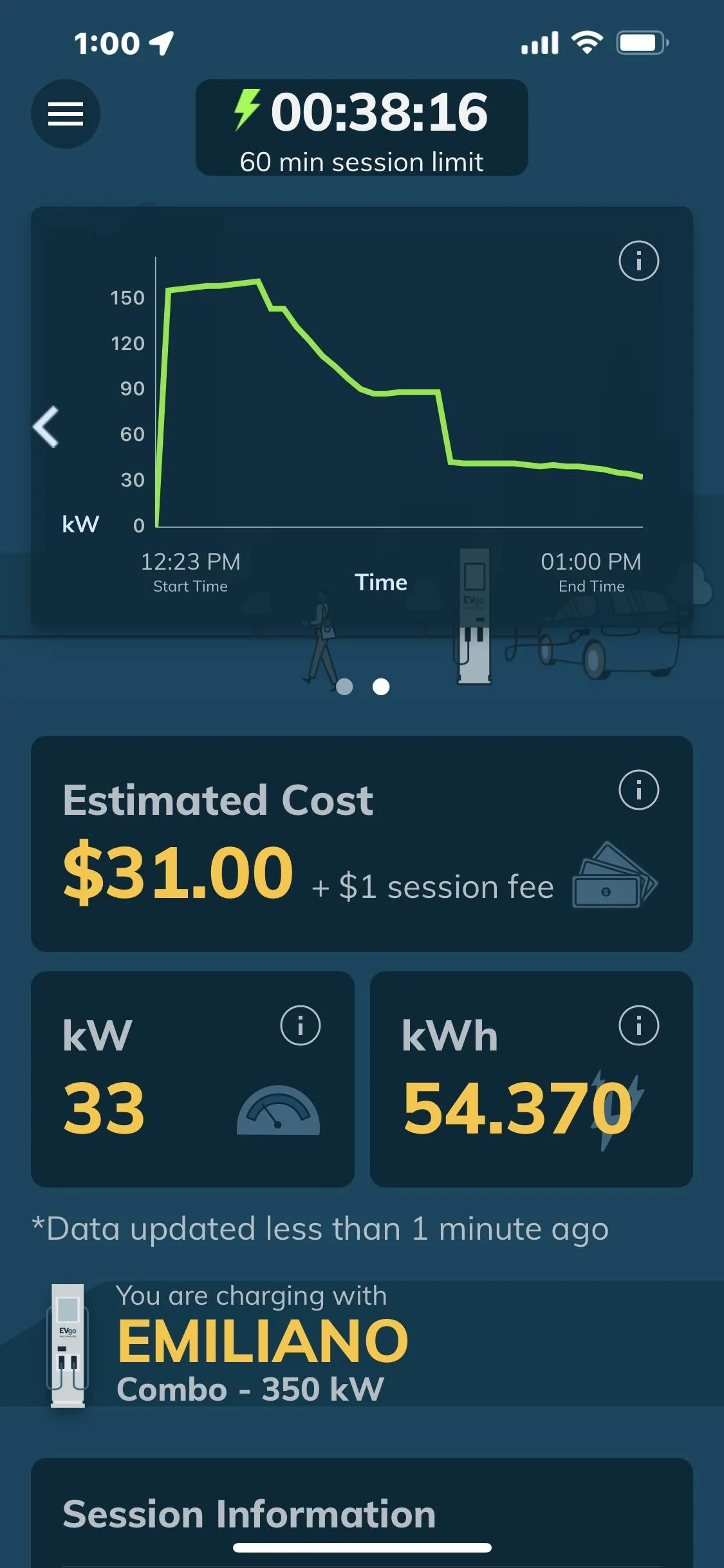

I always have bad luck with EA - their app is awful and not truthful.
They are always full of people waiting in line (free charging for many brands: Mercedes, BMW, Audi, VW, Kia, Hyundai, etc).
Because they are used so much, there are more down chargers than live ones and EA never reports down chargers honestly.
I end up going to EVGo or Shell ReCharge - they have more available and truthful status info on their apps.
Yesterday, at an EVGo 350kW charger, I got 160kW peak charging and went from 38-90% in 40 minutes while I shopped at my grocery store and picked up lunch.
Timing was perfect and was back at my truck before the idle fees started.
