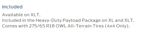

So looking at the builder, adding the HDPP package you get specific 18 wheels with a LT265/70/18 tire. However when you look at the wheel itself it says comes with 275/65/18 tire. Do we know which it is?

It's both; when you add HDPP, you get C load range 265/70R18 tires but when you add the optional HDPP wheels to a non heavy duty payload package 4X4 truck you get the 275/65R18 tires.
My HDPP truck came with General Grabber APT LT265/70R18C tires with a full size matching spare on a matching OEM forged alloy wheel.
I just picked up a spare set of HDPP wheels that were on a truck that didn't have the heavy duty payload package, the tires are Michelin Primacy XC 275/65R18 and the truck came with a steel spare.
Hope that helps!
