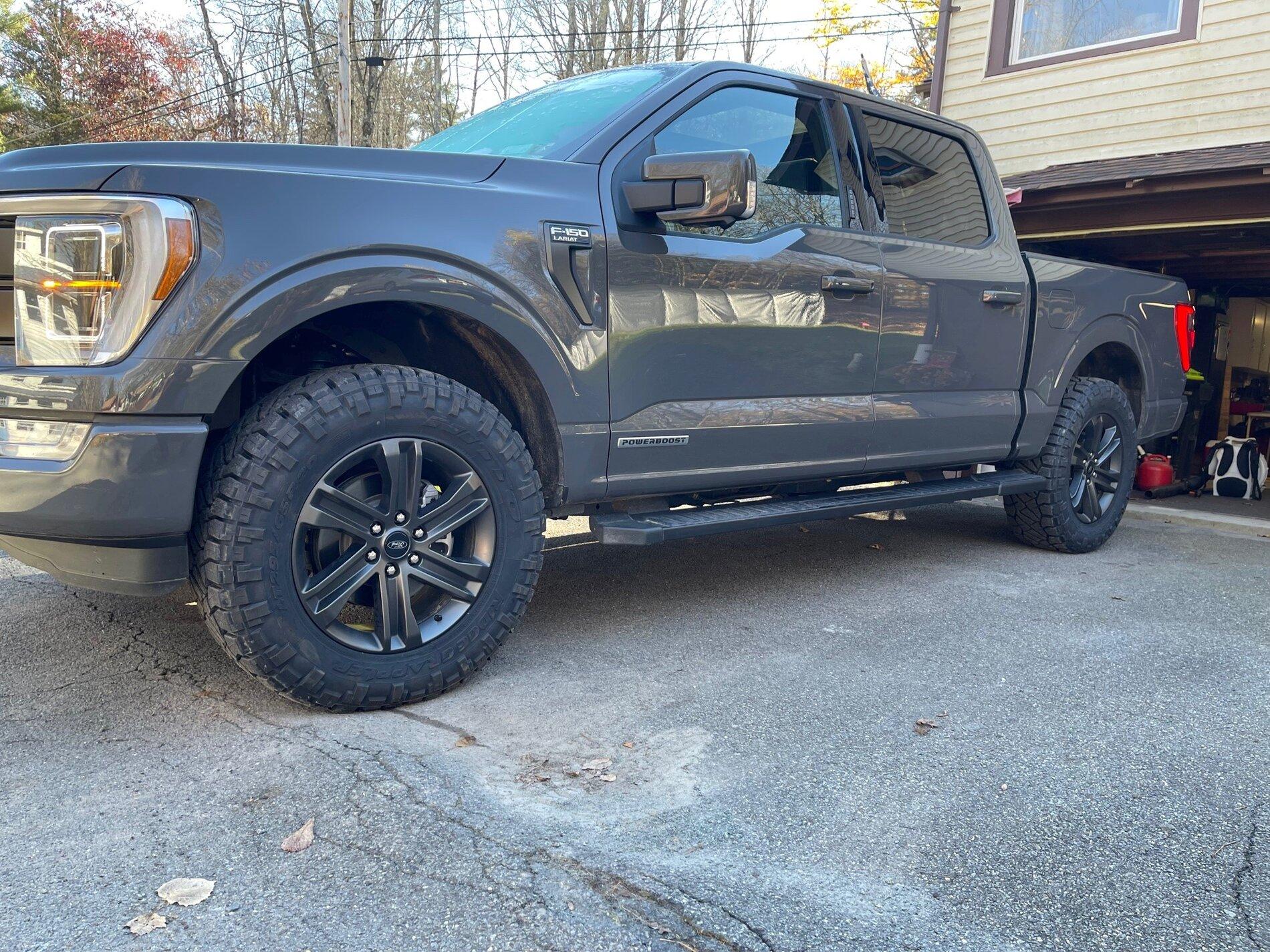

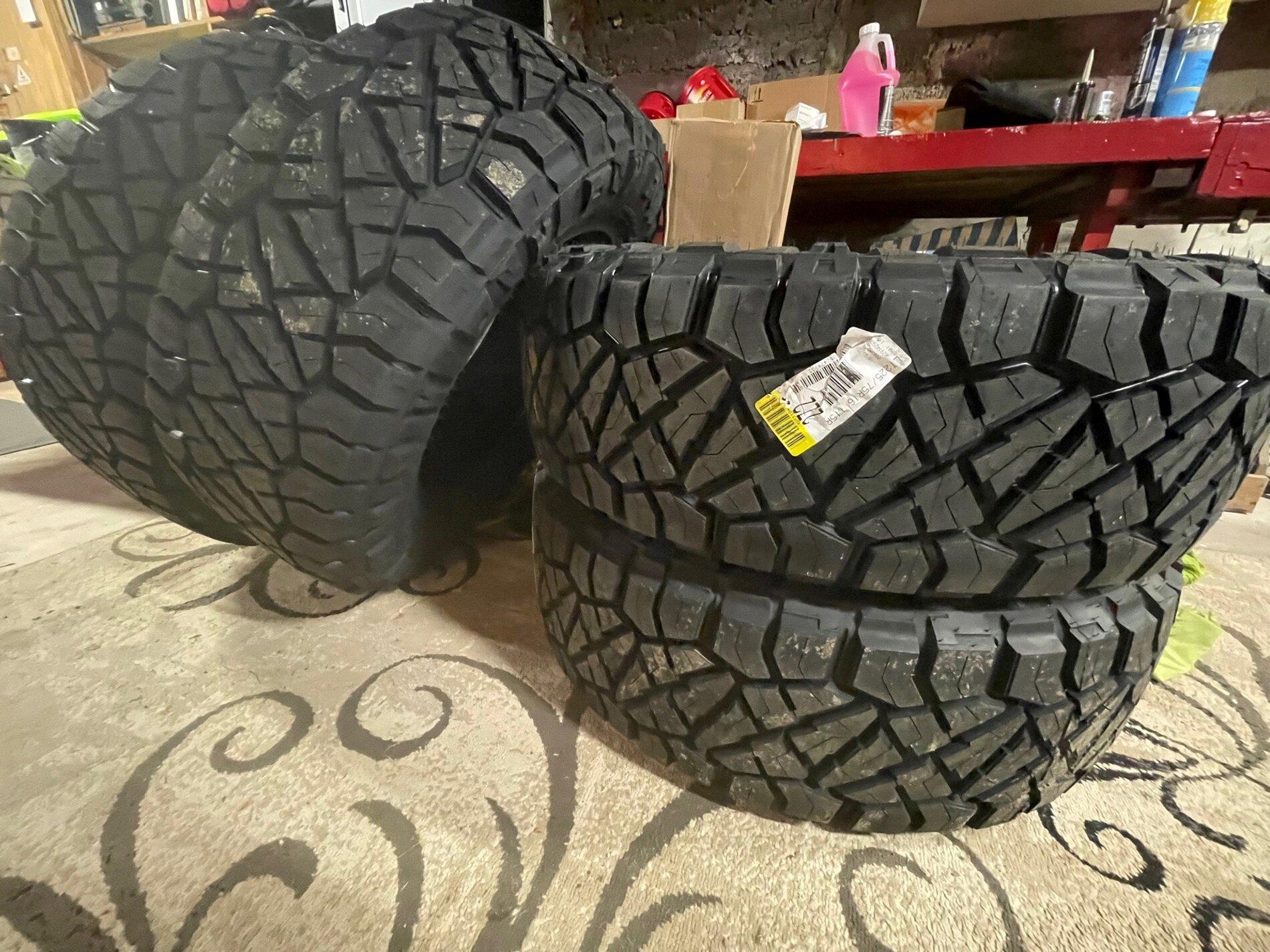

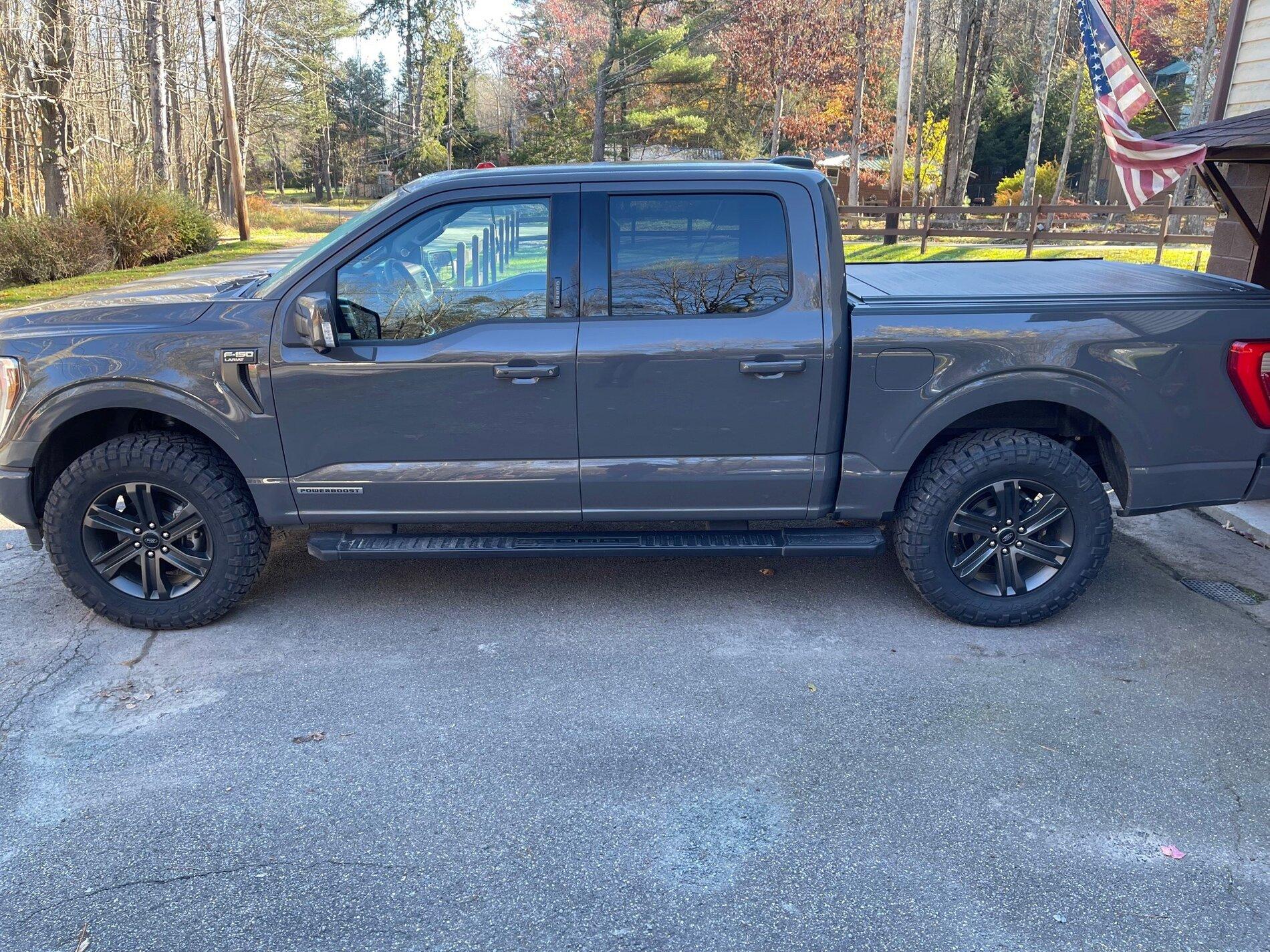

Well I successfully added a 2" Ready Lift level kit and 295/65R20 Nitto Ridge Grapplers with absolutely no rub even offroad. Need help with a tire circumference setting in Forscan for the new rubber to correct my speedo. Anyone else running these with a suggestion? Stock Forscan circumference was 2547, new tires calculated at 2800 but I am now 3 mph off slower. Not sure I should guess and just try 2750??
