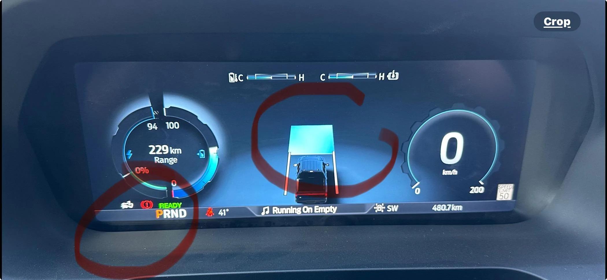

hi there, this is what my dash screen looks like after doing a Forscan modification, I’ve reverted all the settings back to factory as built, and it still shows up this way concerned about the parking break. I’m not sure if the other image the blue square in front of the vehicle was like that prior or not just a new owner not even a week yet. Hope I didn’t screw up too much. Any help would be appreciated. Thanks.

The blue box is supposed to be there.

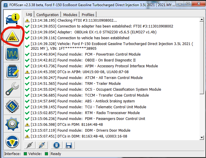

Have you checked for DTCs? Doing FORSCan changes already?

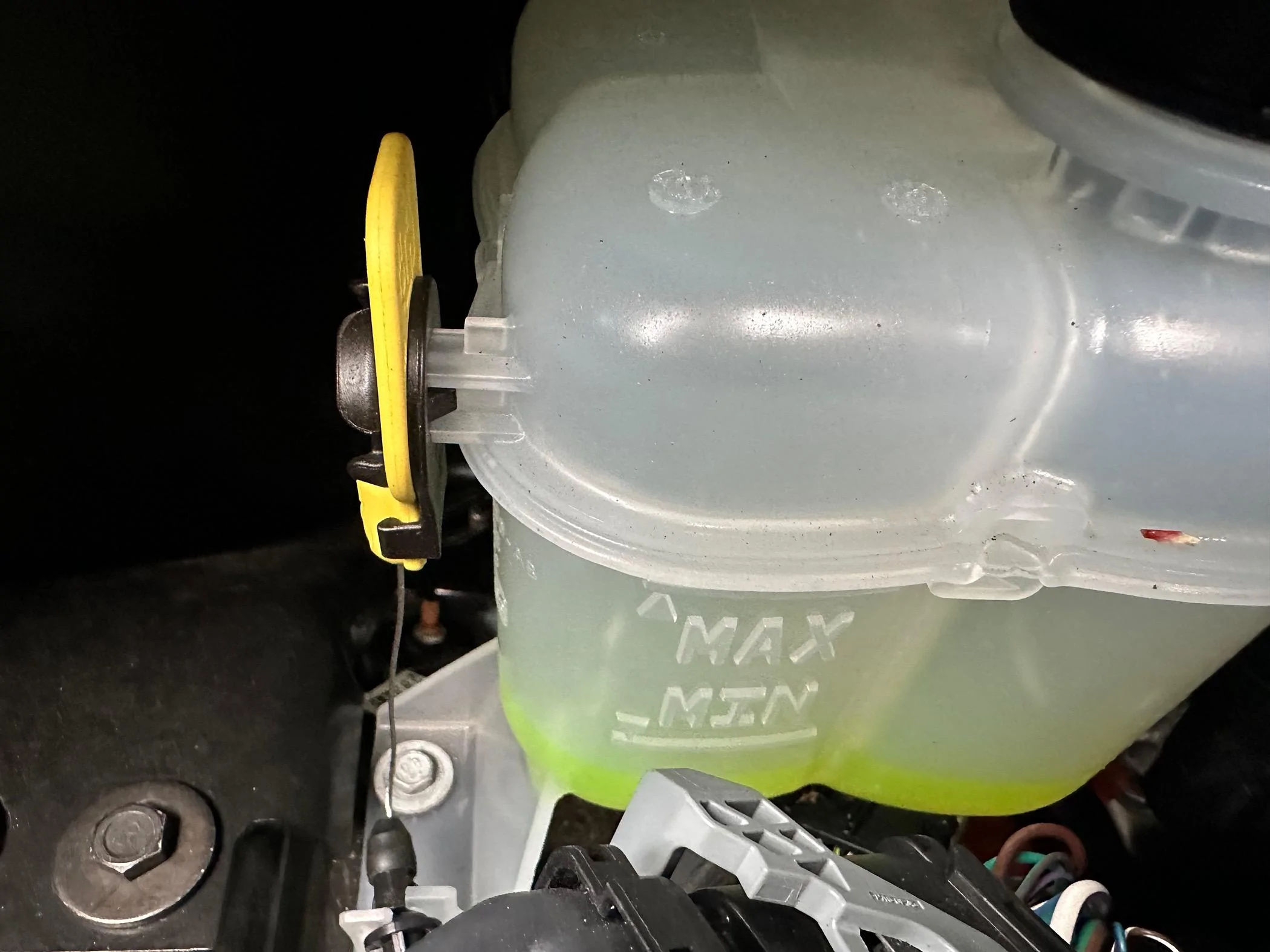

Wonder if this has anything to do with it maybe that’s a brake warning not an E break issue
But I do get a brief break is off screen at start up
I mean, I’ve only had the truck a week today and that’s the level of break fluid??

That photo is the coolant tank. Not brake fluid...(or "break" fluid).

You have to remove the drivers side cover with frunk open to see the brake fluid reservoir.

Oh thanks my bad

What DTC's does FORScan show?

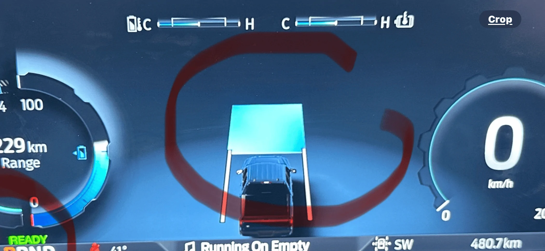

Ford F-150 Lightning HELP - e-Brake Warning after Forscan attempt IMG_8624
can anyone tell me if this image looks correct I seen you remember it not being filled in prior to me messing around?
I already told you it was fine
That is the distance indicator. It shows you if you are too close to the car in front of you. If you don’t like it, you can turn it off in Settings - Driver Assistance
If you don't understand how FORScan works, don't use it. It's not worth bricking your truck. Always back up the As-Built files before making any changes, especially since Lightnings are connected vehicles. When you make changes, they sync to the cloud, and as a consumer, you can't recover the previous files.
