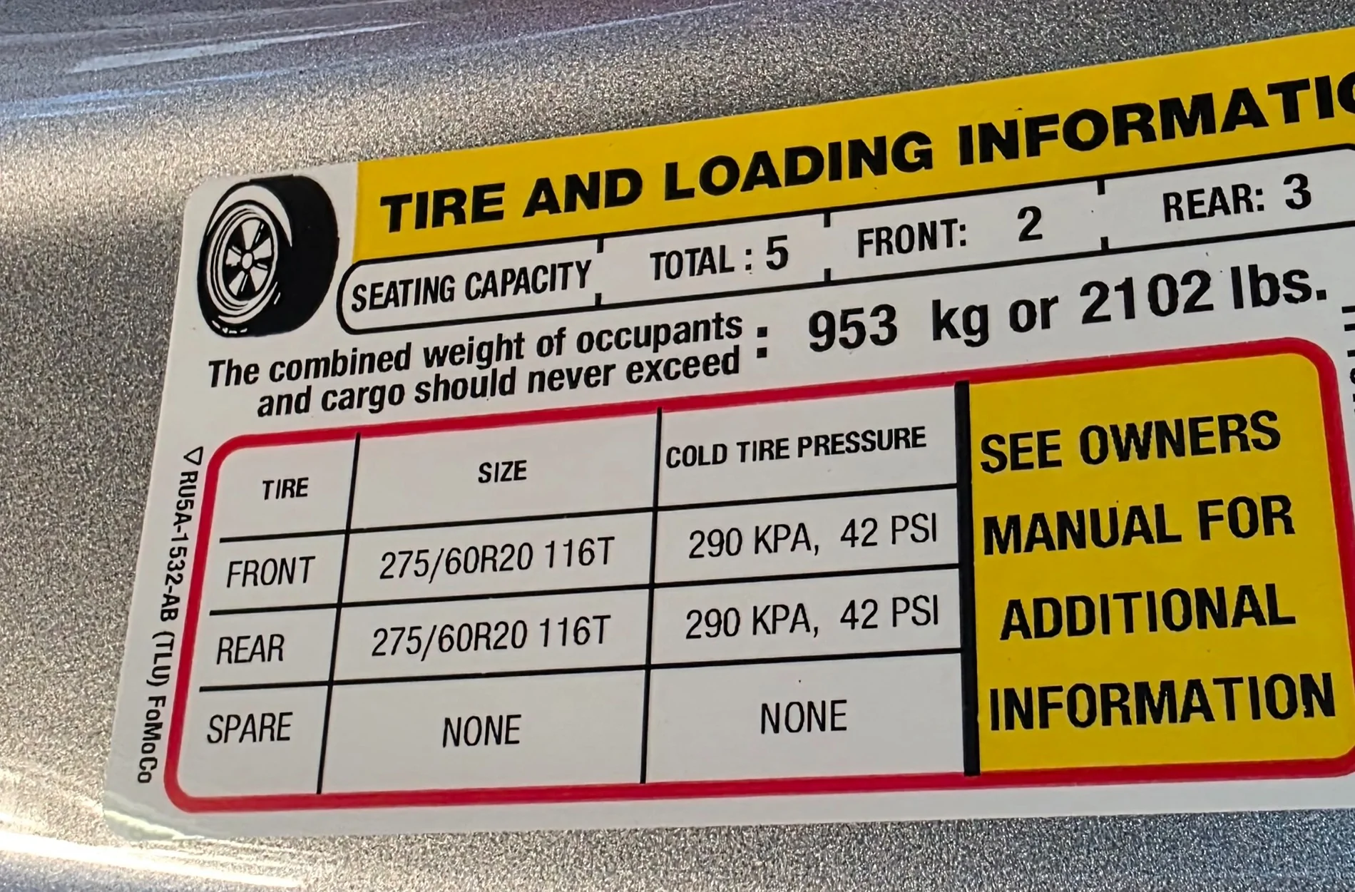

**Shopping for wheels/tires, this applies to all vehicles, not just our truck**
Look at your VIN sticker to identify your minimum weight support (below are actual examples from mine):
Total GVWR = 8400 LB
Front GAWR = 3940 LB
Rear GAWR = 4800 LB
When looking at Discount for example, you want to check the "Load Capacity" of a wheel.
Here's a spec from my actual wheel (yep, they are heavy):
Ford F-150 Lightning Help identifying if these will work with Lightning - 18" take offs tr33
So, from these specific 4 wheels, I support 10000 LB total (or 2500 @ each location, or 5000 at front & back). These amounts are higher than the GVWR & GAWR amounts from the VIN sticker, so this setup supports the minimum....good to go.
Next, look at the Tire and Loading Information stickers (yellow examples above). Take notice of the number to the right of the tire size), in this case, 116T. On your new tires, same thing, you want 115T (example from mine) at a minimum.
The numbers are the load rating, and the letter is the speed rating. You (should) need at minimum, the 115 or 116 (or higher). The speed should also be the same but can go lower or higher. For example, my OEM tires were T, for max speeds of 118 mph. My new ones are 117S, for max speed of 112 mph (and 117 load being higher than 115).
