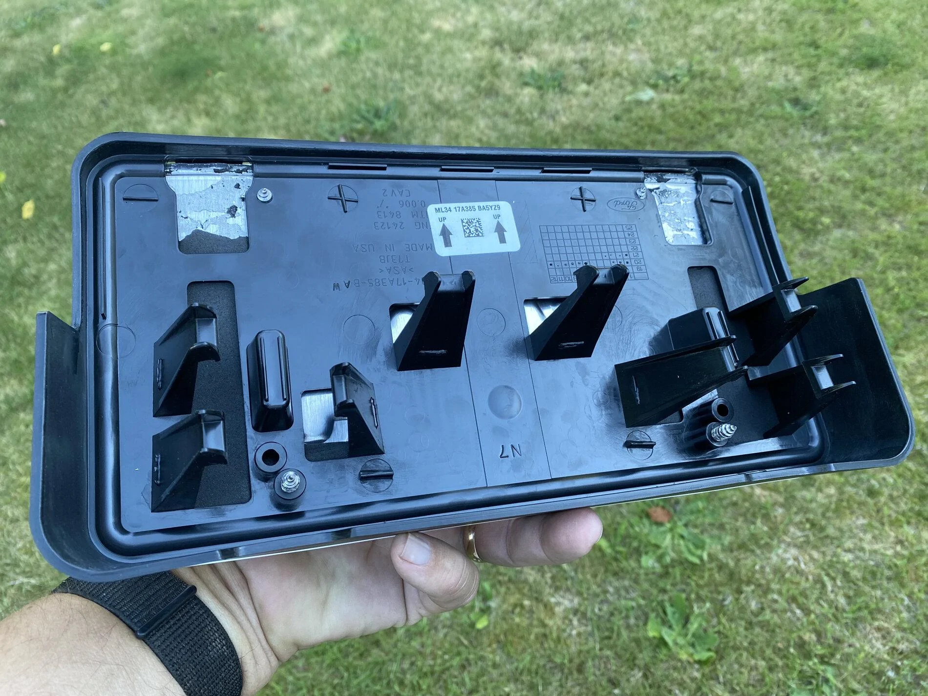

Closing this out, for my '21 Lariat the bracket is 'captured' by 3 sets of plastic prongs. Left side, right side and biased towards the top in the center. A flat-edged screwdriver was the tool that worked for me in pushing those brackets aside and allowing them to release the bracket. The video Scott provided does relate to '21 F150's as well. I suspect it's for models that don't have the lowering front air dam, as that assembly prevents access to the back side of the grill as shown in the video.

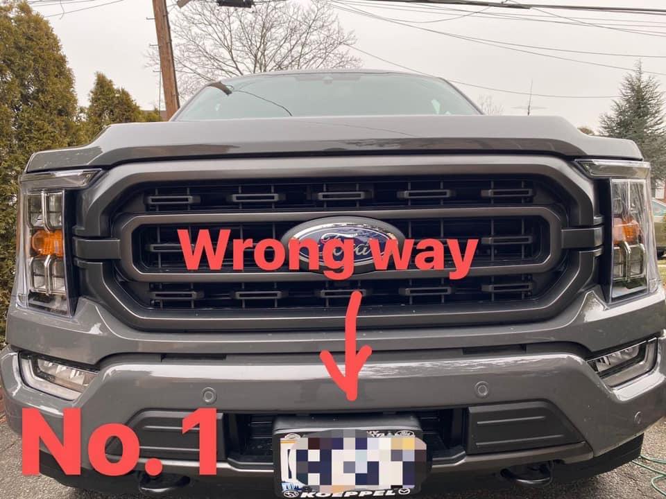

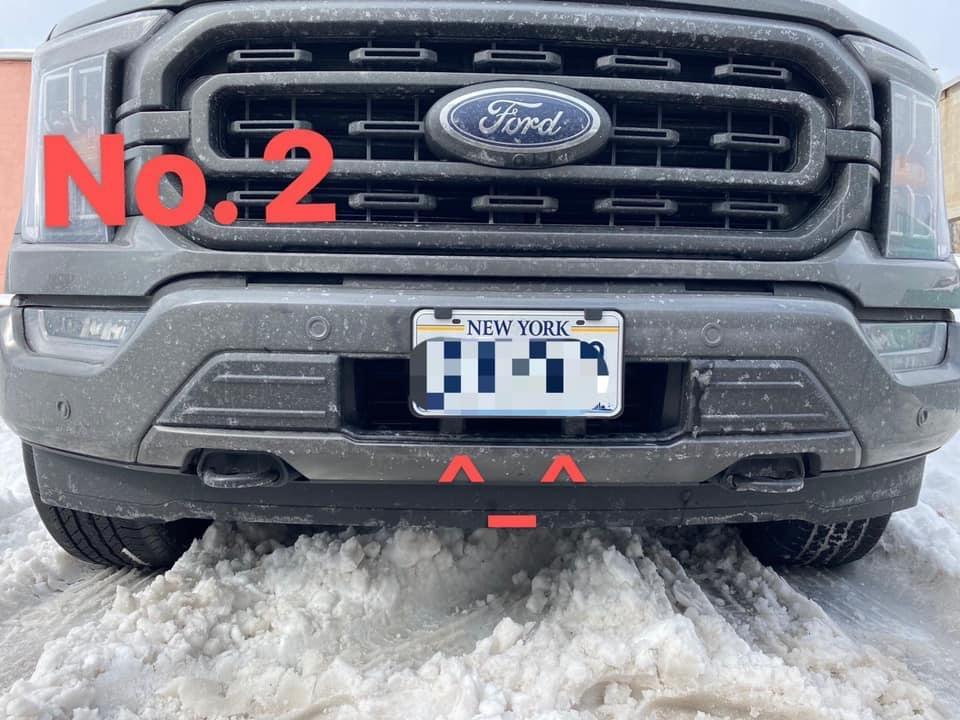

Not entirely sure myself, but double check which way yours is mounted. If it’s incorrect, it may be more difficult to get off.
This was posted by another user a few months back as far as the right and wrong methods:
Ford F-150 Lightning How about getting that front license plate bracket off? F07D364C-312F-4A14-A59E-343040806AB9
Ford F-150 Lightning How about getting that front license plate bracket off? 66E15593-C0FA-4203-A1DB-DD137D53C61B

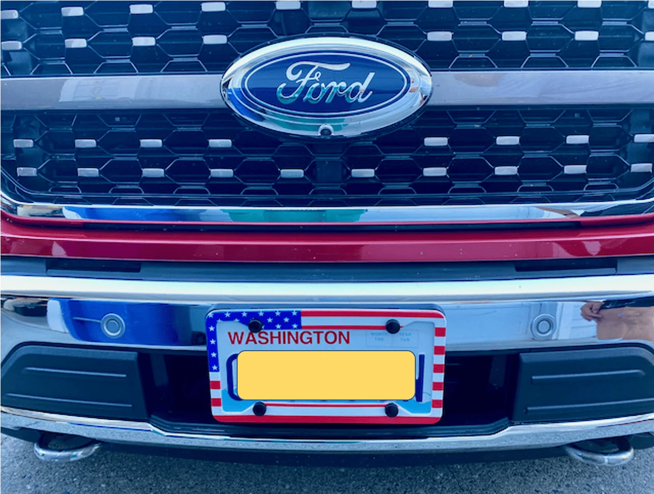

Here's what the front license plate bracket looks like for a 2021 F-150 King Ranch PowerBoost. It just snaps into place, and then you slide it UP into position. (Notice how the frame is cut out around the top, so it will slip up over the front bumper.)
Ford F-150 Lightning How about getting that front license plate bracket off? IMG_0867
I had to buy one because I bought the truck in Phoenix, but licensed it in Washington. The local parts man said, "that's never been a problem, because no one ever buys a truck in a different state." The bracket cost about $35. He had to know my VIN to specify the correct bracket. Apparently there are a lot of variations throughout the 2021 F-150 family.
