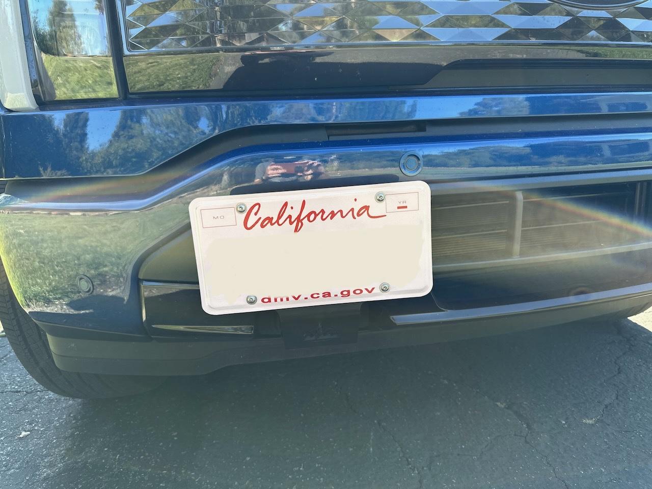

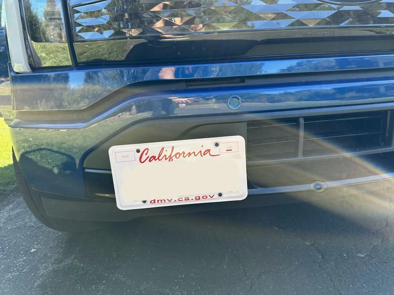

Besides the ultrasonic sensor are there any other sensors in that area? Cruise control radar or anything else? I'm thinking of getting the Swarfworks and figuring out a way to lower it another inch or two.
I’m not sure if there are other sensors. I can tell you that Blue Cruise and adaptive cruise control worked even before I adjusted the mount to face toward its left side.

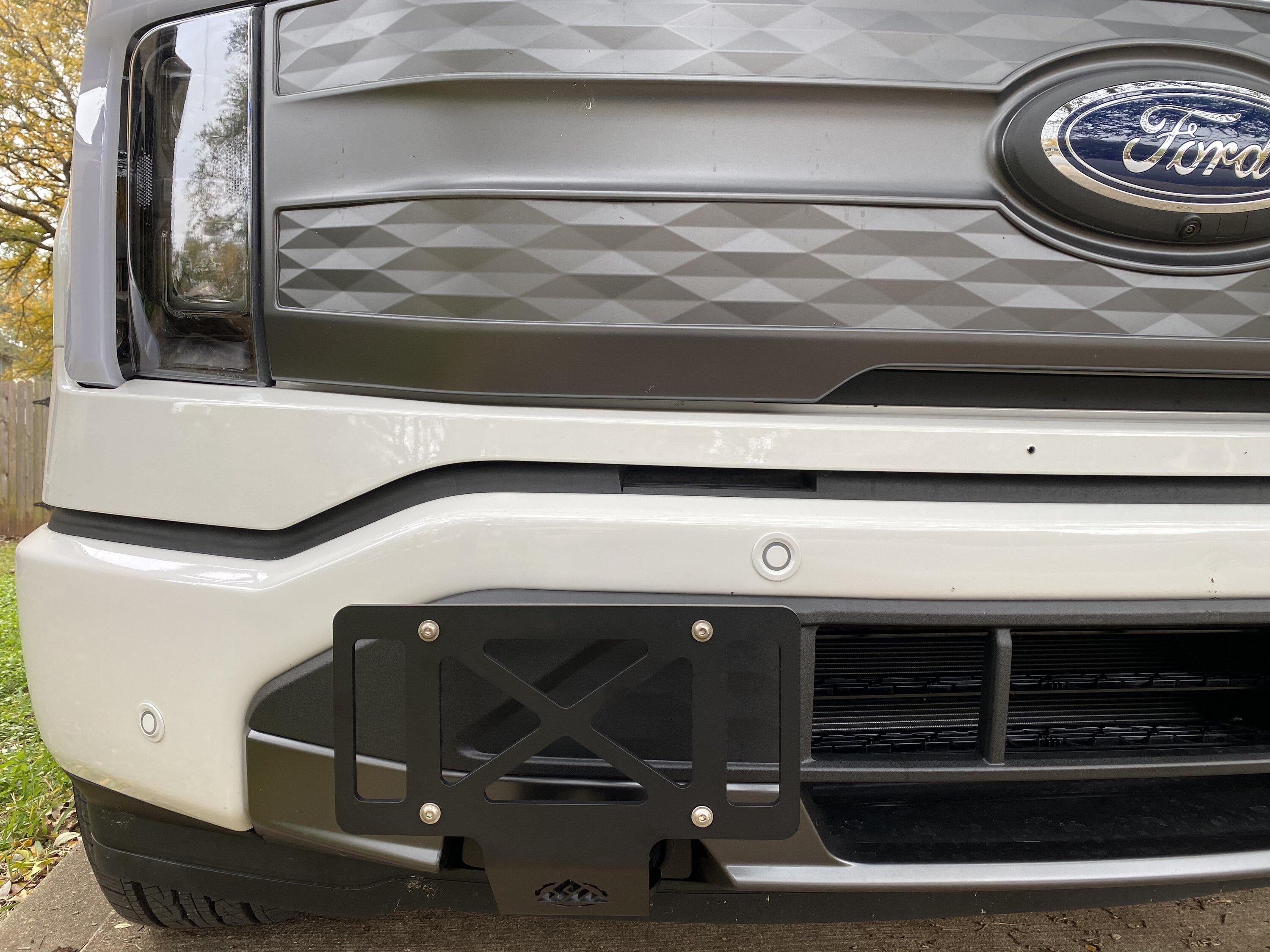

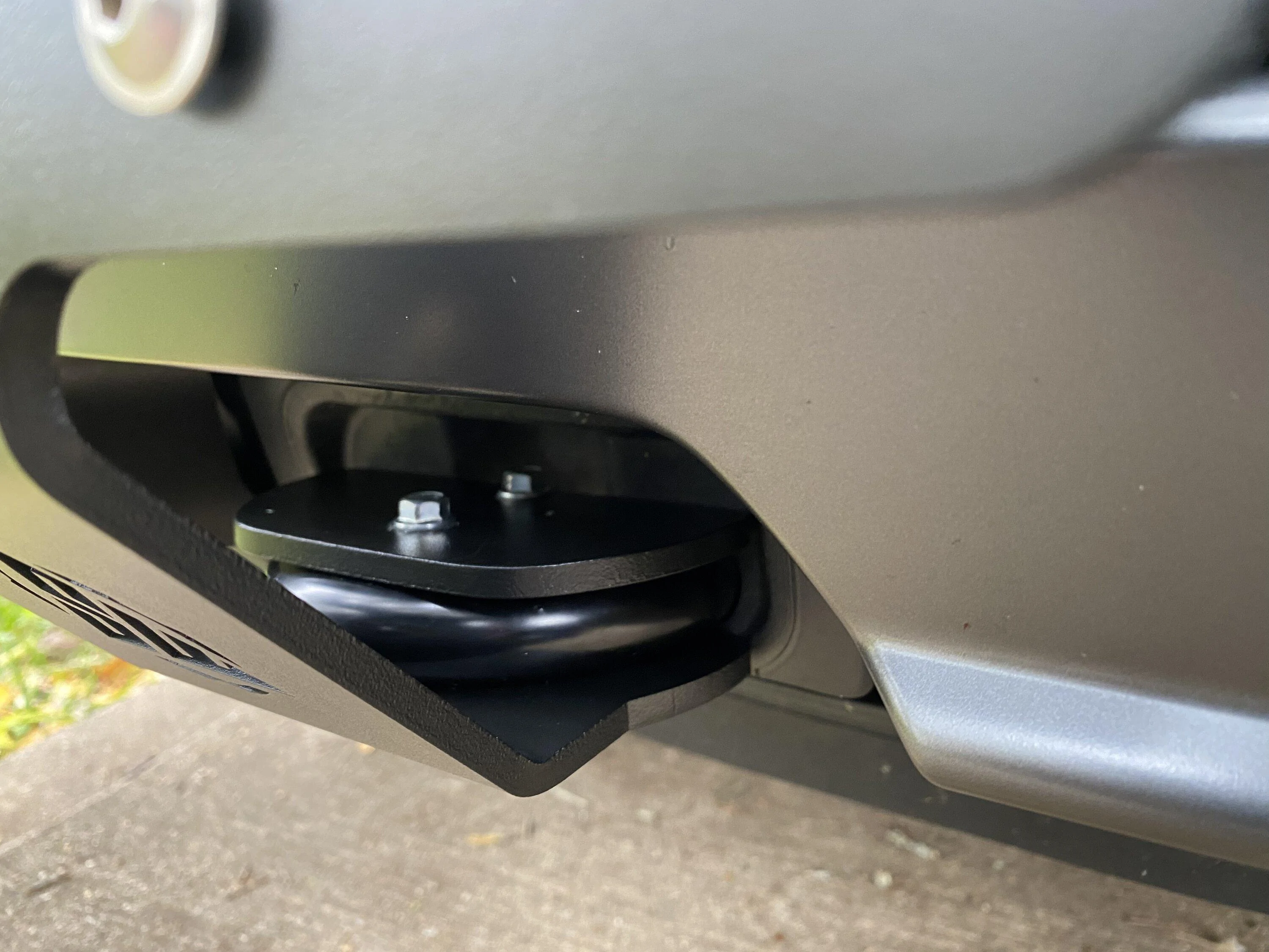

I had my Swarfworks mounted just like this before receiving my plates. Parking sensors only started going off after I mounted the plates. The license plate is only a few millimeters bigger than the mounting plate so it was bizarre. Had to position the mounting plate turned towards the driver as much as possible. That stopped the sensors from going off but doesn’t look the best. Emailed Swarfworks about it but no response. Might as well drill.
Darn. You're right. I just threw an old plate on and it triggers the parking sensors. I'm thinking I may buy some longer bolts and fabricate a 10mm plate to drop it down even lower.

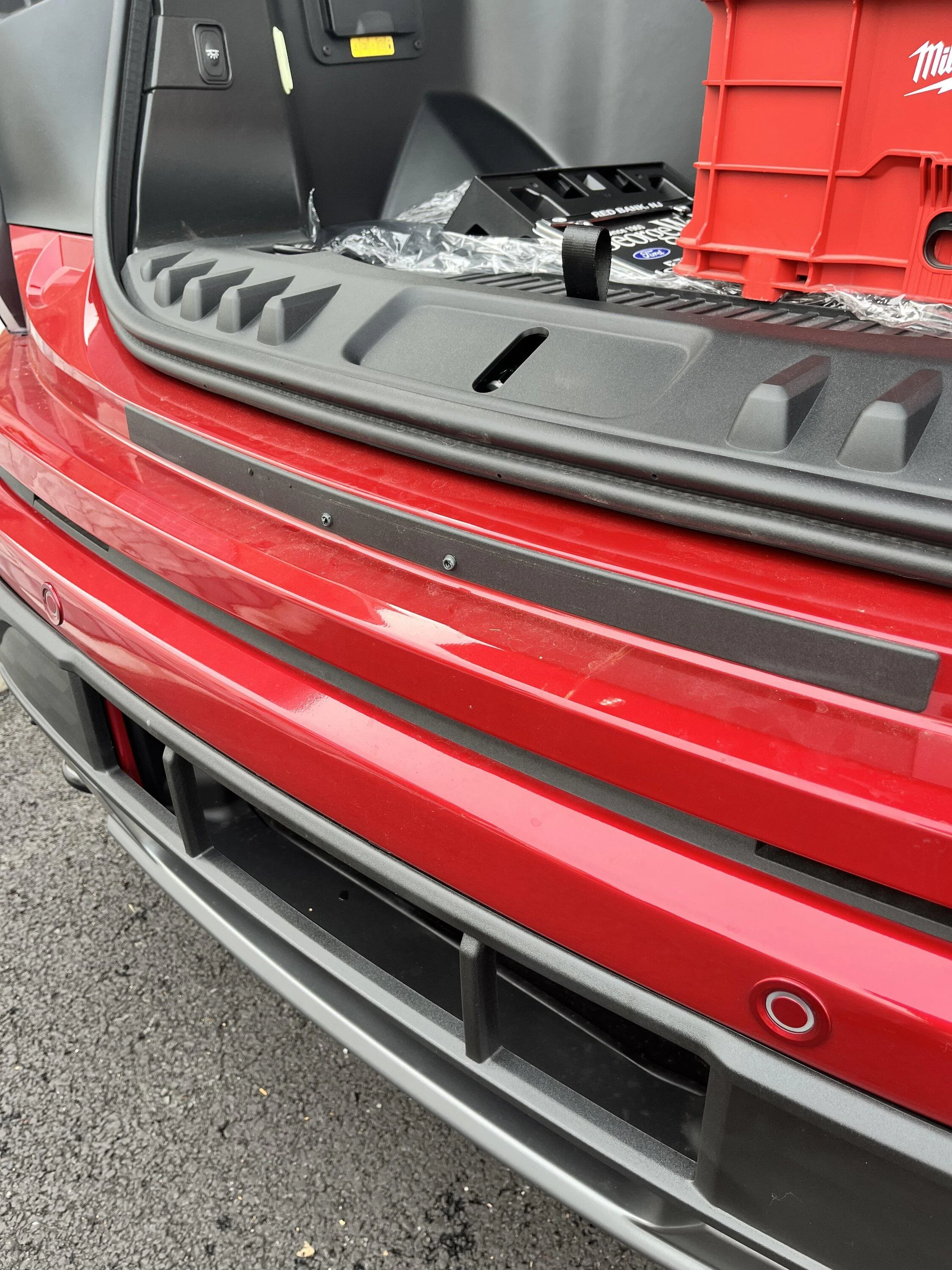

Took off my front plate (dealer drilled through before I can tell him not too). Anyone know if this trim piece is glued and can be ordered to get rid of the holes?

cheap fix is just put 2 black screws into it
or take a large 1/2-3/4" drill bit and use it to take the slag off and no one but you will notice the holes.
Any luck with info on that trim piece or even the part number?

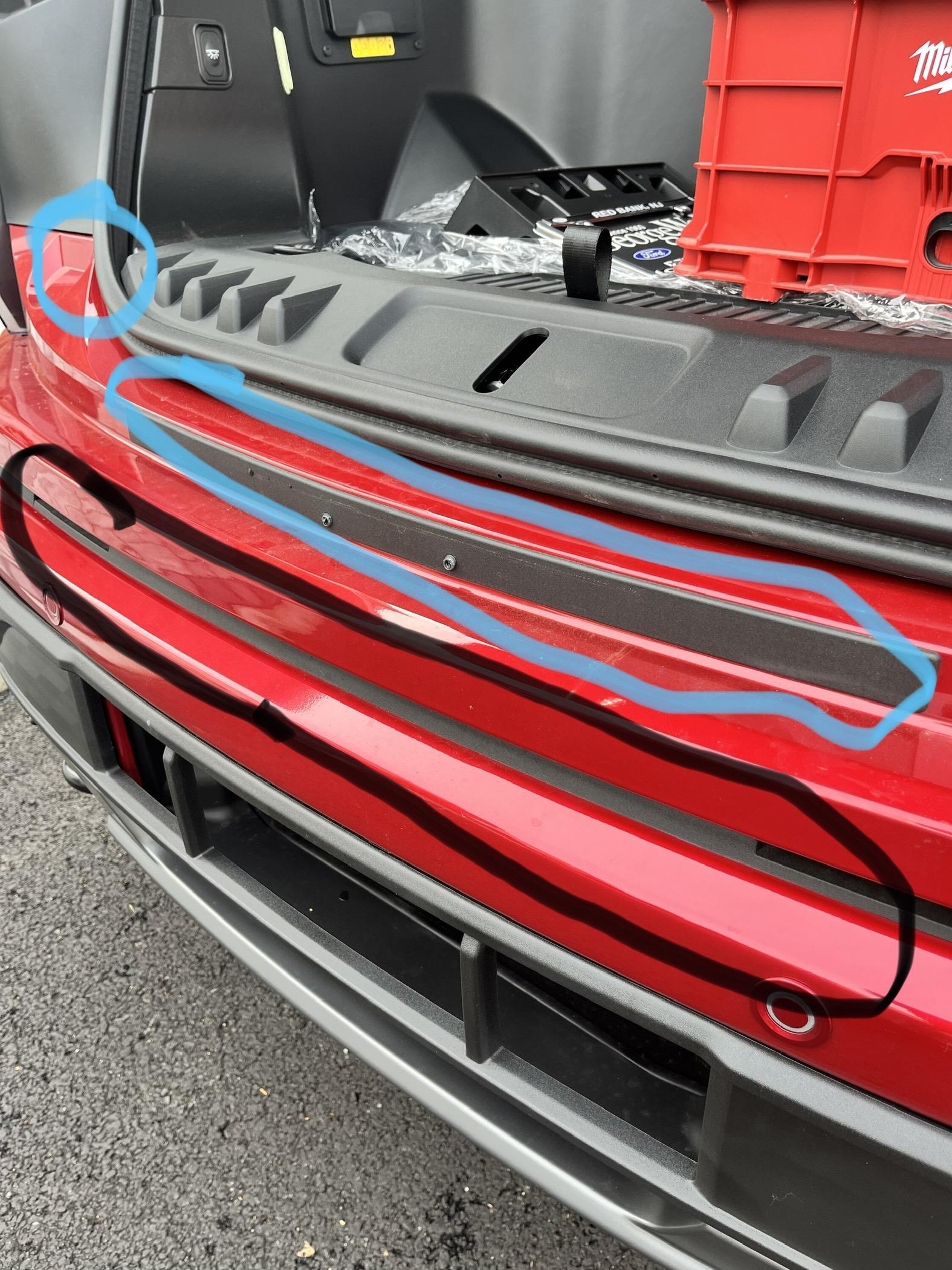

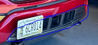

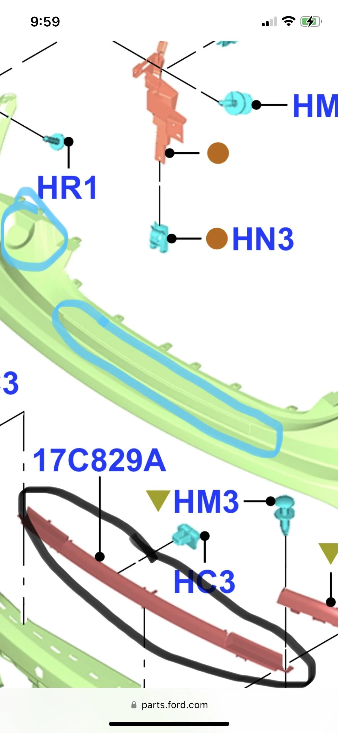

Looking at the screenshots I think it’s part of the bumper. At least from ford. I wonder if @BestEvMod could make a replacement. It would be nice to cover this up as I also have holes from a front license plate that the dealer installed before I got the truck.

Good eye, I retract my previous guesses!
