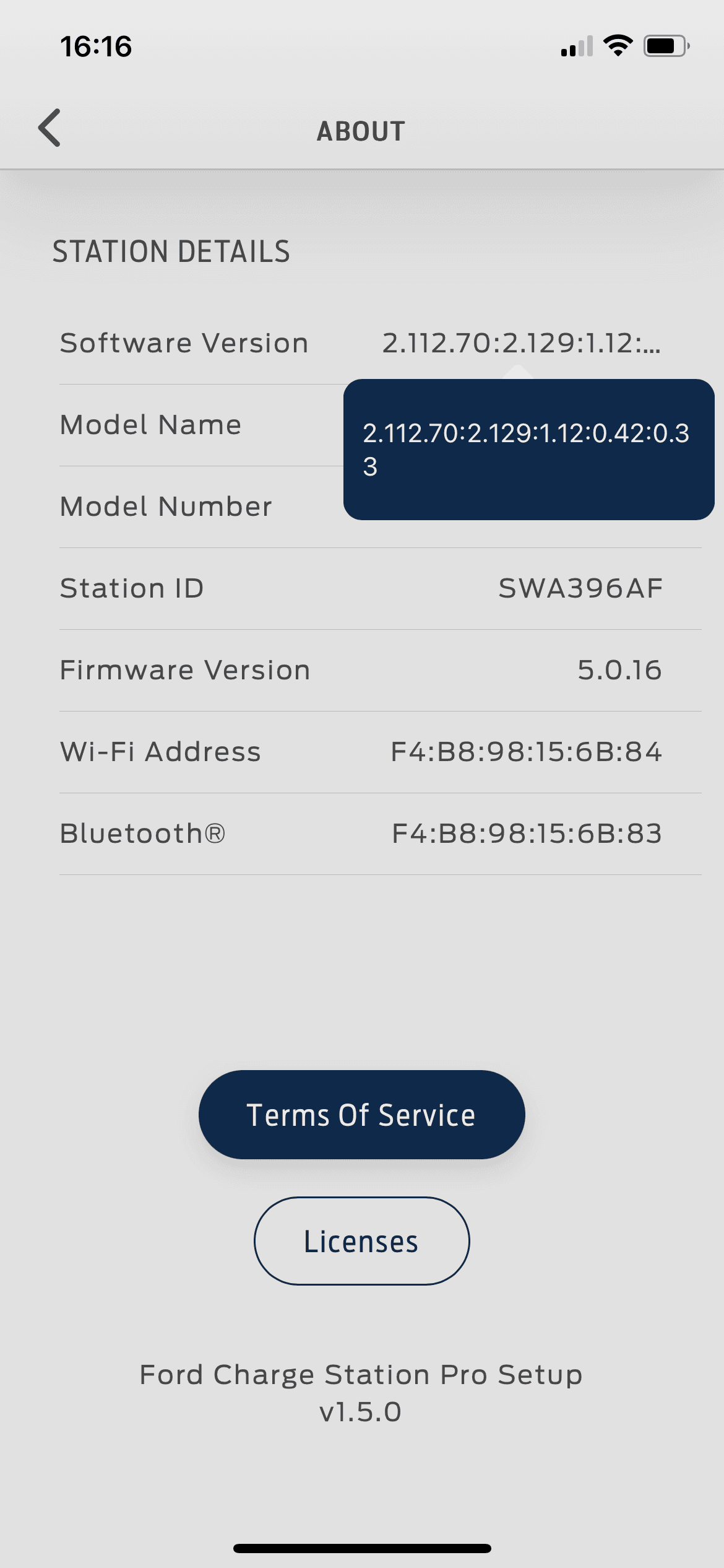

I also have this issue. I spent some time on the phone with Ford's support agent here in Canada today, and was told that this feature does not exist for the FCSP and they didn't have any information on if/when that feature might become available. What I do find strange is that from the FordPass app, I'm seeing a different software version that I see from the ChargeStationPro App. It's also telling me to update the FCSP, but there's no way to make that happen.
The FordPass app will match given time.
