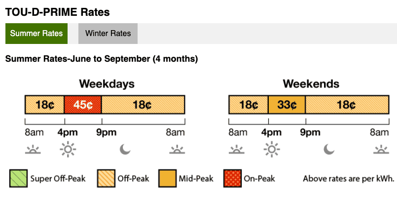

If you are home charging, look at your current electric bill. Take total kWh used and divide the bill by the kWh for $/kWh. Should be around $0.15 per kWh.
Assuming 120kWh battery, 300 mile range, 2.5 miles per kWh and figure out your kWh used a month times the per kWh cost.
In san Diego the cheapest electricity for the users that use the lowest their is .24$/KWhr. wha a rip off.

just like a gas vehicle, the vehicle itself is going to have it's own 'mpg', or in the case of EVs, 'mpk'(miles per kwh of charge) 'average' effeciency - but, neither of those are perfect, as just in the case of gas vehicles, WHERE you pay for fuel at any given time will effect your actual COST per mile, even though the vehicle's effeciency has not changed. We often use the term 'average cost per gallon' to try to attain some type of mpg overall operating cost figure, but it's not a perfect world, we are only 'guessing' at the number since we don't always really know what the per-gallon price will actually be at any given time, or trip.
We can certainly put pen-to-paper for our last 'trip' and use those numbers as a benchmark, but even then, is where we purchased fuel the same locations and price we would be able to buy on a regular basis, or is the driving style/type/speed/wind/weather/traffic/miles the SAME every time? NO. It's not a perfect equation.
With EVs, you have a similar problem, but you probably have more of a 'normal' rate at which you pay for that power, if we are talking about what you pay at your HOME, where the majority of your power to the vehicle happens. Having said that, some will have differeing rates at differing times of the day, or maybe even different seasons of the year. If you can use only your home's charging rate, per KWH, for your equation, it certainly will be easier and more effective that we've ever had with doing the same with gas vehicles. I would assume that electric rates don't change NEAR as often as gas station fuel prices.
As for EV 'mpk' while traveling away from the home's charger, that's a WHOLE different story. Like gas station pricing, and unless you have an app or account that tells you the KWH or Minute-of-use charges, so you can plan ahead of time, WHERE you plug in is going to make a big difference in the outcome of travel mpk cost. A GeorgiaPower ChargePoint or Walmart ElectrifyAmerica DC Fast charger might be 32cents per KWH, not including any extra fees or costs, which might equate to 3 or more times the cost to charge at home. Hopefully that's not a big part of the overall annual cost of charging, but it's certainly going to be a part of most an EV over it's lifetime.
If my GeorgiaPower utility cost is roughly 10cents per kilowatt hour, then I can certainly know what my overnight charging cost is, as an equation, for normal everyday usage, with an average of 50 miles per day - if I know the KWH of power that it takes to drive that distance(or to refill power for that distance), and considering the differences in weather/wind/traffic/speed, etc. on a daily basis. It might equate to $1.25, or it might be $1.52, for instance... but it's not an exact science, for sure.
