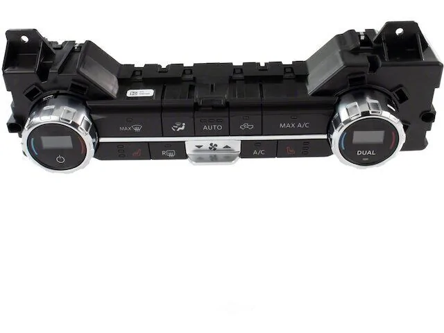

Has anyone attempted to swap the controls on a pro/xlt for the one with the lcd display on the knobs? Example below, they are available on ebay for around 150 new.

I was wondering the same thing. I don't see the heated steering wheel button on the one pictured, however.
My truck doesn't have a heated wheel. They have different ones listed for sale. Some with heated wheel and cooled seat buttons.

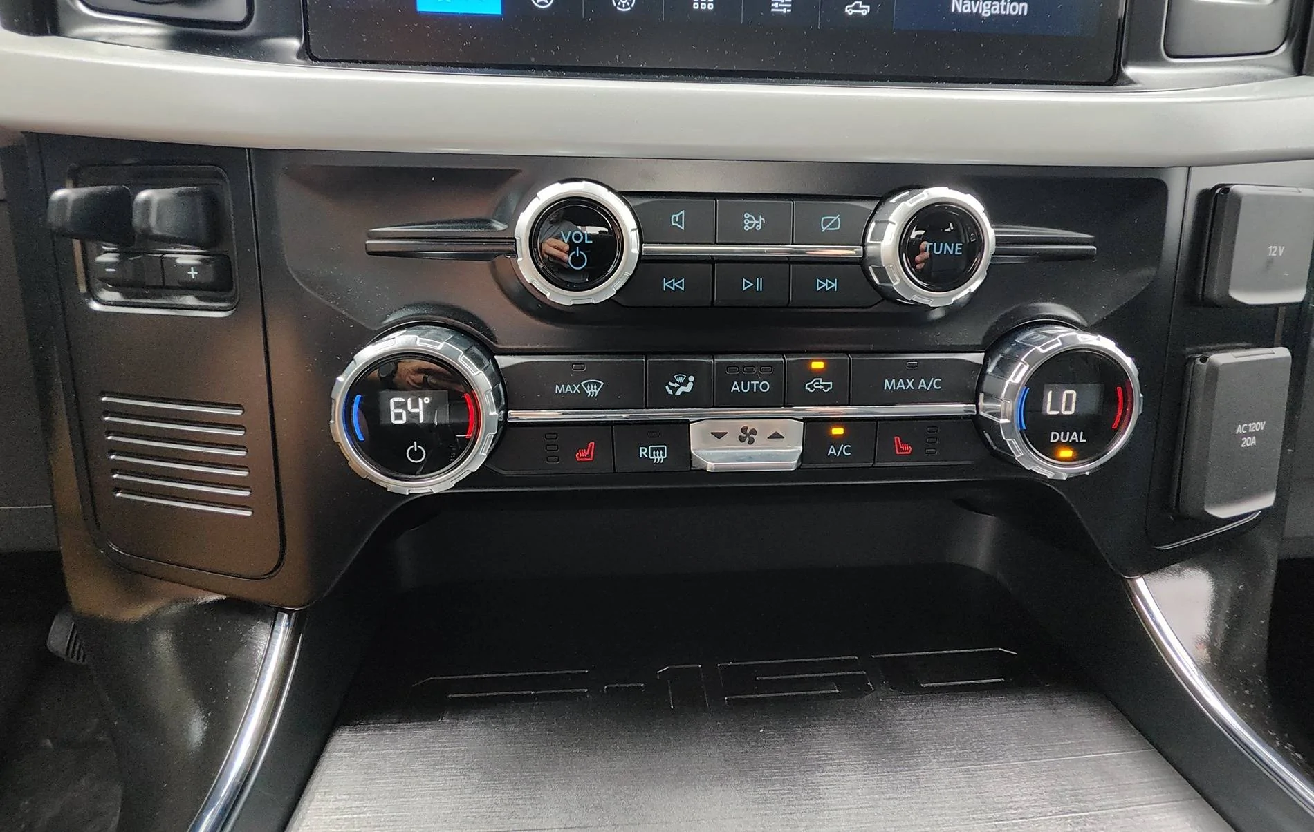

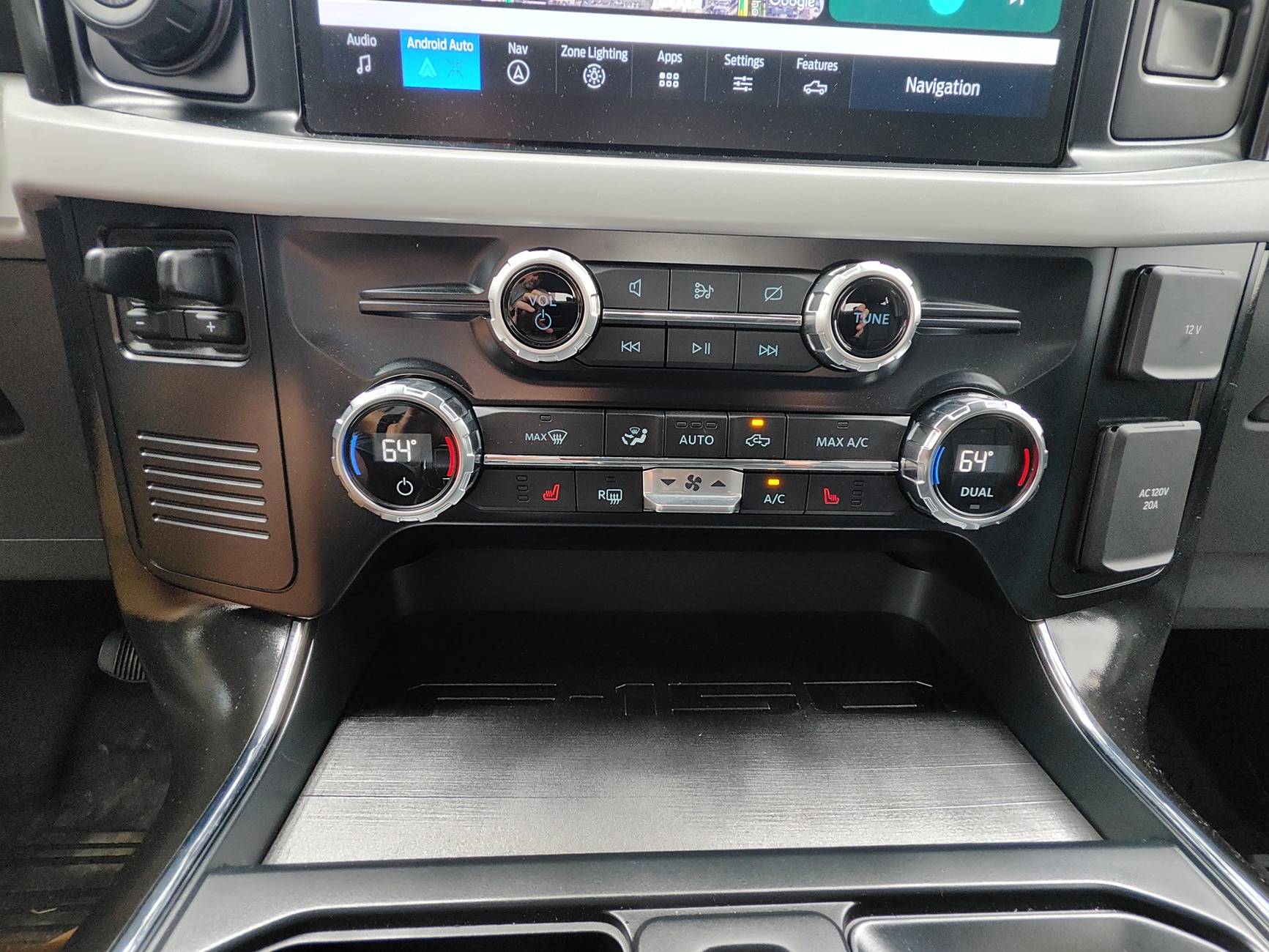

Update, I was able to swap a salvage ice unit with the digital displays for mine. It worked plug and play. The only difference is when I push the air direction button the pop up on the screen is different. No driver focus button or heat disable.
That seems like an improvement imo. I feel like the dual zone heater controls have never worked right. My wife likes the heat on and I usually have the AC blowing. But it feels like a lot of the time the heat is never really on when split that way. We have to fully turn up the heat on both sides for it to be noticeably on. Messing with the heat button and driver focus in the controls seemingly has no effect.

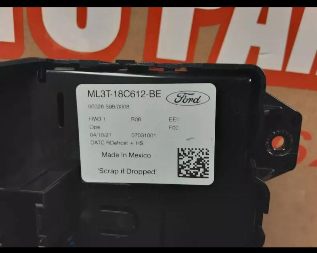

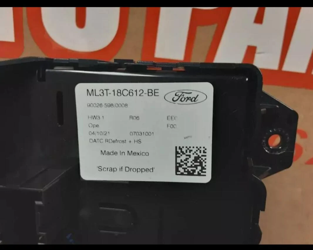

I wonder why it says Scrap if Dropped
Makes me wonder if the eBay ones were dropped at some point.
My guess is it's a notice for factory workers. It seems unlikely a scrapped part would make it's way out of the factory but who knows.
It’s a normal sticker found on electronic parts from Ford.

I would love to do this but losing the ability to turn off the heat is a problem for me. Being able to save some kWh using the seat heaters instead of the electric heat is something I like to do here in mild winters of southern VA.
