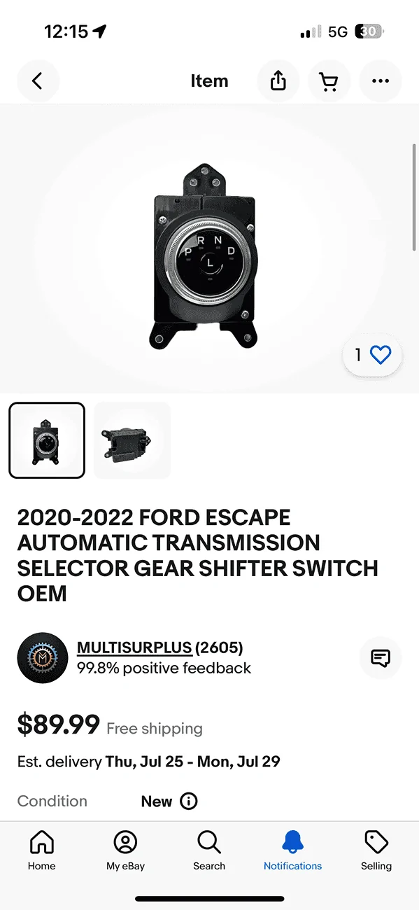

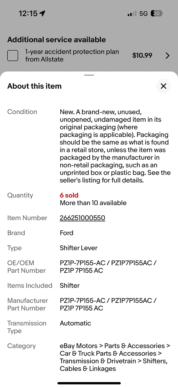

So the dial I got is from eBay it was $90 brand new. Comes from a ford escape. I’ve attached images of the listing with details.

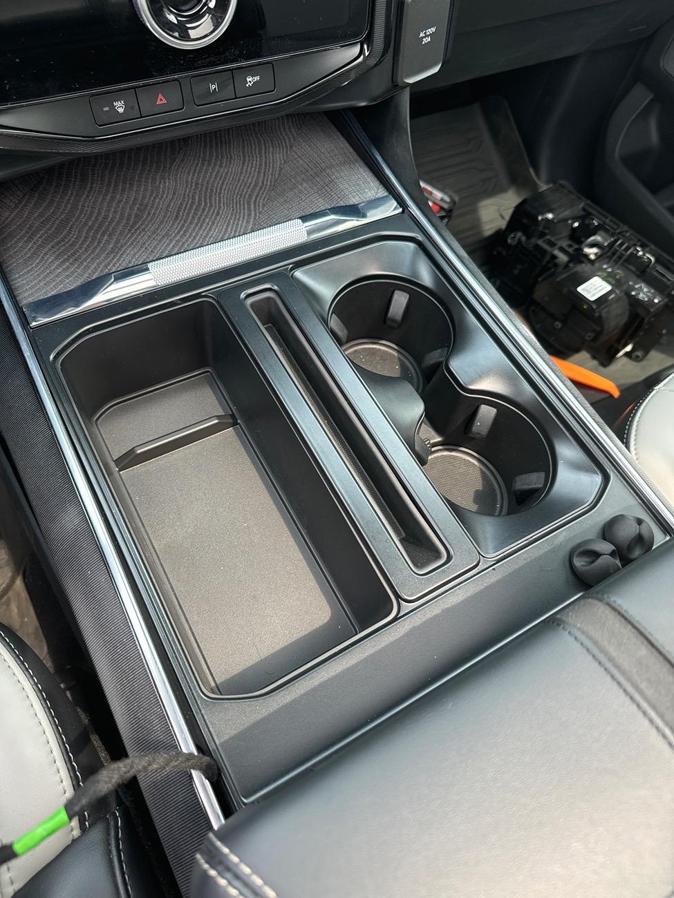

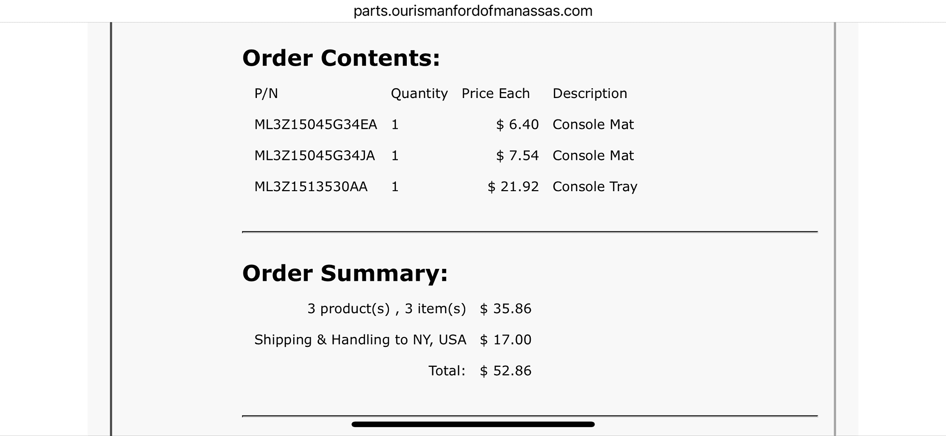

In place of the original shifter I put the OEM Cubby that fits a truck with the column shifter which cost around $50 with the rubber and plastic inserts. I’ve attached an image of those partnumbers for anyone who needs them.

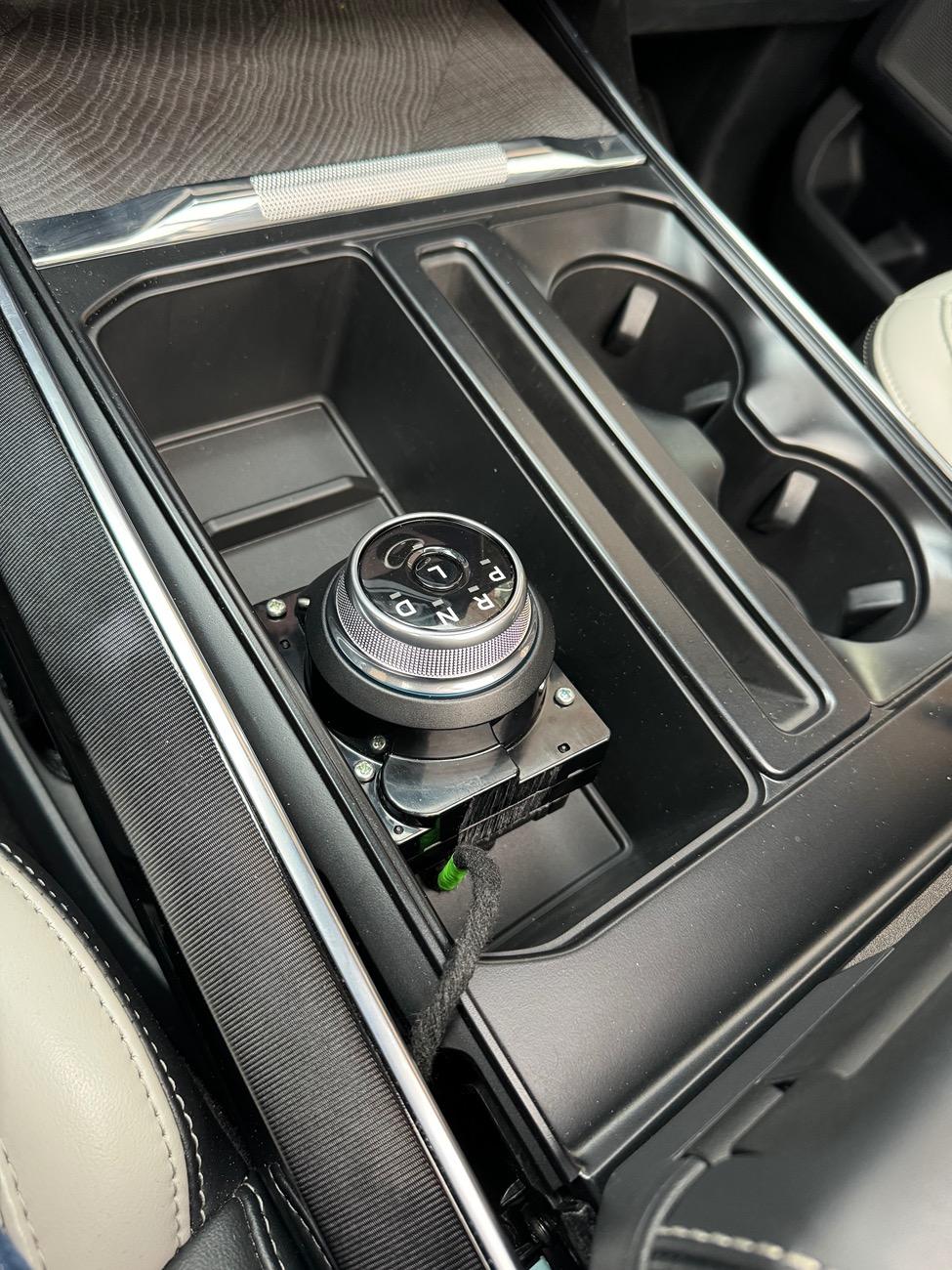

I posted a full write up in another thread here. I’ve had it sitting in the cubby for about a week now it’s been working great.
I'm curious... What happens when the truck wants to shift it back into park for you?
Say you're in D. You open the drivers door to look at something. The console shifter will grrrrrrrrr slowly back into P. What happens with the knob? Does it go N > R > P? Or right to P? Any codes?

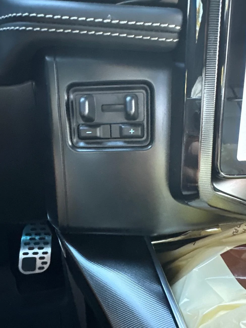

There’s a small space right under the trailer brake control that might fit a dial but I’m assuming it’s not going to be plug and play. How would the wiring work? Do you have any more info about the guy who used the mustang dial? Thanks in advance

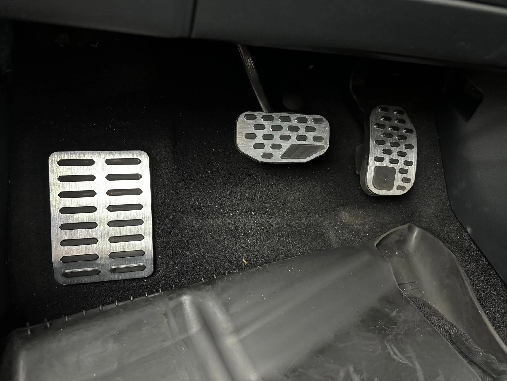

What pedals are you using?

Yep that’s the one. First thing I bought for the truck. Had the Putco ones on my last truck which were heavier and more solid but these are great too. They’re half the price also.
