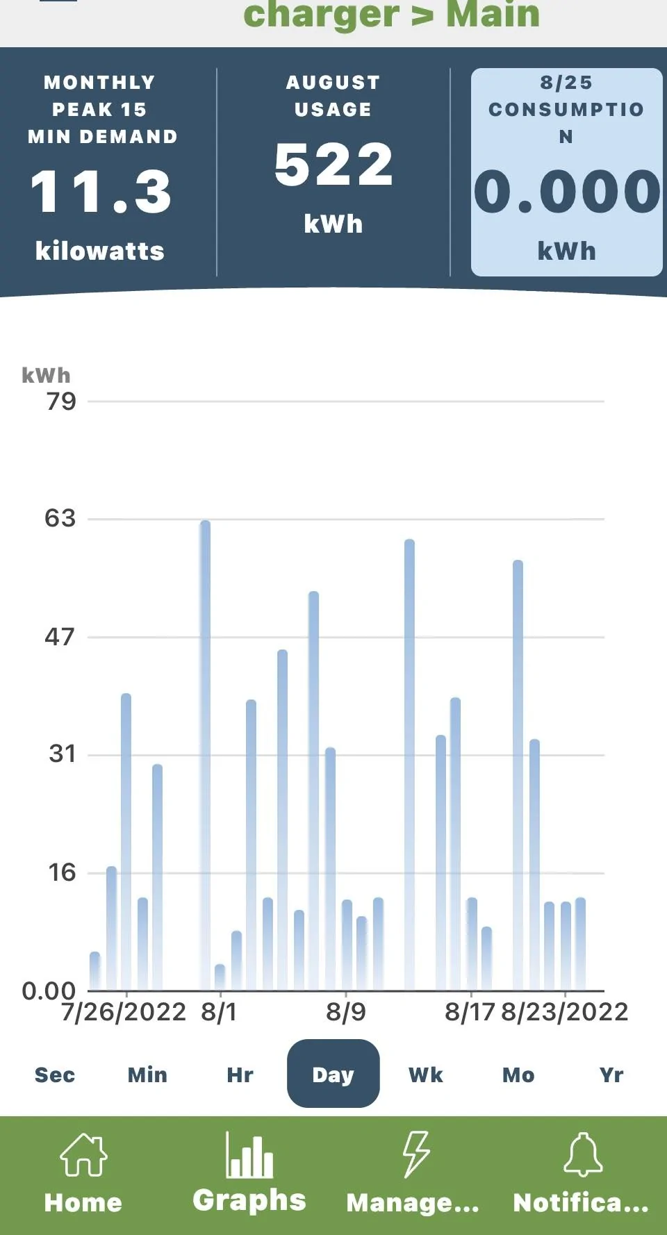

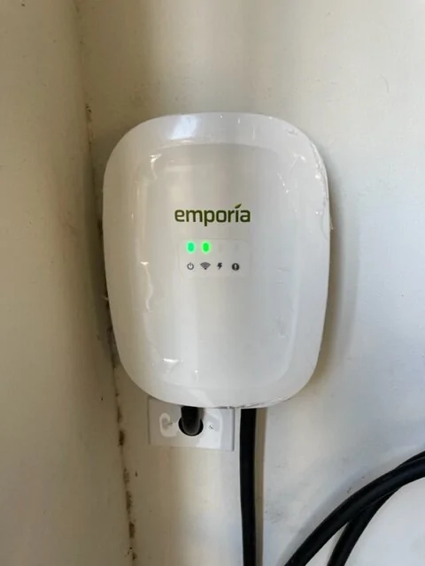

I have an SR Lariat and love my UL listed EVSE: Emporia 48A L2 charger - $450 charger + $300 electrician came out cheaper than buying a $800 48A or $1300 80A Ford EVSE.
The Emporia is shared between my wife's and my EV.
48A is way fast to charge and uses the maximum charge.
I can track how much kWh by the hour, day, week, month, etc...

Emporia hardwired to 60A breakers - full 48A and runs cool even in the hot summer garage...
