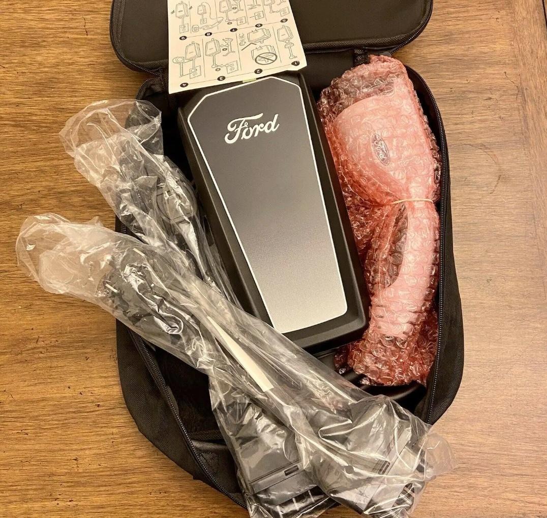

Anyone considering BUYING a Ford branded charger needs to carefully consider SUPPORT. The dealer will know bupkus about it. The Ford general support people will know bupkus. So WHO will provide the knowledgeable support?
Based on the current support for the included mobile charger, and the 48 amp Ford Connected Charge Station, that's a big consideration. People with Mach-Es aren't and Ford-branded charge stations aren't happy right now if they have issues.

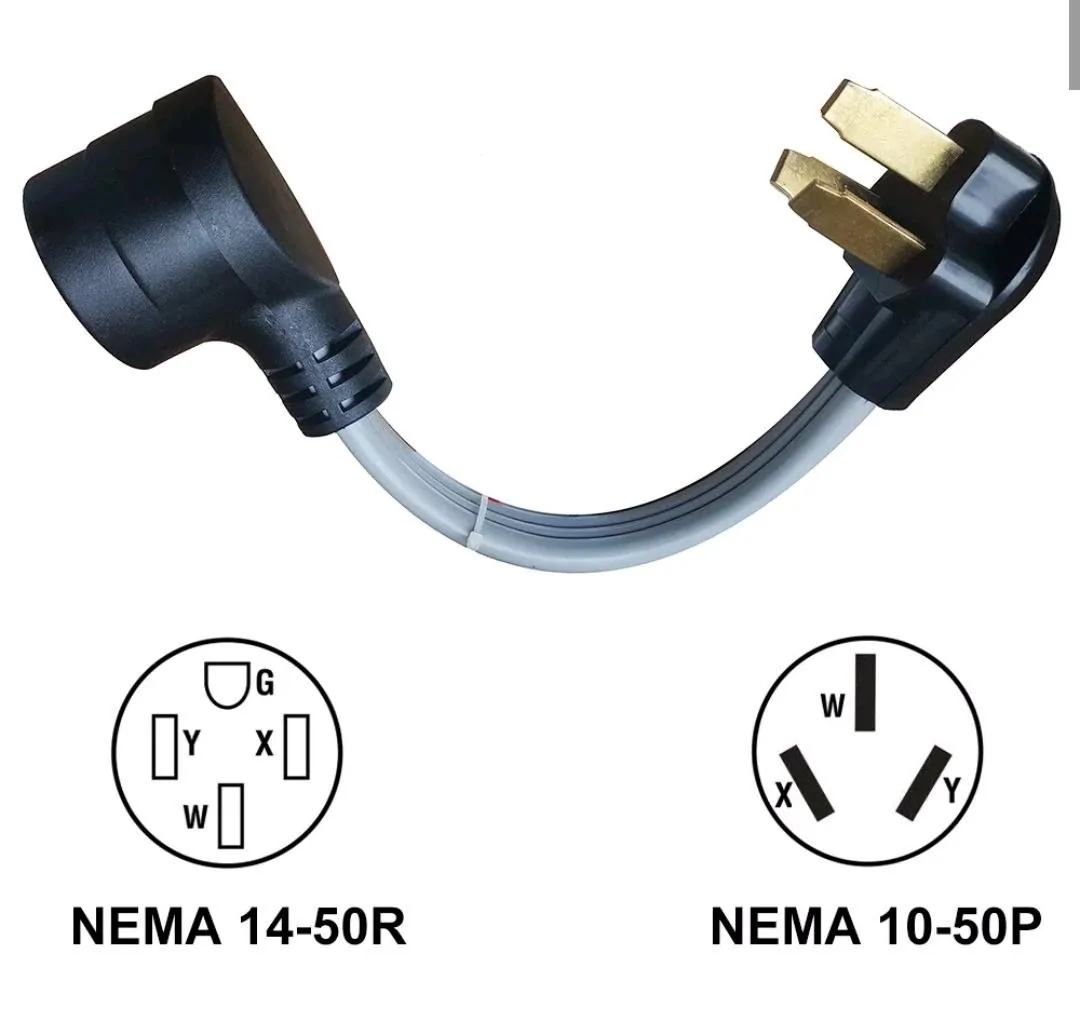

I use this adapter to the 240 charger on the Mach E. It'll pump 200 miles overnight. The house already had the dryer 240 outlet in the garage. It comes with a 110 plug and 240 you insert into the charger.

Is that included with the Ford charger or did you find it somewhere else? Does not having a ground on the NEMA 14-50R side cause a problem?
What size breaker? Needs to be 40 amps.

Just remember the Lightning battery is substantially bigger so you're not going to get the same 200 miles.
