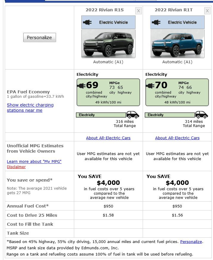

Does anyone know what MPGe for Lightning is? Rivian just published theirs. This is with road tires. You will have 5%-15% hit with other options. I will be happy if we get similar numbers. I don’t expect better. If we don’t have any numbers from Ford, what is your best guess of what we will get?

I am expecting similar for the Lightning. Larger frontal area offset by less ground clearance for aero drag.

While I would love to see numbers like those, I am expecting closer to 50MPGe. Hopefully I will be pleasantly surprised when the actual values are released.

I am expecting aero similar for the Lightning. Larger frontal area offset by less ground clearance for aero drag.
Rivian and f150 have very similar ground clearance while driving.
Rivian just has an option for more while off roading (and gets even lower when you park)
F150 will certainly get worse efficiency than rivian, but not much more ( both are big and inefficient, but that's a truck). The f150 shape isn't as aerodynamic (e.g., rivian has a spoiler for reduced drag). Plus it's slighty wider, and taller.
Rivian cab height is 72 inches, f150 is 78.
Rivian width is(with mirrors) is 87 inches. , f150 is 96.
Rivian official numbers for ride height for their standard drive mode is 9.7 inches, while f150 is 8.9. certainly rivian could tweak their ride height more if they found it safe as well. I have heard they have an aero drive mode at 9.4 but don't see official numbers.
F150 doesn't have enough tweaks to make it as efficient bad rivian.
