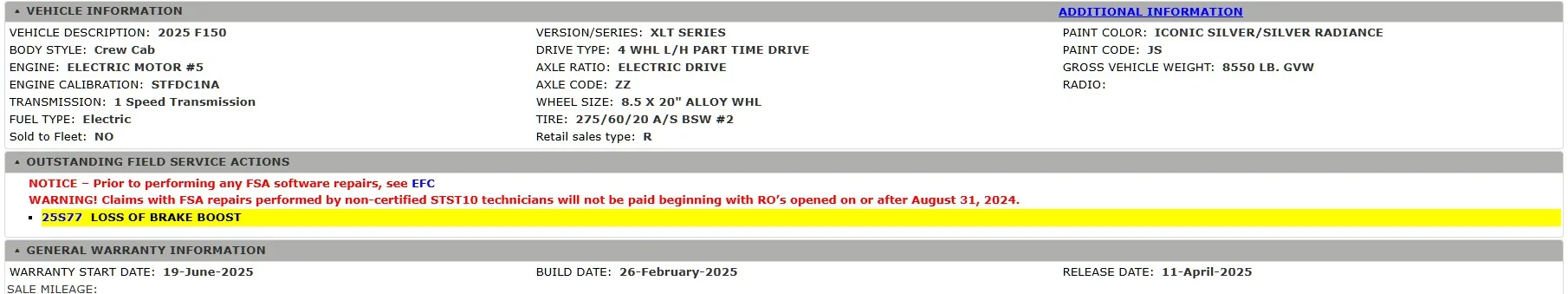

was looking confirmation that 2025 have been included in the steering TSB and this is what i found instead.
https://www.nhtsa.gov/recalls?vymm=1FT6W3L7XSWG04772
I just updated the abs module on my 25 Flash. I guess I need to call my dealer and tell them so they can run it thru and clear it from the system.
Funny thing is, it doesn't show up on Ford database as involved in any recalls.
VAL.ABAPO

Well now the recall is showing in Oasis. (PTS).
Ford F-150 Lightning Loss of brake boost -Issue Date 2025-08-13 Campaign 25S77/25V488 2025lightningbrakeboosterrecall
