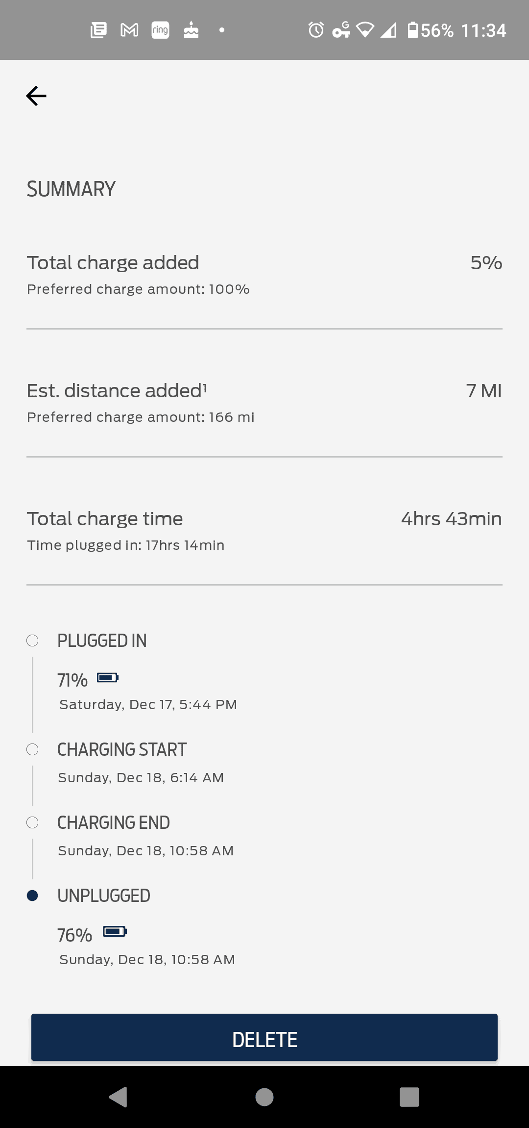

I wonder if a temperature a little under 50F can cause a halt in charging. I am using 120Vac with the Ford mobile charger and here is the charge log today:
Ford F-150 Lightning Mobile Power Cord Constantly Faulting Out Screenshot_20221218-113412
Note that I was plugged in for 17 hours, however charging does not start until 9pm (setup to avoid 4-9pm peak Time of Use rate, but still not enrolled by SCE). Charging ended at about 11am this morning, so should be about 14 hours of charging time. But only showing less than 5 hours of "total charge time". And way less than 2 miles/hr I normally get from previous charging logs. Maybe HV battery was trying to stay warm? Was the HVAC on in the truck--No, charging is now back to over 2mi/hr. Crazy, hope it does not re-occur. Hopefully will get 240Vac, 32A charging installed by January, 2023.
