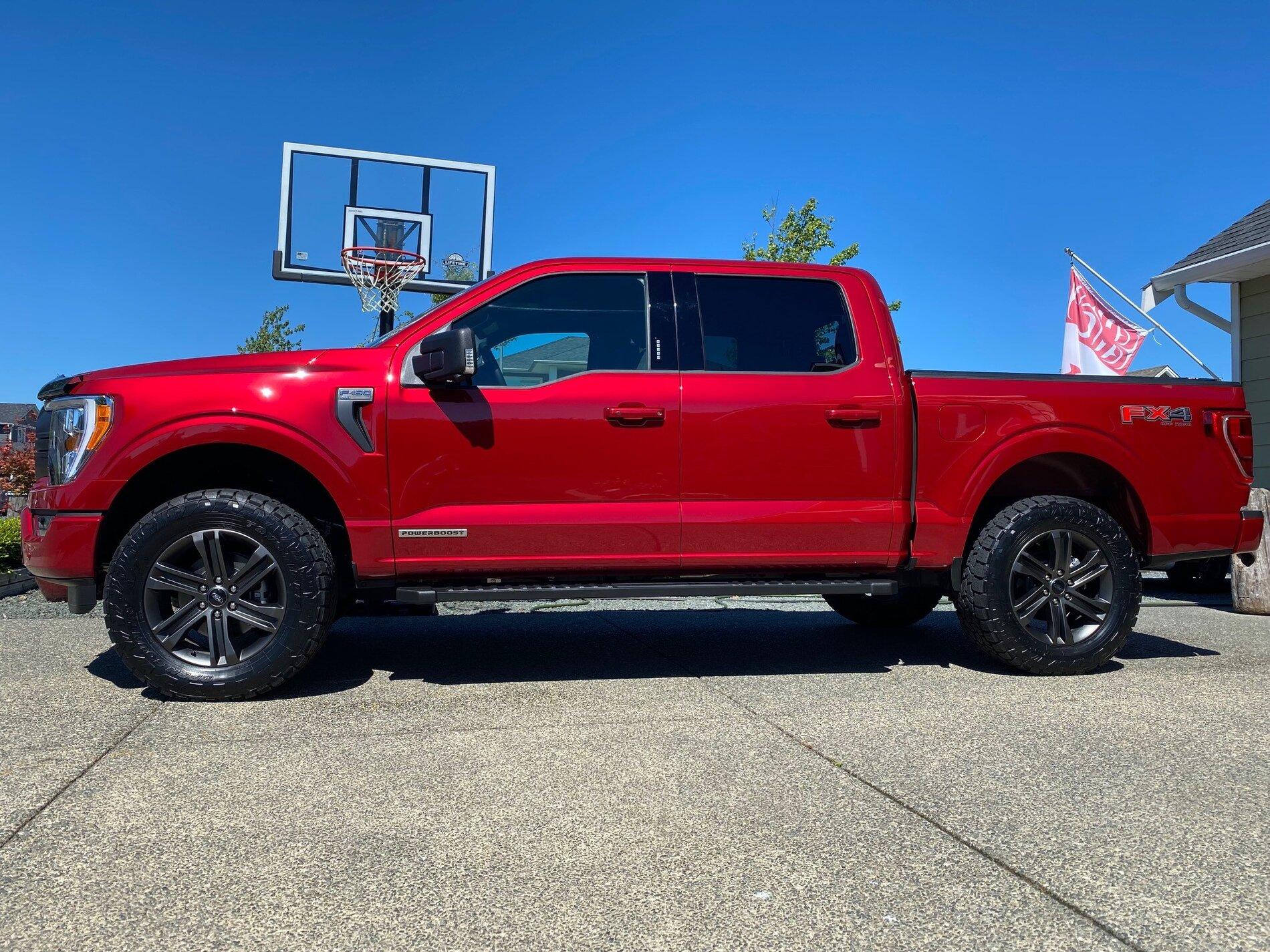

I upgrade my stock tires very time being in the forest industry and driving forestry roads. I need a good AT tire and 10ply to avoid flat tires from shot rock. I dumped the Stock Hankooks and went right into a 295/60R20 Toyo AT3 - 10ply with a 2" level kit for added clearance for waterbar crossings. I can say the ride is a little stiffer than stock but not by much.
I have stuck with Toyo AT's for the last 4 F150's trucks and they have been bullet proof off-road with no flat tires and good wearing overall. If you do any off-roading I would recommend to go at least to a 8 or 10ply AT of your choice to avoid sidewall punctures or flat tires.
