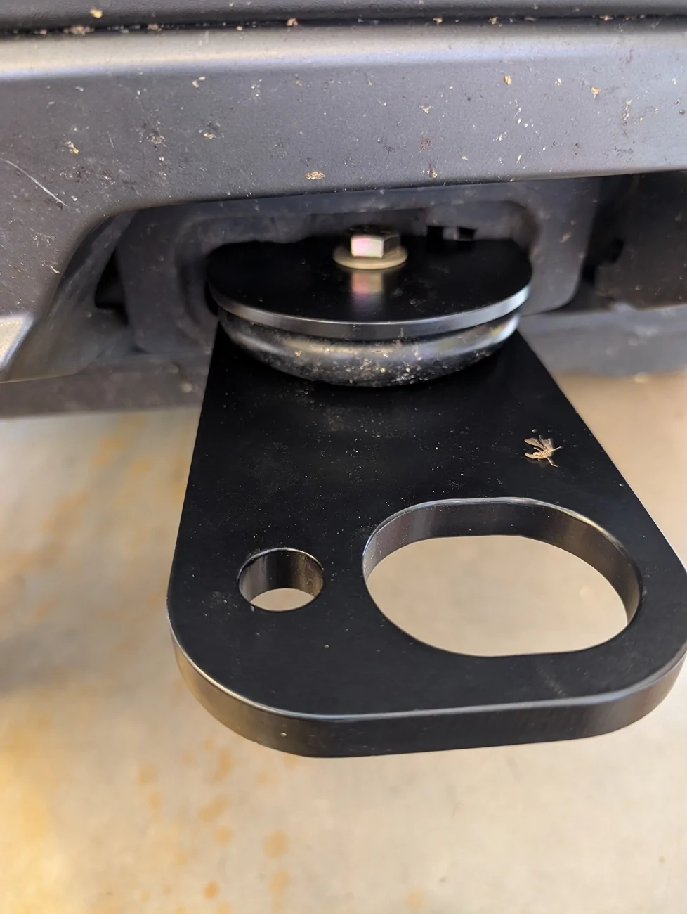

I also think the front tow loops are a good place to start.
FYI I have looked at the inside of my Lightning's front wall of the frunk, for an unrelated project. To me it looks that there's significant strength designed into the top half of that inner front wall... just an idea. Obviously, I'm not suggesting to cut into it from the outside, but it just might bear some weight as a brace, with careful design.
