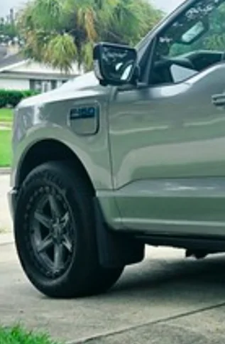

Well the rims are new, same 20" tires the truck came with. Never liked the stock wheels from day 1, didn't like them at all but knew I might take care of it.
Now it's taken care of. :bandit:

very nice!
I see those power retractable running boards - are they OEM or aftermarket? Minus the rear mudguards, you are running with similar set of ideas that I had for my truck mod experience. This confirms for me that clean look works and it looks amazing.
Could you provide some specifics like brand of the wheel and offset for your setup? if the running boards aren't oem, can you share which brand you've gone with?

Appreciate it, the boards are Wolfbox brand via Amazon. When I installed them, they didn't fold out flat like they should so I had to use some body shims to correct the issue with the mounting brackets. Left a review stating as much and thought that would be the end of it.
They gave me a full refund (that I didn't ask for) in lieu of photos of how I corrected the brackets. That was a few months ago, I don't know if they have remade those brackets at this time. They work great otherwise.
Didn't have that issue with the Amp Research power boards I put on my other truck. Here's a link to the exact wheels I bought. https://rimzoneonline.com/catalog/p...ack-bead-ring-20x9-20mm-6x135,6x139.7-(6x5.5)

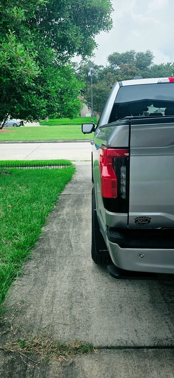

Thank you for your response. The AMP ones are nice but a bit too pricey so I'd settled on the rough country ones. I am waiting around for a crazy sale on them to crop up but I'll look into the Wolfbox boards.
I don't want to buy your exact wheels or anything but the 3/4 view of the front clip of your truck is more or less the look I had in my mind that was hoping to achieve.

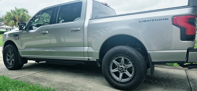

With the +20 offset and being a 9" wide rim makes them sit flush with the rear fender and with the taper off of the front of these trucks gives it that look. Stock offset is +45.
